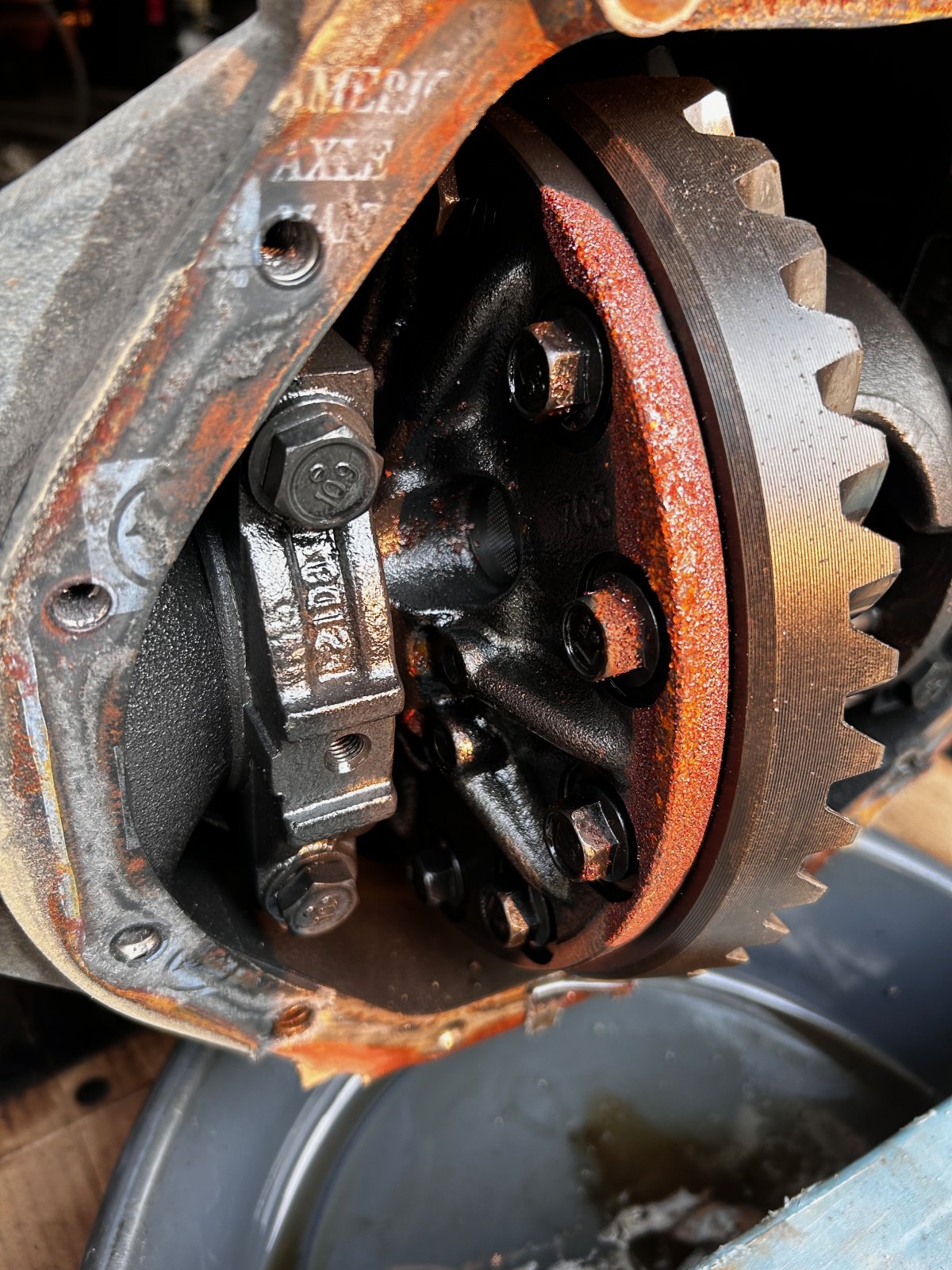

Picked up 2nd try axle today at Portland LKQ. This one much better regarding suspension attachments - all brackets are nice and straight. I was a little disappointed to see some surface rust on the diff flange where the ring gear mounts, but I will do some light cleaning with scotchbrite and then flush out with diff oil. Everything inside the diff looks OK and the axles looked good at the bearing surfaces. Pic makes it look worse than it is. I think this was sitting around in a yard for a few years.

That rust is curious. How could it possibly have rusted unless it was left exposed to the elements. And if that was the case, I’m worried about the bearings. Thoughts?
20,307
27,871
They ought to be thoroughly inspected. I would also rotate the pinion with the carrier removed to check for binding from any corrosion it may or may not have.
Mine got rained on after we put the new yoke in the 2nd time and got the crush washer in and rotational torque to where it's supposed to be. We drained out the rainwater and poured 2 quarts of gear oil into the case and let it sit for a few days. All seems well.
