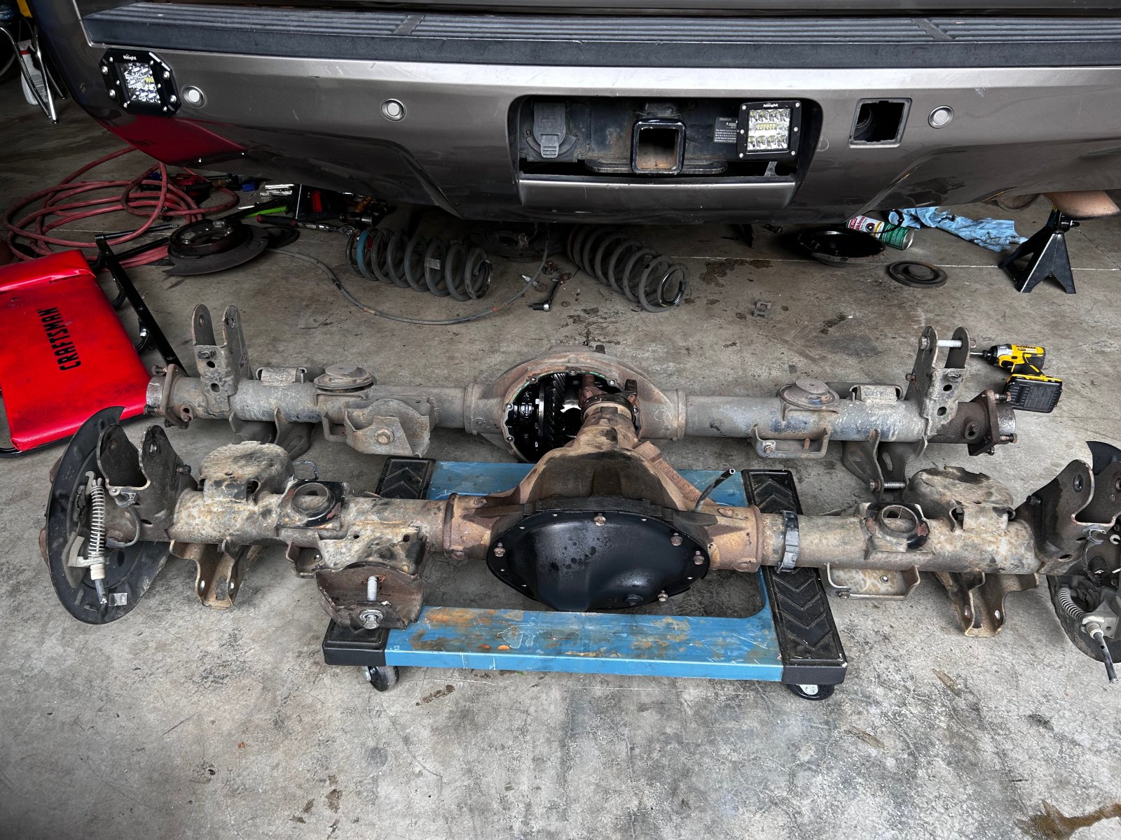

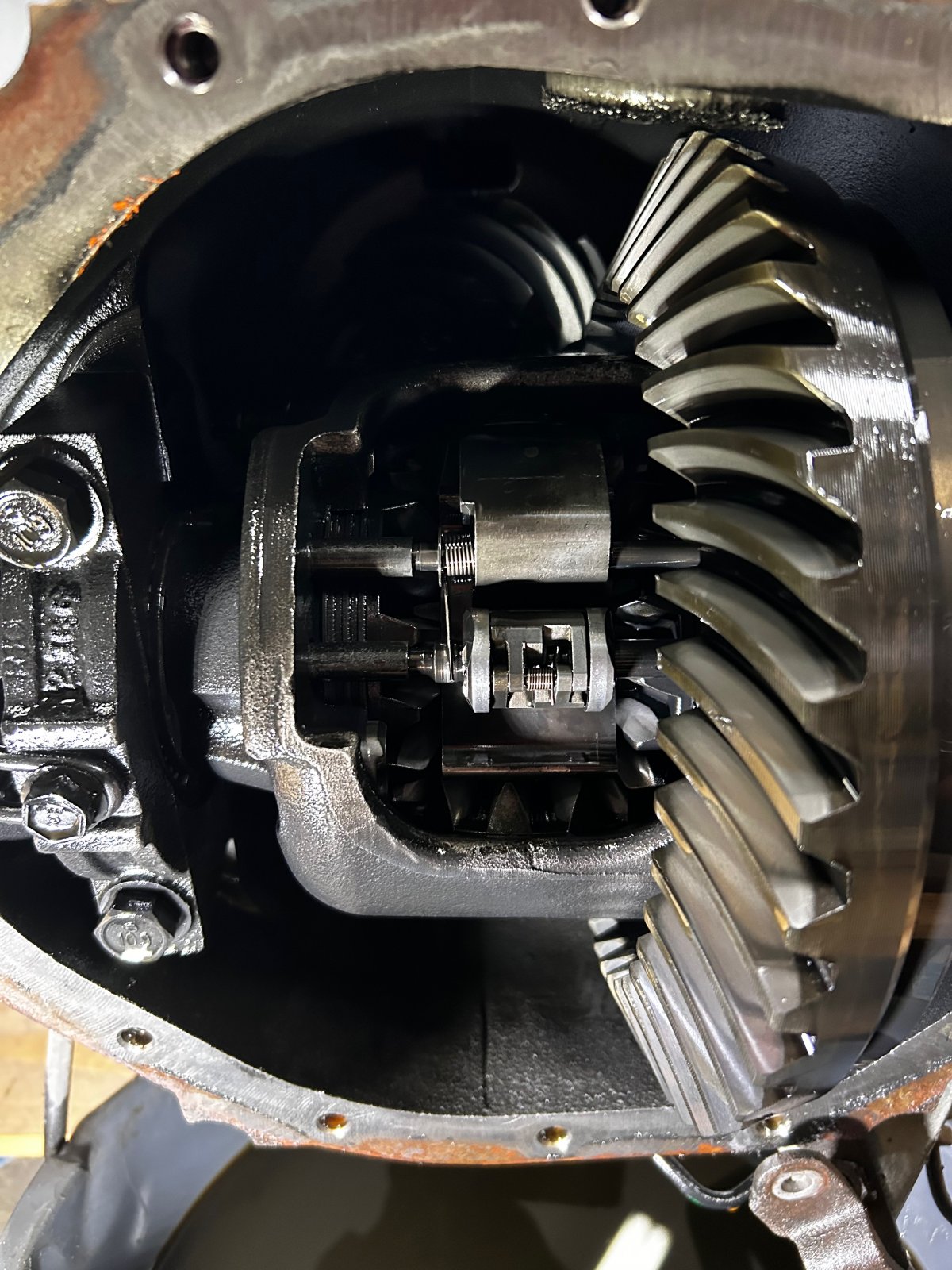

Starting a thread for my gear change. This week I purchased a GU6 14-bolt, Gov-lock rear end from LKQ. Came from an '09 Yukon. I've taken the cover off and removed the axles so far. Everything looks pretty good. No silver in the oil (although it was pretty black) and the parking brake components on both ends look brand new. So do the axle seals. The only downside is the brake backing plates are toast. Dinged up and bent good where it was on the ground. I think I should be able to use those from my 8.5. I already have the conversion u-joint I will need. Should be able to install in the truck in the next few weeks. Hopefully.
At the same time, I also purchased a 3.42 front axle from a different donor/location, but still LKQ. They have since canceled that order and I'm getting a refund, apparently it didn't pass their inspection. There were others available for the same price, so it should be pretty straightforward to order another one.

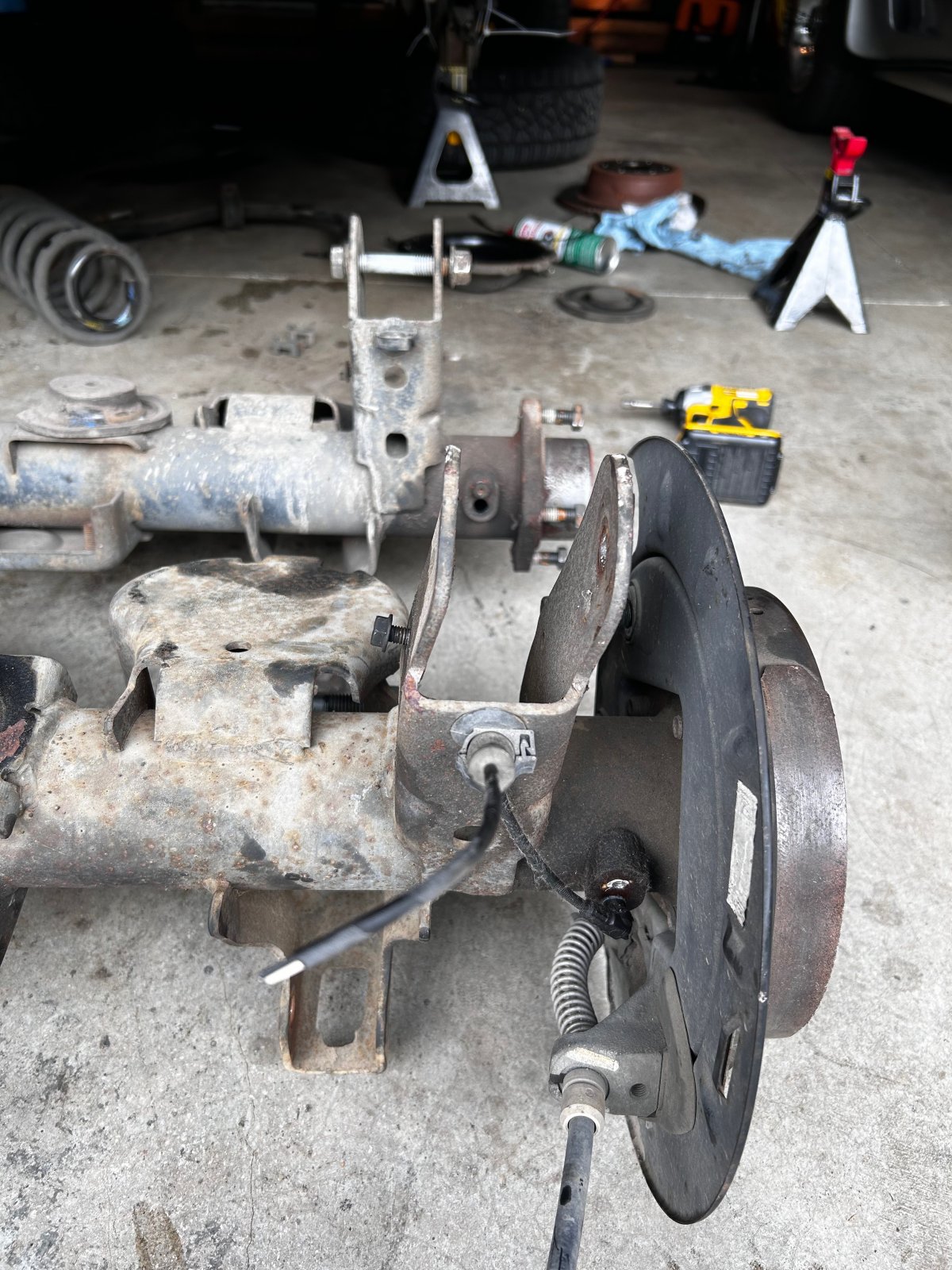

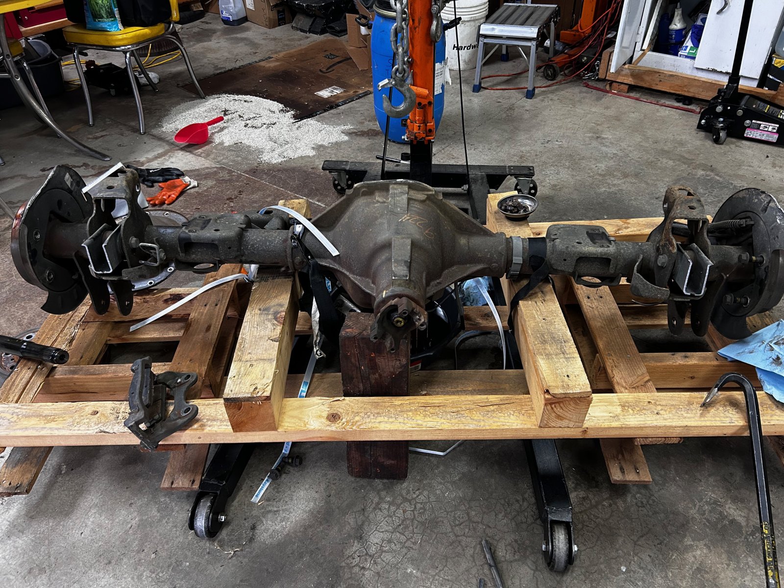

I got the old rear end out today, but I had a significant set back I think I'm going to have to return the rear axle and get a different one. The PS trailing arm mounting bracket is badly bent. Also the stabilizer bar (not sure on official name - it mounts on frame on PS) mount is tweaked as well. Not sure if it fell off the fork lift or what. I don't think I will attempt to straighten the brackets. Probably best to return and exchange.

I got the old rear end out today, but I had a significant set back I think I'm going to have to return the rear axle and get a different one. The PS trailing arm mounting bracket is badly bent. Also the stabilizer bar (not sure on official name - it mounts on frame on PS) mount is tweaked as well. Not sure if it fell off the fork lift or what. I don't think I will attempt to straighten the brackets. Probably best to return and exchange. View attachment 433849
Those guys in the salvage yards do more harm than good all too often! The upper bracket can probably be fixed with a 2x4 and a mallet, and a mallet for the track bar bracket. Use your old track bar if the donor is tweaked.
Thanks for the encouragement to make some "adjustments," James. I did use a long 2x4 to try and lever the upper bracket back into place, along with several well-placed blows with a 2lb machinist hammer. It's better now, but I think it's still going to be challenging to get the upper arm/strut in there. But there is some give on the other end, so maybe it will slide in. That strut is still bolted to the frame, but I may take it off and do some test fitting before I do the install. I also think I may be able to straighten the track bar bracket enough to get it installed too. I didn't get any intact suspension components with the LKQ axle - they were cut with a sawzall close to the brackets. I'll have to reuse everything from my rig.
So am I correct in assuming that as long as I can get these rear suspension components installed in their brackets, without having to tweak them, I'm good to go? Since it's a straight axle, it doesn't seem like there's anything that can cause alignment or handling issues. They're just there to keep the axle in place and prevent lateral and fore/aft movement? This is my first vehicle with live axle but coil sprung rear end, so I'm learning as I go. My '76 Vette with trailing arm independent rear definitely has some adjustments required out back, but that's quite a bit different.
I reckon that as long as the brackets are straight, the control arms will fit inside them and it will track straight down the road. @iamdub @Doubeleive @gooffeyguy @randeez
What does everyone else think about those brackets and getting them straight?

the welded on bracket metal is maleable so as long as you can get it straight it should be fine, will take a little work with a variety of instruments. since it is on the driveline I would use a square to be sure it is straight.

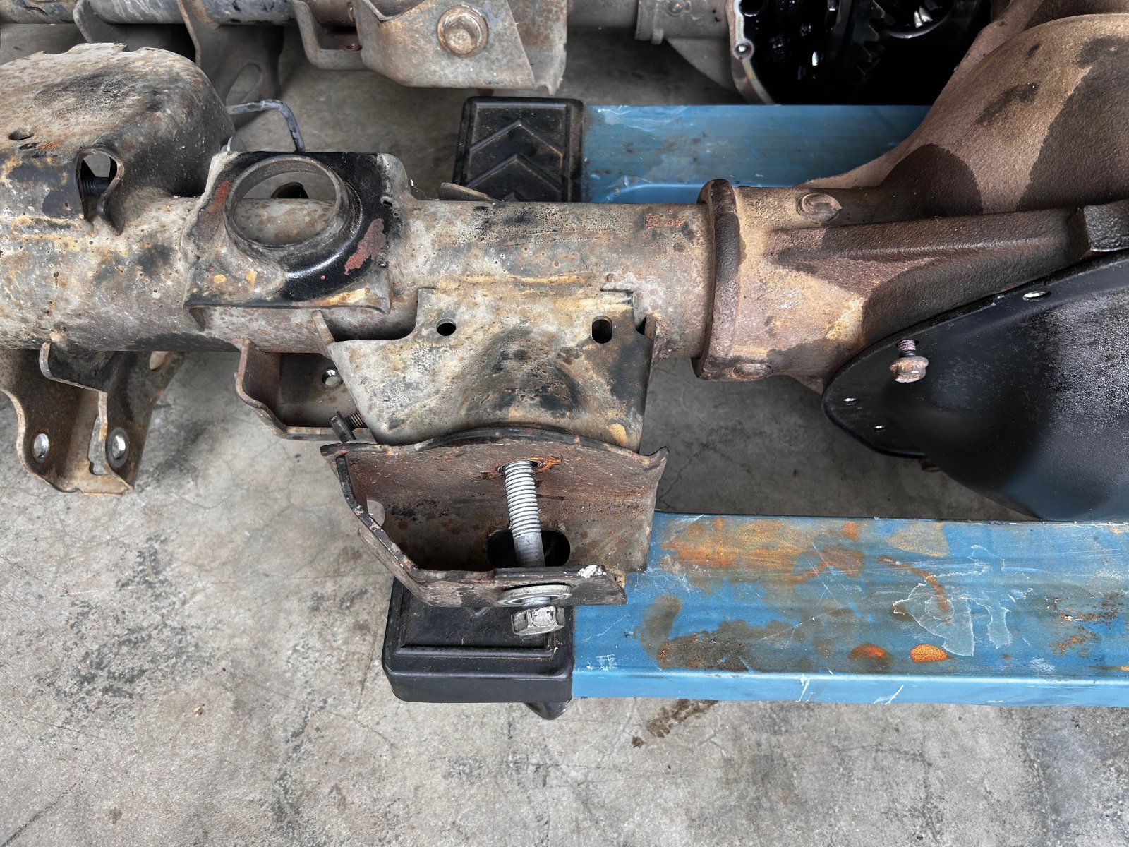

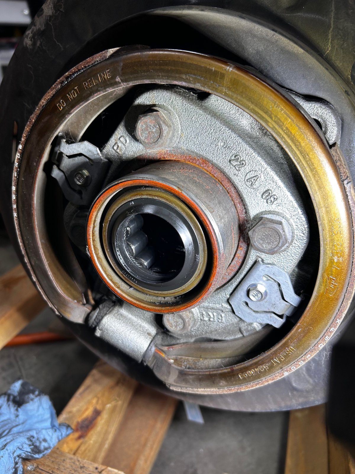

Thanks for the info. I found more damage tonight - the flange that the brake backing plate/parking brake mounts to is bent on one corner. That seals the deal, I'm going to start my return/exchange with LKQ tomorrow and hope my second attempt is more successful. I'll do a lot more close inspection before I accept the next one.

When you get the replacement axle, inspect the cast parking brake anchor blocks too. I had them broken on my donor axles from being dragged around the scrap yard and had a tough time finding a replacement.

Also, personally I would straighten out those dust shields and roll with them, they don't look that bad to me? Pretty sure mine were close to that when I got my 14bolt? Or at least were after rolling it off jackstand onto my foot.....in Crocs

Regarding the dinged up dust shields, kind of immaterial now, but I'm cheating and just using my OEM ones - I haven't even detached the parking brake cables from them. Amazing that you can get the whole rear out without breaking any brake lines or disconnecting p-brake cables. And same with brakes... no bleeding required, the entire brake line assembly is fully intact and zip tied to the frame. No connections broken and my existing lines look to be in great shape.

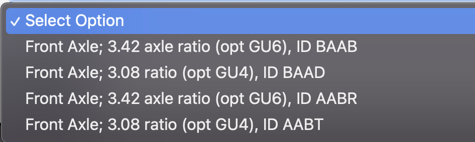

On the front, you may be answering a question I have. Here are the four options available when I search LKQ:
The front that I just took out has a sticker identifying it as a AABT. So I'm making an assumption that I want the AABR 3.42 option, since the code is so similar to the one I'm replacing. But I'm not 100% sure on that. If anyone has any clarifications, please chime in.
Thanks again, appreciate the support on the swap and hearing from another person that went through it. And thanks for further confirmation on the u-joint issue!
