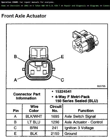

All you'd need to do is kill the power circuit by switching the B+ or the ground. I'm pretty sure that my actuator ground comes from the body mount under the driver's door hinge, up the firewall, then down to the actuator.
Diagram for your connector at the diff actuator:
So if you did that while in 4hi, you'd actually be in 2hi (RWD).
Not sure what codes or messages you'd get, though. Body grounds from upfitter guide attached.
So if you did that while in 4Hi, you'd actually be in 2Hi (RWD).
