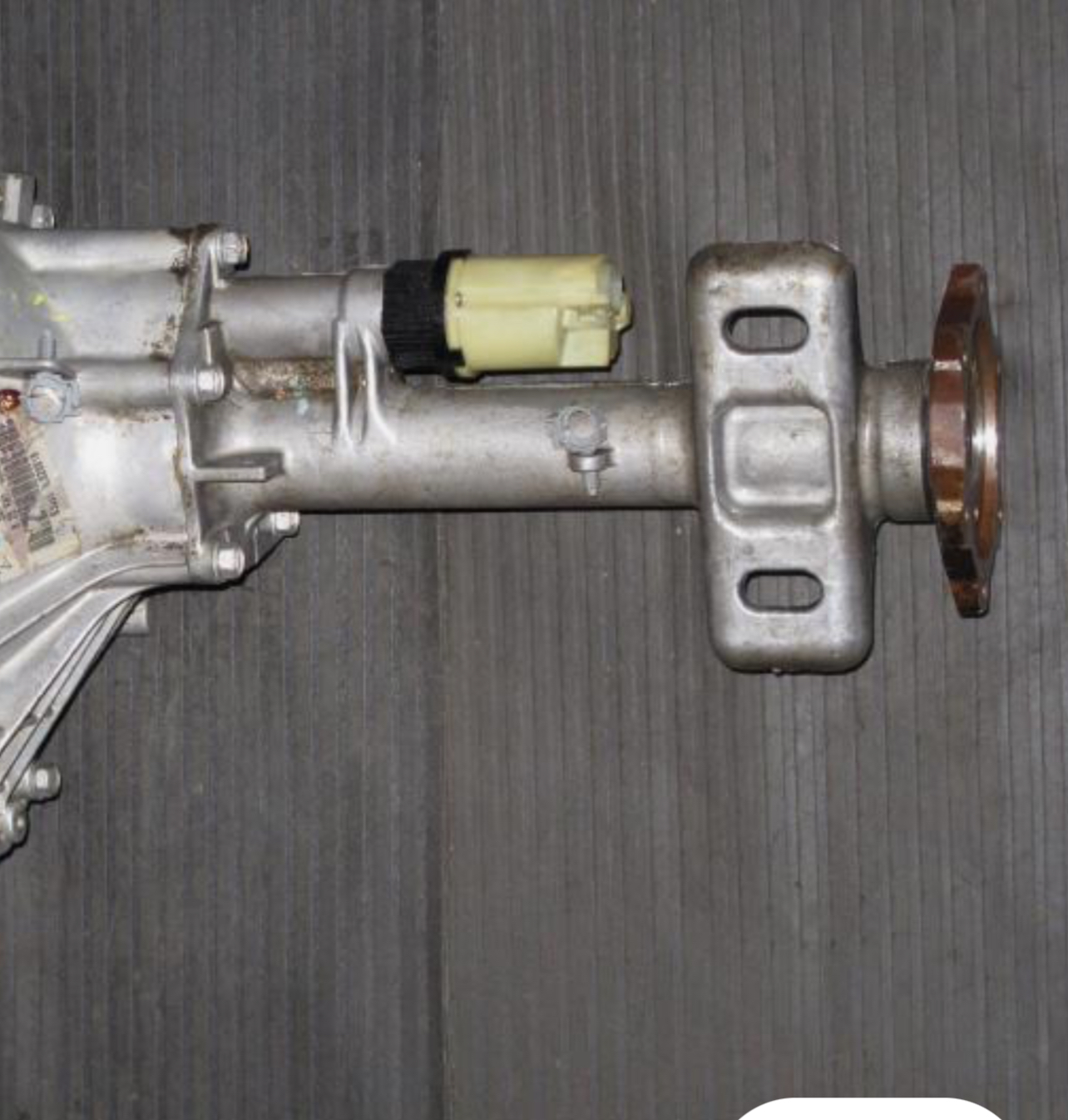

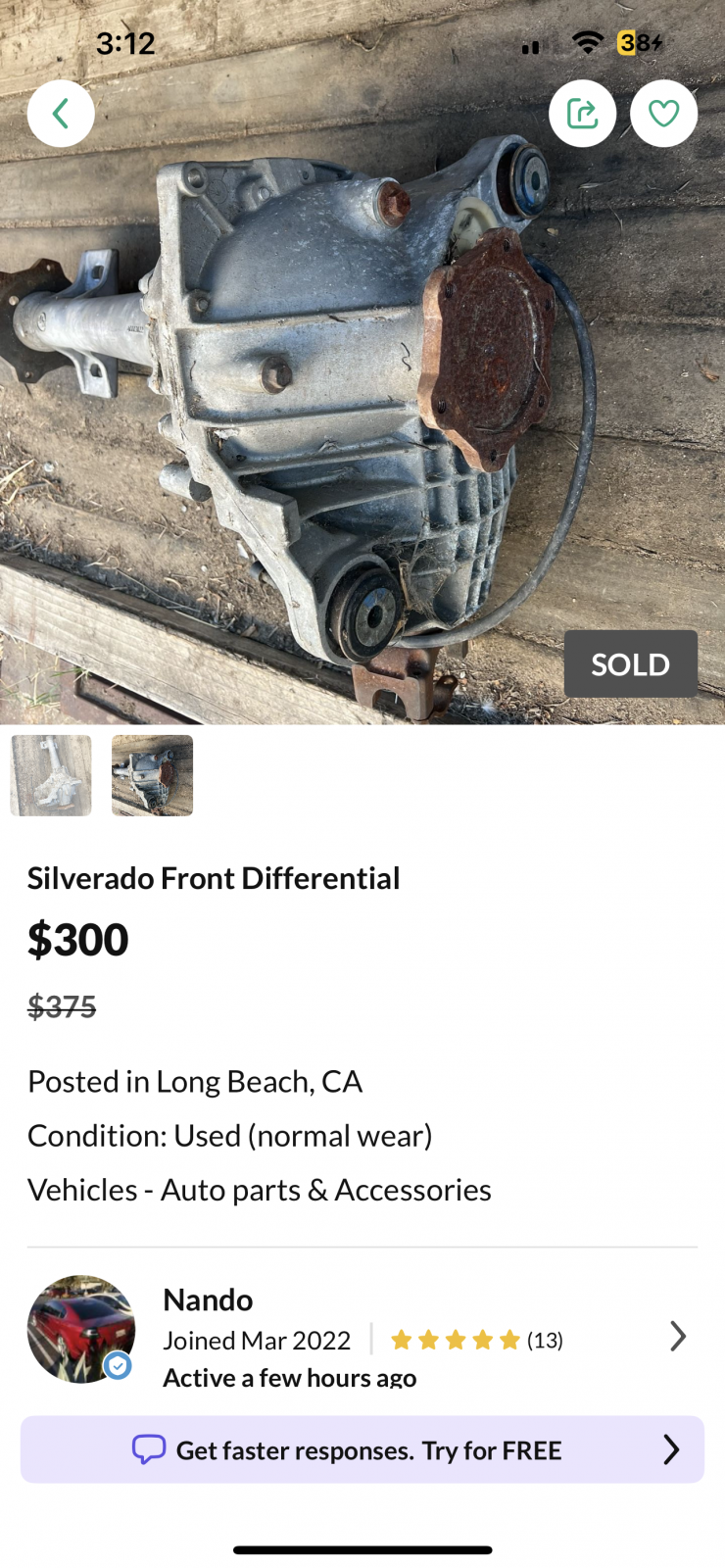

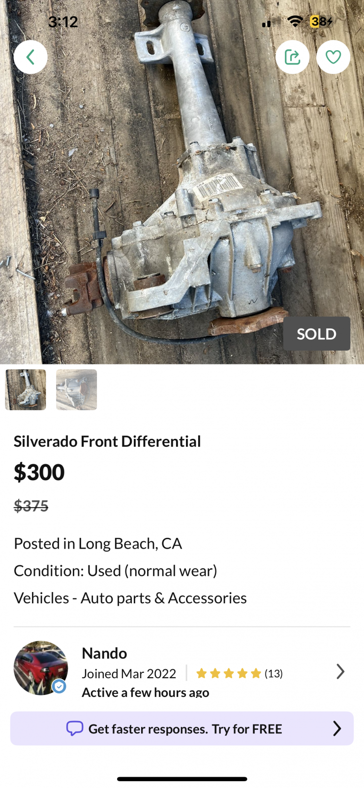

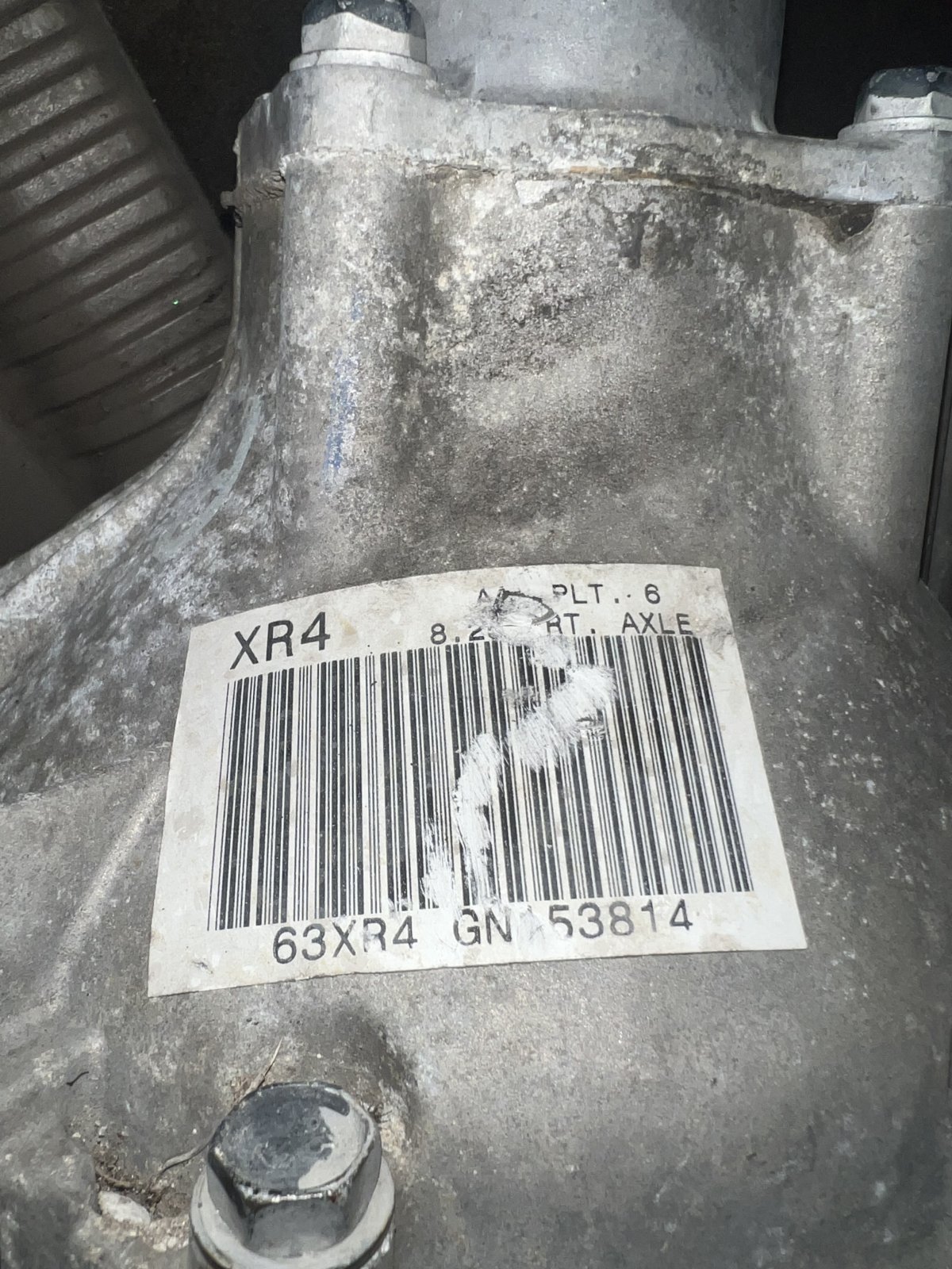

I purchased a Denali transfer case with 3.73 gears but did not realize it doesnt have plug in for the selector switch. Is it possible to swap out some parts from my stock front diff to the denalis to make it work??
My stock rear end blew and i swapped it out last year with a junk yard part. My truck was gu6 front and back with 3.42 gears. It now has 3.73 open diff in the rear. After sourcing a front diff on offer up (cheaping out) with 3.73 i failed to realize it wasn't compatible in terms of plug and play.
Any suggestion will help? Can i rebuild it or am i better off re-selling it and getting the front diff i actually need GT4 rpo.

I'm not 100% sure but you should be able to just swap your actuator over to the AWD diff. If there is a place for it in the shell/casing

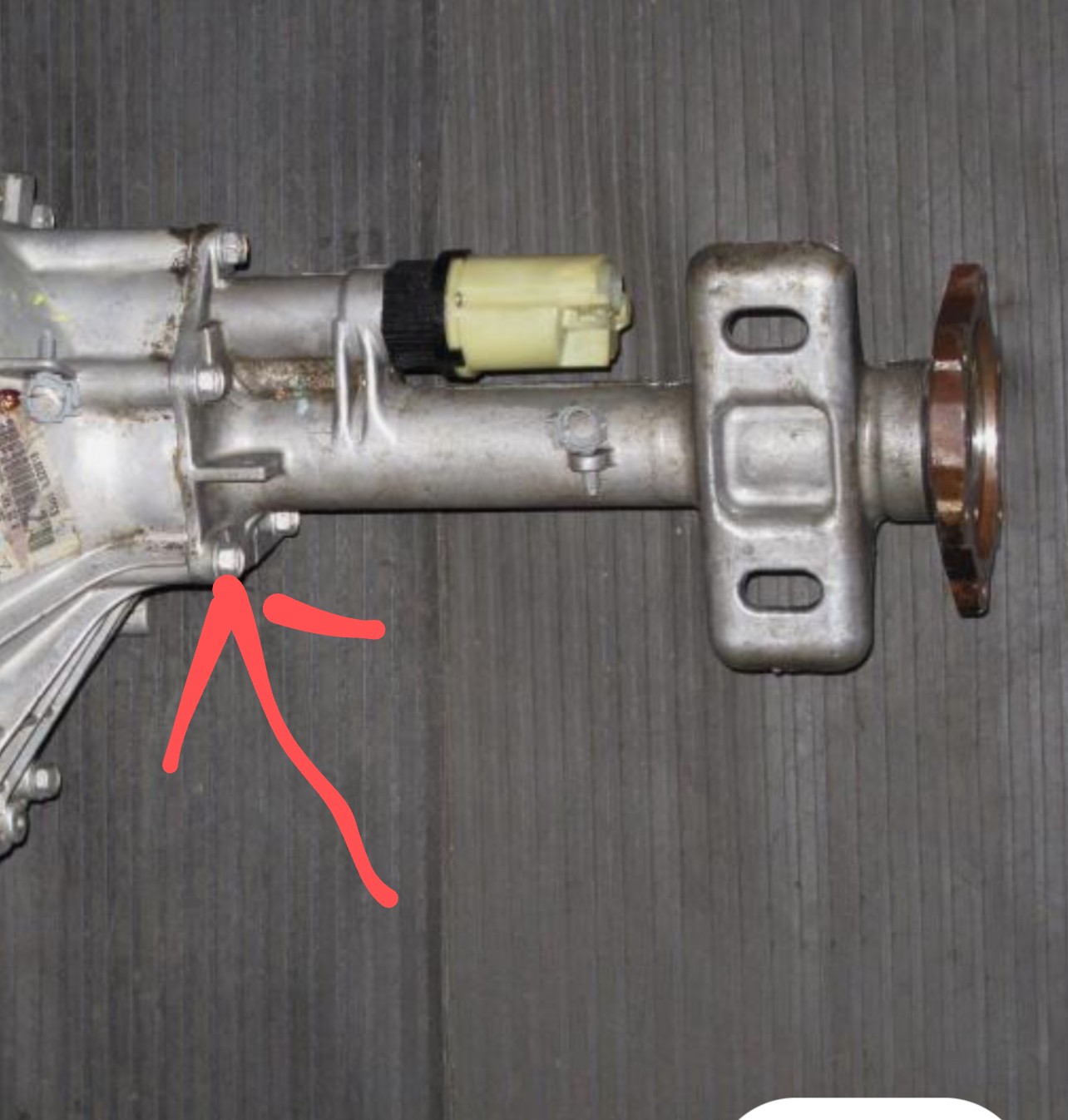

Thanks for responding!
The axle tube housing is the only exterior difference that i can see.

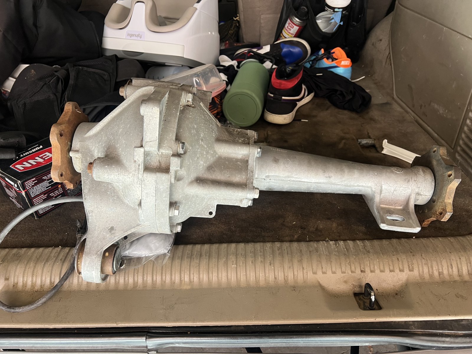

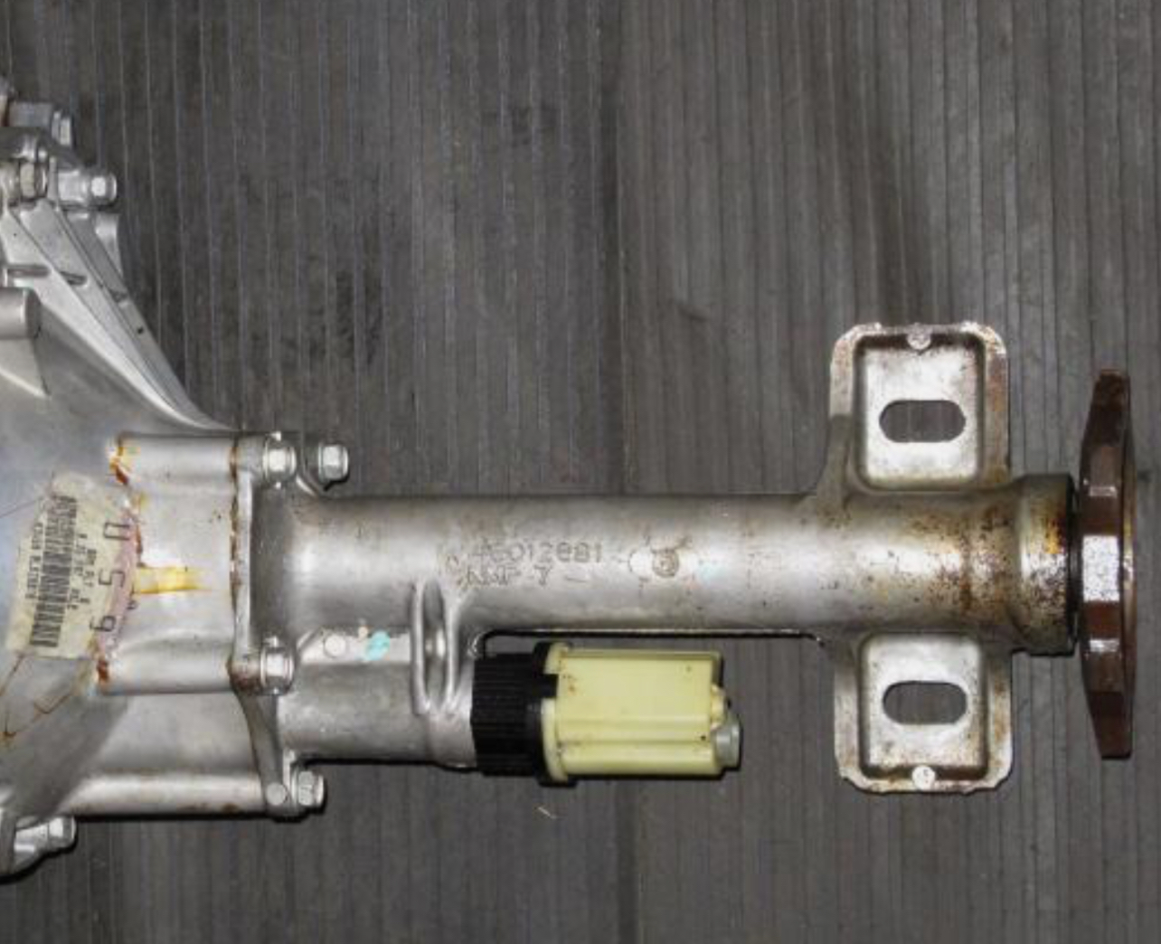

I guess my next question would be if i could swap the tube housing/actuator on to the awd diff and if so would it still function the same way as stock with 2hi, 4hi and 4 low? Or will i need to modify the internals of the awd diff?
The photos below are of a 4x4 front diff and the awd diff

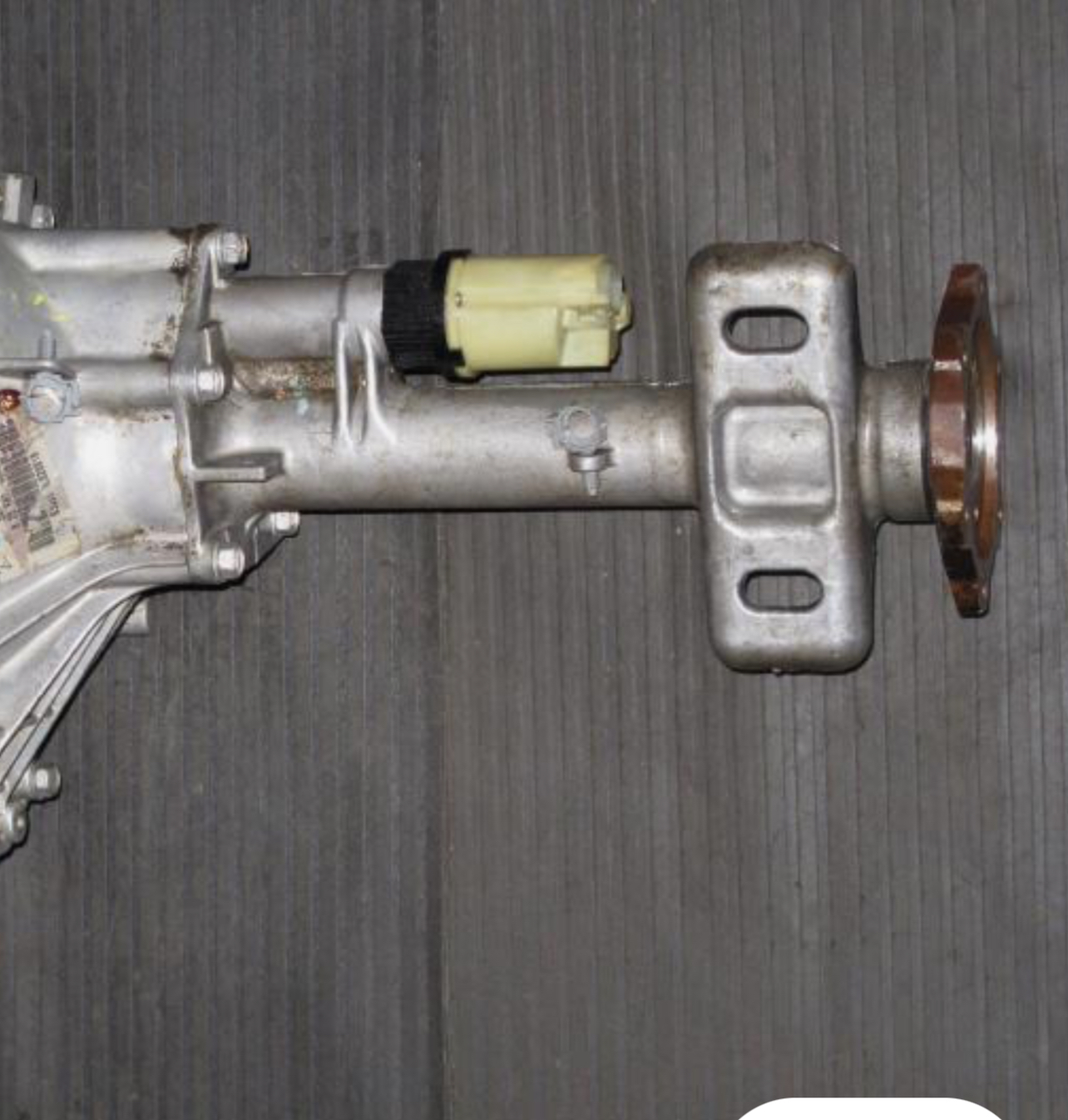

Pretty sure you can just swap it on there, the 4wd hi/lo drive part is handled by the transfer case, no worries on that portion

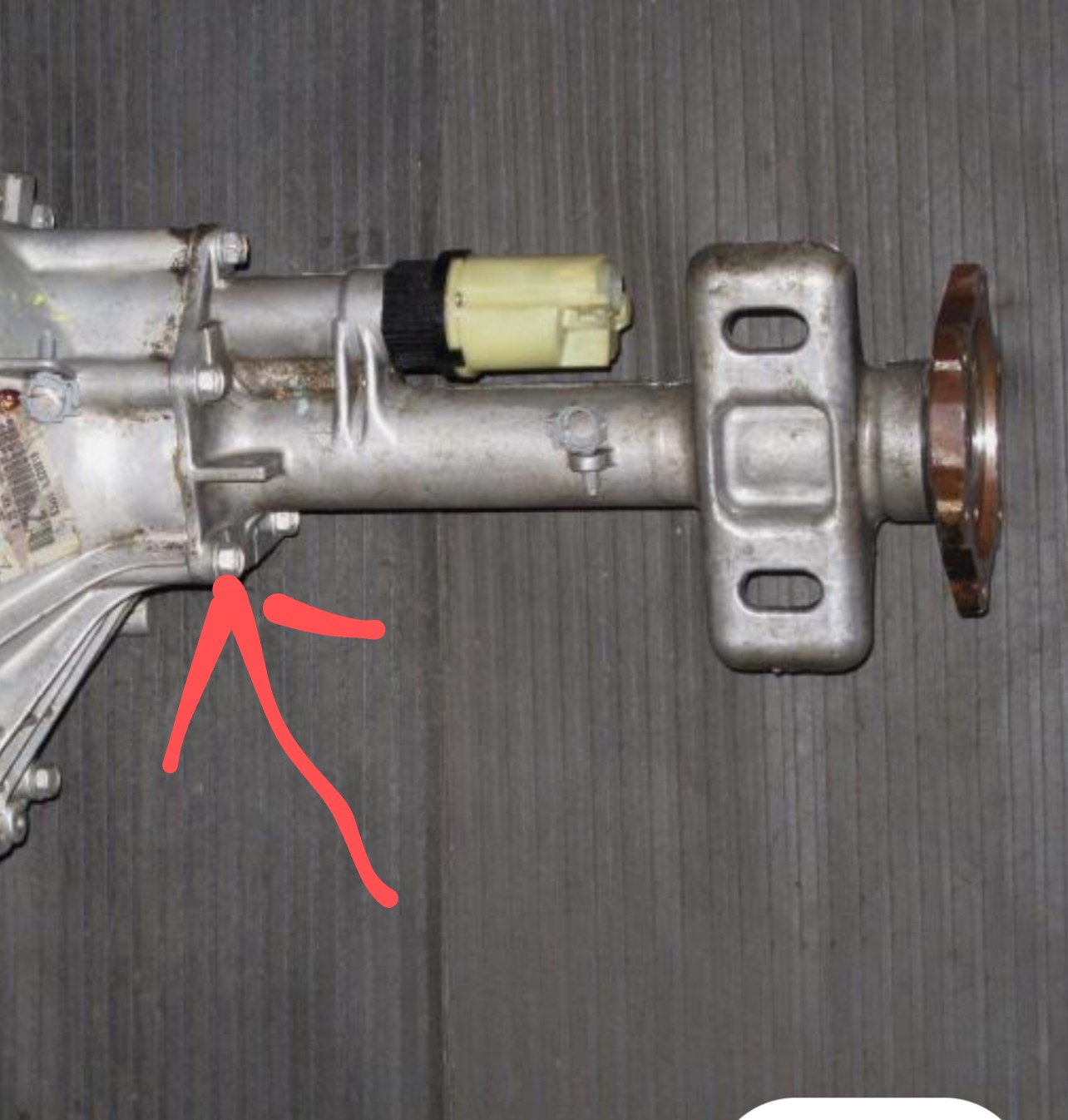

The only difference between the AWD and 4WD front Diff (In the same generation) is the axle housing(Passenger side), electric shift motor and the shift fork assembly. You can swap your 4WD components over to the AWD unit. Its fairly straightforward.
