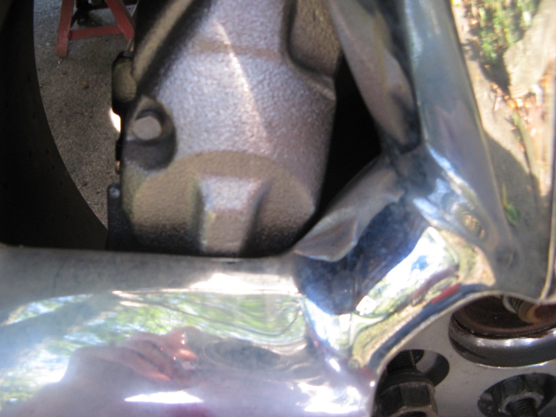

Well stock 5 spoke 20” rims do not clear. They hit the caliper on the hub part of the rim. The back of the spokes might hit if the hub part didn’t hit first. Pictures below.
