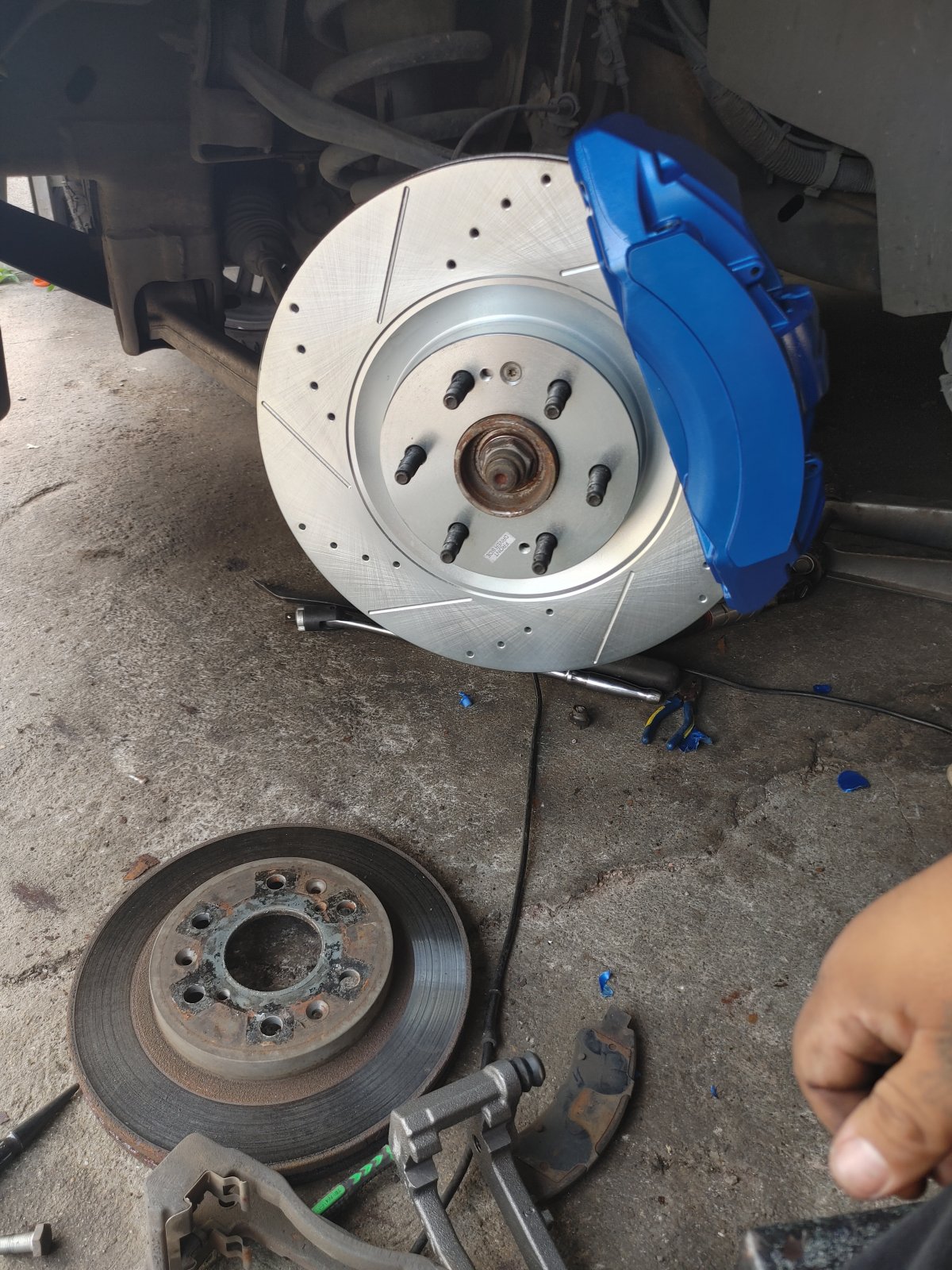

Hey y'all, I'm about to get my big brake upgrade going once I buy some new wheels. I don't want to run 2 in spacers for my current wheels to fit. Anyway, Does anyone know of any rear brake upgrade that would involve maybe a four piston caliper or a two piston side by side caliper setup?
FYI, Everything bolted on without any issues. I'm even able to use the stock bolts from the caliper bracket. The only problem I have is that my wheels won't clear the calipers and I want to get a new set so I don't have to run wheel spacers. The picture is just a mock-up. You can see the old rotor on the floor. Unfortunately, I couldn't finish the install because of the wheel fitment issues. I guess the only bright side, I'm going wheel shopping tomorrow LOL

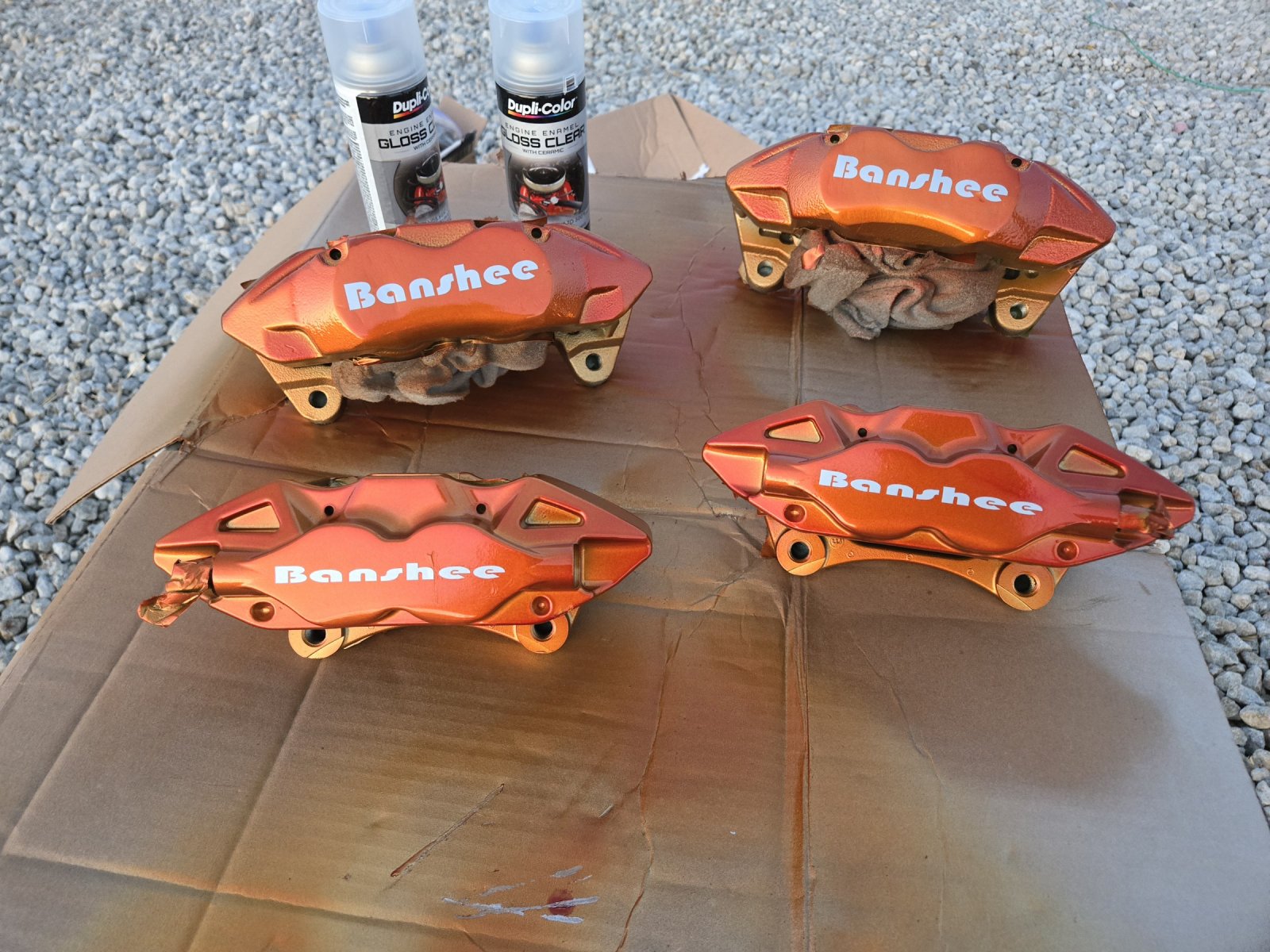

You can get the 2018 camaro ss rear calipers they are cheaper then the corvette calipers even though they're the same. Here's a pic of the ones I'm putting on my sierra.

You can get the 2018 camaro ss rear calipers they are cheaper then the corvette calipers even though they're the same. Here's a pic of the ones I'm putting on my sierra. View attachment 433418
any changes to the brake line needed? dont see it mentioned
i went ahead and ordered the brackets, calipers, pad/hardware kit
hoping the fixed caliper will last longer as opposed to the floating
will likely stick with the 2021+ ppv front set up
Not sure on your application but on the k2xx the brake lines stay the same
