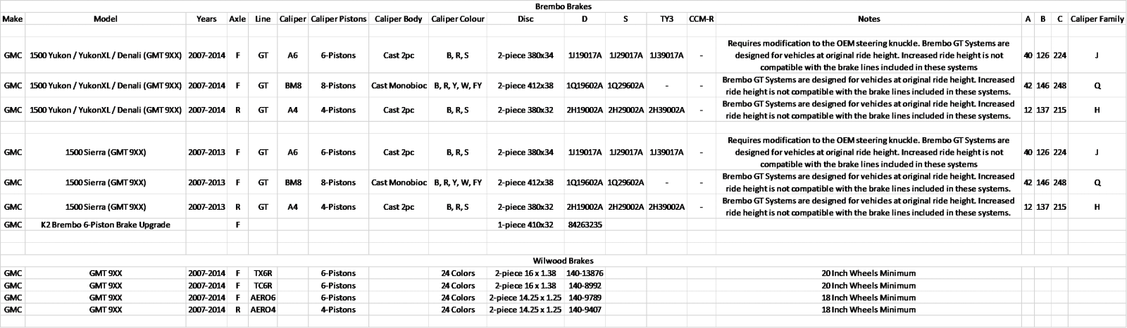

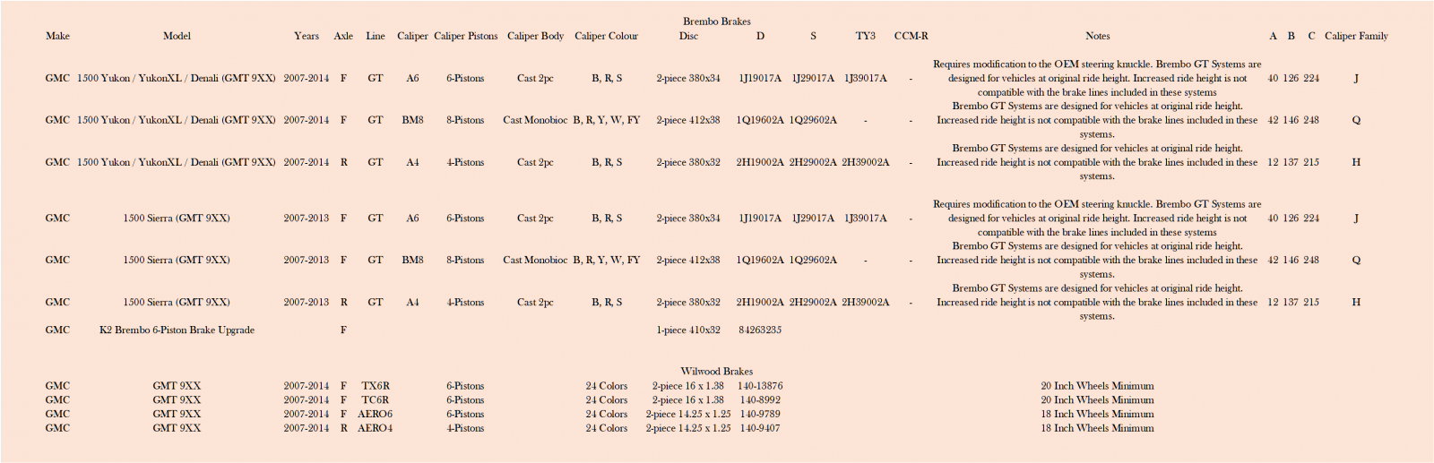

Brembo and Wilwood both made 4 piston rear brakes for the GMT900s.
Here are my notes:

with the black background that list is incredibly hard to read James

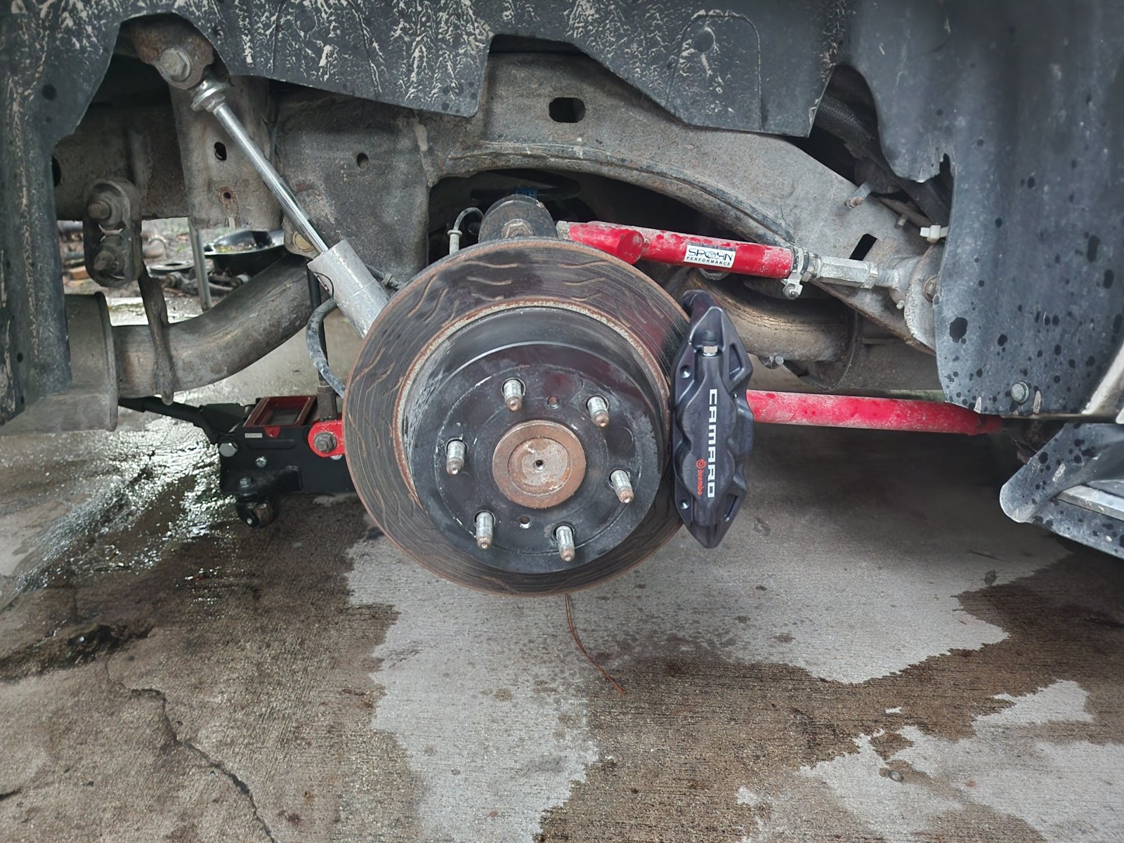

ctsvswap bracket works perfectly with camaro/corvette/ctsv? rear 4 piston caliper. "hardest" part is trimming the dust shield
i believe all of them are the same with the difference being the location of the bleeders, the ctsv is on the leading side of the wheel - while corvette and camaro are on the trailing side. which was confusing because on the gmt900 yukons the caliper mounts on the leading side which would, to me, mean the ctsv would be a better candidate to swap on our SUVs.
i used the cheapest oems ones i could find, which were the black camaro calipers

Any issues with brake bias or pedal feel by adding the 4 pot in the rear?
