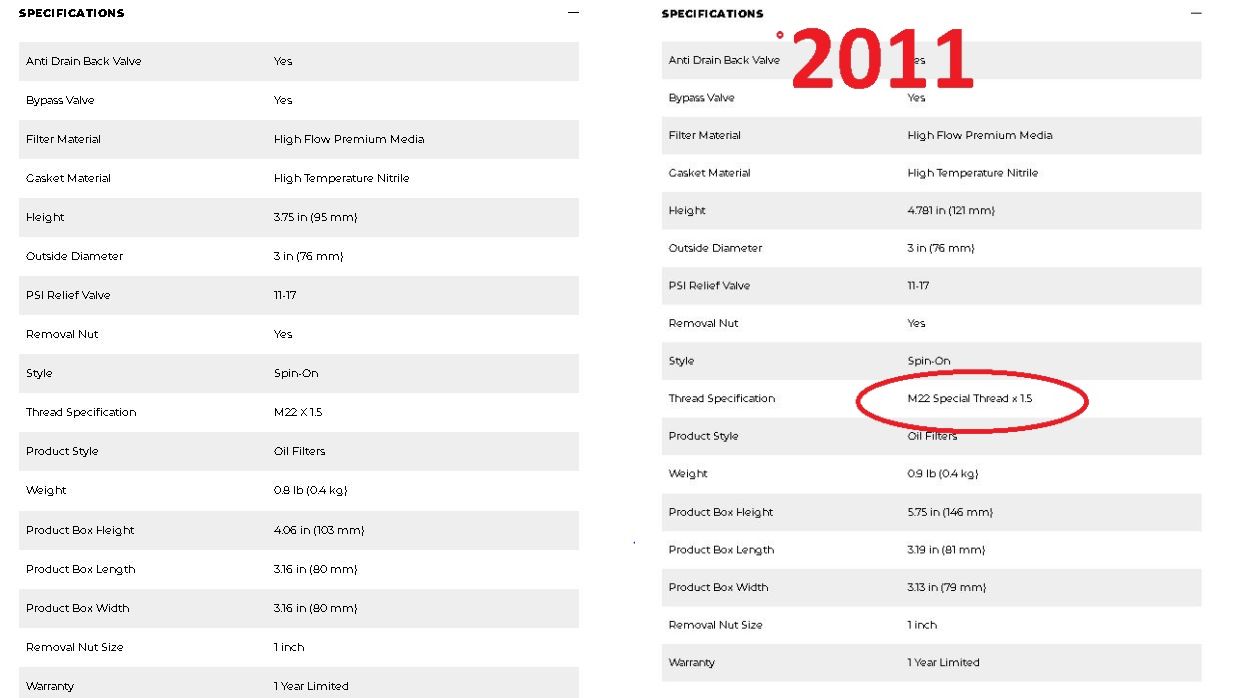

why does everything say mine it takes a hp-2017?(pf48) what is the difference
or is it just a shorter filter? notes say "special thread"
Yes, the 2011 is the long filter, like a PF63. No issues screwing it on.
