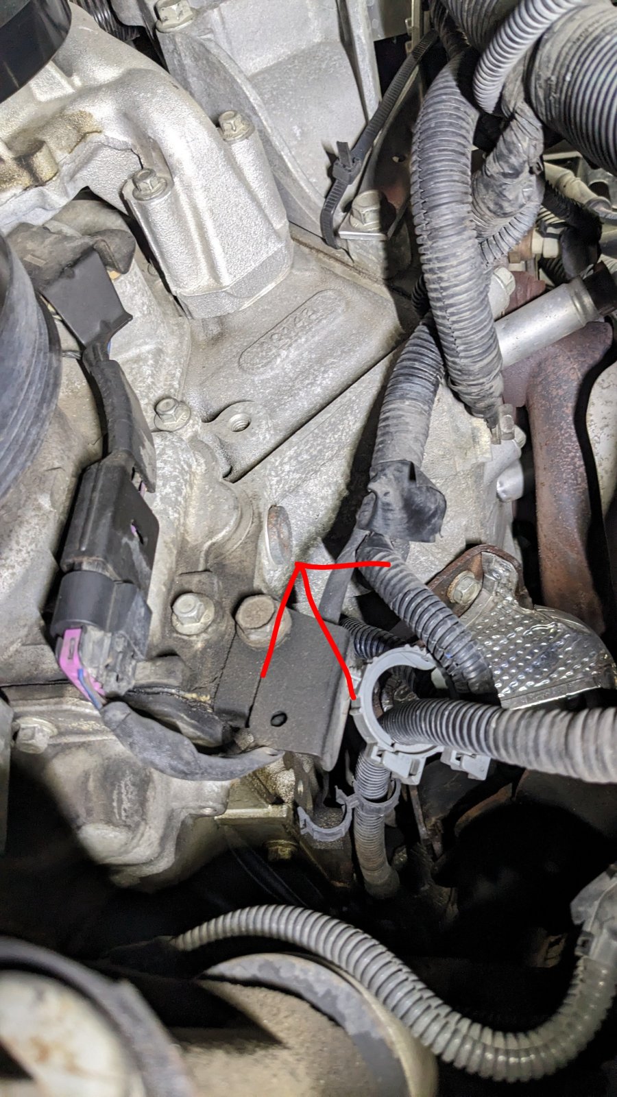

yes. there's a port on the side on the block right after the oil pump you can put a gauge on. it's the same thread as the back in the intake. there's also a remote mount sensor hose you can buy. then keep a known good one with you on the road. PXL_20251012_175321127.MP~2.jpg
