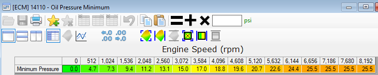

Here is where the low oil pressure warning lamp activates ...
You realize that that table is also tune-able, right?
For example:
RpM: 000 . . . 512 . . . 1024 . . . 1536 . . . 2048 . . . 2560 . . . 3072 . . . 3584 . . . 4096 . . . 4608 . . . 5120 . . . 5632 . . . 6144 & Up
Min Psi tuned: 7.3 . . .. 9.4 . . . . 11.2 . . . 13.1 . . . 15.0 . . . . 17.0 . . . 18.8 . . . . 19.6 . . . 20.7 . . . . 22.6 . . . 24.4 . . . 25.5
See what I did there? Obviously if you raise the numbers too high, you get false warnings from the dummy light,
but it should be clearly evident that people think they need far more oil pressure than they really do.

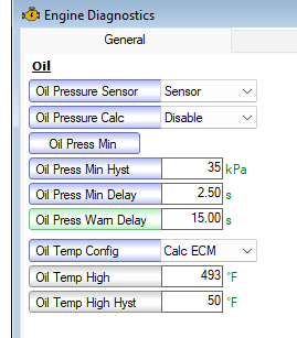

This is what hptuners sas about the delay setting..
Right, 15 seconds seems like awhile..
Maybe they figure you'll be watching a big smoke cloud for a few seconds, so they'll let you digest that before throwing the warning message up.. ?
I'll probably change mine to 5 seconds.. 2.5 seconds for lamp, another 2.5 seconds for message to display if pressure hasn't returned....
Unless the low oil pressure warning will do something like throw you in REP mode.. damn computers you never know what'll happen!
I know I don't want REP mode.. almost take runaway throttle over REP mode..
