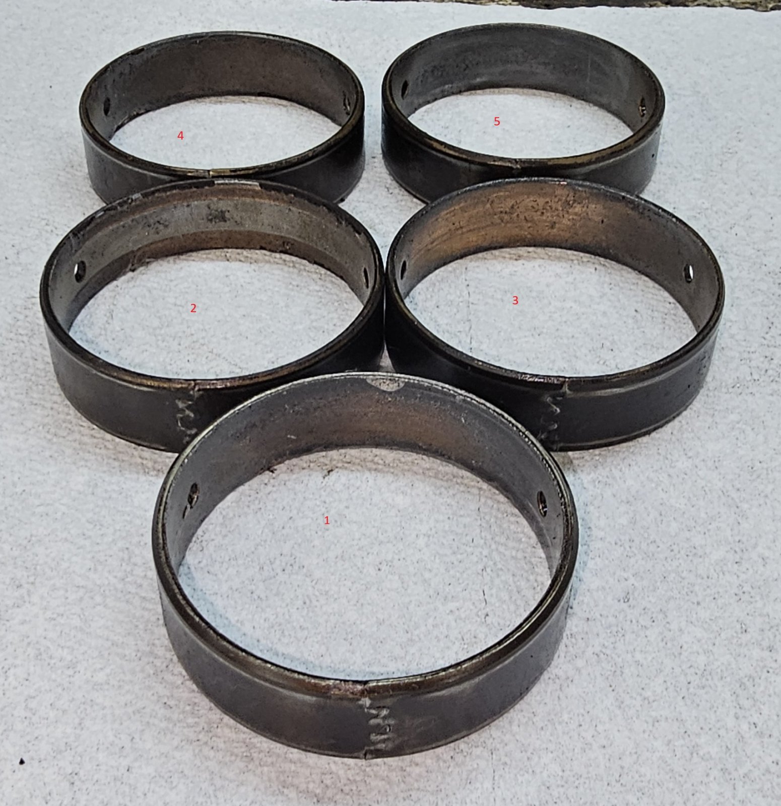

After having a few 07-09 6.2 engines with over 150k im a firm believer that if they have lowish oil pressure the cam bearings are probably shot.
A guy can band aid it with a new O ring and HV oil pump but it still has bad cam bearings.

There is very little supporting the #2 cam bearing. Only about .160 on each side of the center cut out. #1, 2, 3 bearings are usually the worst.
Look at the pics you can see the ware pattern on the cam and bearings.

I should add about my thinking.
The AFM is not the cam bearings problem. The VVT is the problem with original short bearings.
AFM wiping out the cam is from a failed lifter, not bearings.
They are 2 different failures.
The original cam bearings are not long enough to fully support the cam in any of the 5 cam journals either.
That is the reason to install the longer 1 piece CH-25 bearings if you do cam bearings.
A new non VVT cam rides on the previously unused portion of the #2 bearing (the unused center part). Maybe it is supporting the cam better now then when new?
A used VVT non AFM cam when removed is usually good and can be reused but should be polished if reusing.
I could be totally wrong cuz im a dumbass, but from my experience i believe im right.
