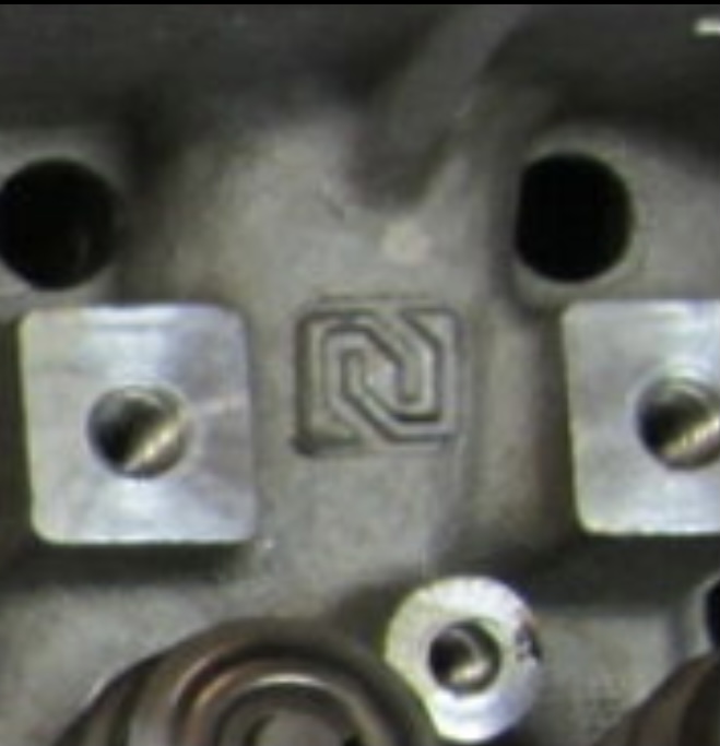

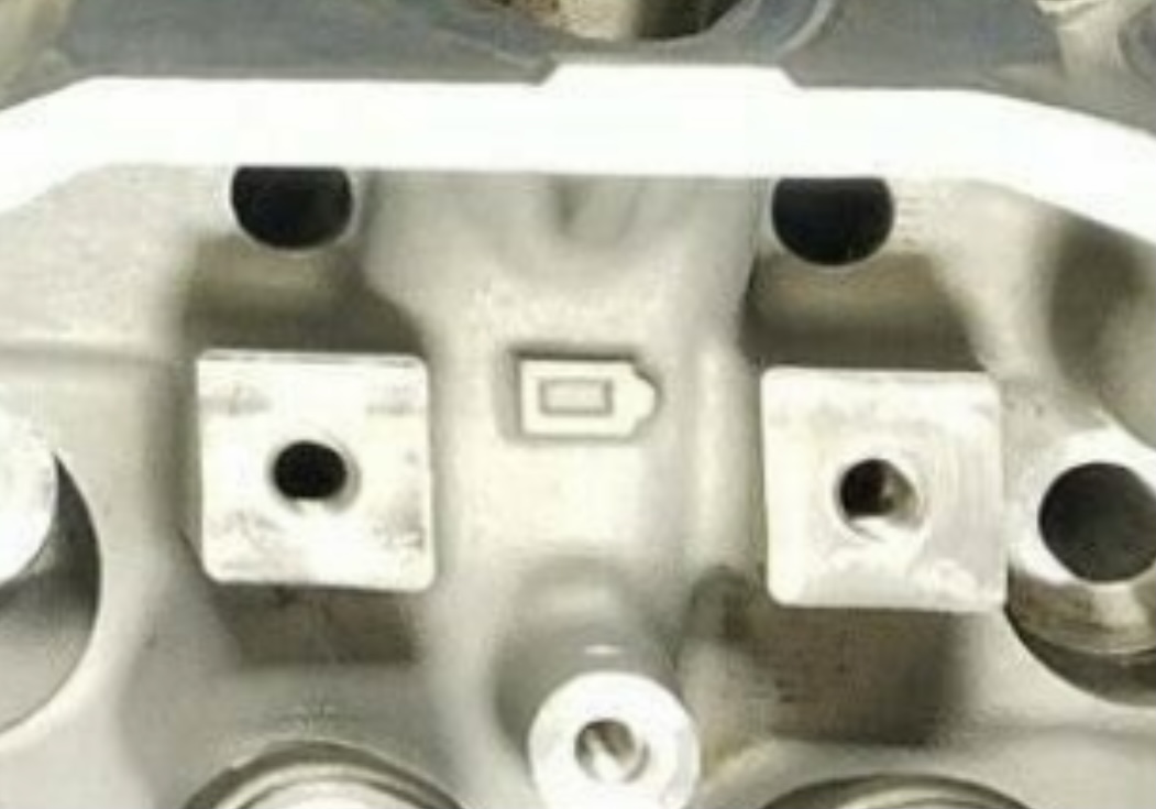

Is there another maker of 706 heads besides Castech?
Castech
...and whatever this is
