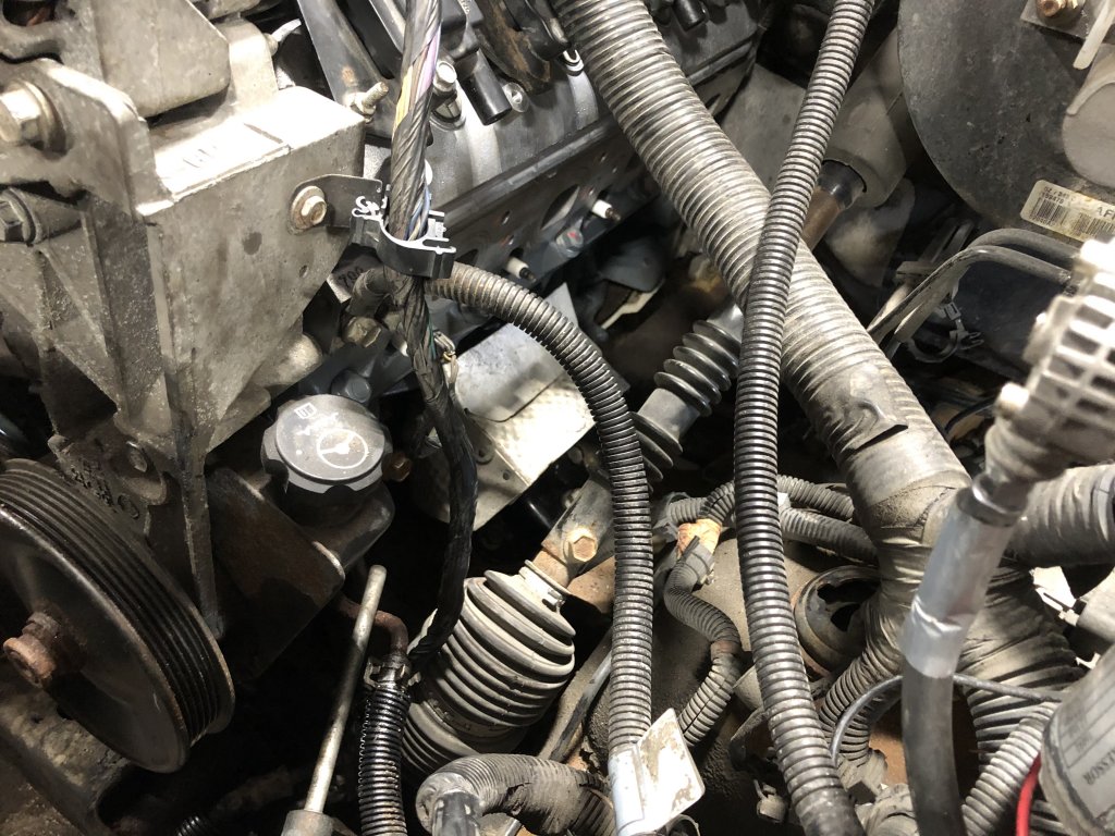

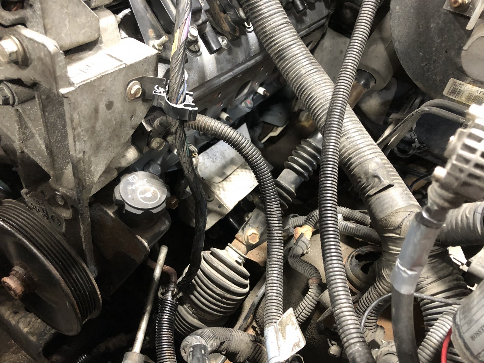

NOW they are saying headers won't fit on drivers side between steering shaftt an drivers side and are hitting the firewall
