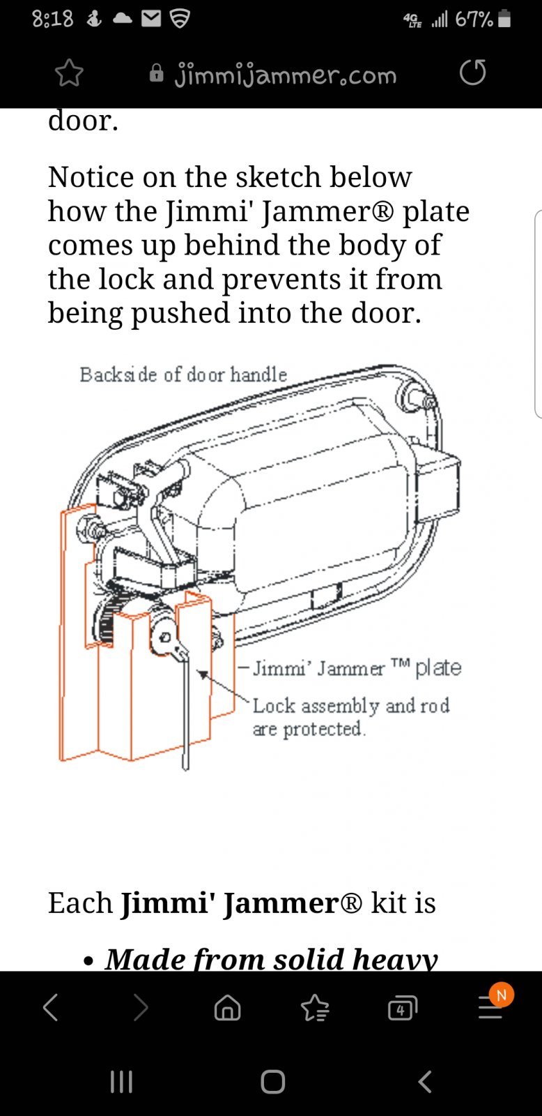

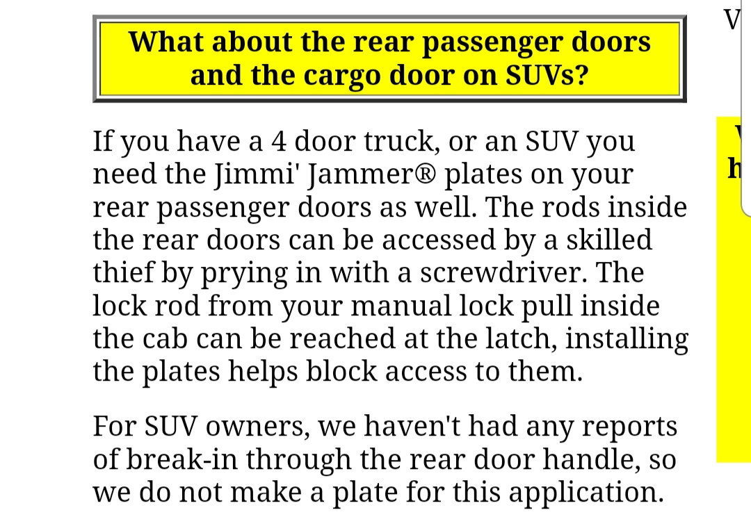

Tony, I couldn't find the one for the rear. You have any deets?
I could've sworn there was one for the rear hatch--there isn't. For ours they only sell for front and rear doors.

I’ve got the front and rears coming.. don’t see one for our gates. Sucks too. The site made it sound / look like there was one, but only truck tailgates.
I also thought there was one. On the plus side--not a hard install. Did all 4 doors about 4 yrs ago. Just watch those sharp metal edges on the doors.
