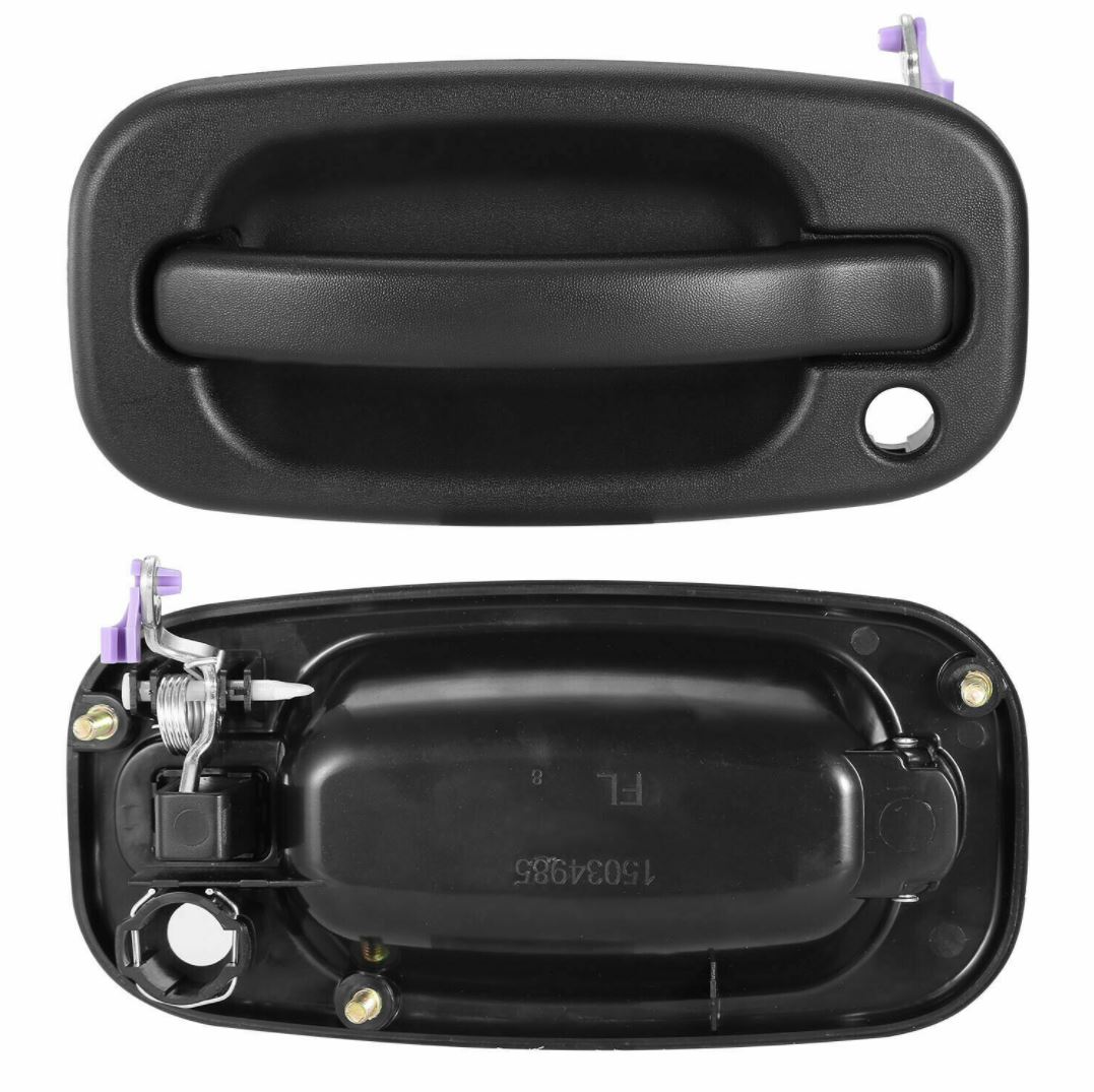

There's like no damage at all, just the lock cyclinders have been popped out or in or however that works lol.
Heres pics
yW42rdWaNJlXzBboT1irkRc32phZHpE3dgHYlKiVFKCCG1YLovtwFYbJj8kP7QU3KTpS4rxwABcsAlA6a4P0tcS78HXH9pE6jeaQVk773tnlWn5PSF6_MGOr5-z0UWQdtoJNm0-hG5tvpx6yL_fttV8n9V0zMWVmUCAZmG7uPTr178Xf77xrbOZSAYVjEJyIe20soWMq5U67kkjAEphEwrgWTY8qoOBNLKprO_DZ_atXK9Isn_rE3LG6rlUNIav9zOyaFW7eFMHu7LEYGcGpB815c9PLi0FGPnuUB3pXSta3ML8I7G5DYM15MWbIUQzop1E1ZhIHSVFOiXboY2dIyufEhtUWsaMdkuwBtAbujYo2kX5UtZm6epaYCUjwjcKn7tBPVTwL-zo7l9Llh-B0-gVSVfQ8KQVdbCKYgXZNDM9jaIJaZC0E87O6h9Ntcd0Z-_XTBy5Yr6anHbX3okevYTPUEYh0q5KUlEOPViI6TcnuAcCeRHf59VXy3MSmXlf6B2Zz-8aG3lMFgjxQmvDi9sfXFCqU1A1j9ypDyU5zQczIMGN0xwDekBTqJxfkJDRvPuTqstZZvZp34OhnpoE2N0AH9p3s331C3XG4_9wfQ5dvqw1nXhVYs6LNMDnkOpbWzQBwIUHEa4GlaoJzWGFH8qJEnfT-PtUNHeapWL7V4pih2M-6ucnuzNNfxi7cTBPrvr2Xhd9crtigGrssQAUhVori=w1299-h1731-no
and the other door..
98CPCyXs2AMddbP6TUxq8su3R_cbrQFcwOW4-T6JMHMfUPXDGRzK9XTkRhyNjlHIeSOATMXHQ47YquHskOCkIv2AOfsOiRHmZSWqa3E65mjzNqNRgMIApZNS7SEgV2Sq4afypy9agLL8FzYS0jWPlOS1Mb8Zbz4g-fqKoxn0wZurAk9PgAANmXFGRTkKoK1Tp4HaeBk67rMlcAoxKdpISeLcbPPlesqDTgCvr-3bHHEmj4HOuytBFFrdRs80J37iKOCi6mAX5BQXtpWOGhIf_uoRCG0Dg-R-gMMyVHNovwjGmhh-Y_OX5oLNcdVIPZLlMrwj3NwTMTXtwdzXTg6jPYwRyvs2gQ_zh7W8ADgcfOYsyHd3IvlF3xmta9JsN9f8IPVeGH1fe1mbjzkvjfg0miP1Rxeg4gL7NB3NELCWpGRmV9tqIPudCuGDMwn410bpgJkjf9fMRFWIs4yV0tlv6di50-nXxOSDzaJoN4kpYJritZWHE8smOvmqcMOyPnRXIp9ZK57o5Ibw4p9fj48gHp-gq5aWe_SWFhBirEz89cydqVgs7qA8anF04jY3UHavcnJU5a69EsznFHUF5CjNGyAm1Y8iXzTF-WgiBNMfFauXfsXAgg5LjuQu0crcguhbFybRhwZLdPrRhF2i3aa1TT77h9nfZsPPIOneHW7e-3knSxnCmoDAeZ_ueQYhqS-hAFivA8l2PNS8_F5CErIKRAgu=w513-h684-no
they both work, the locks work with the keyfob. It looks like to me that I just need new lock cylinders.

what happens is there is a plastic piece and a metal clip on the inside of that slot where the lock cylinder sits, sometimes the clip just pops off and you can just put them back together and sometimes they break the plastic off so you have to replace it (which would require paint for the handle), either way it's about a 20 minute job per door, just take the door panel off and it's 3 10mm nuts and a clip for the rod inside. super easy. $900 is completely ridiculous there just gambling on your lack of knowledge.

I looked up some paint and the oem door handles are available at Rockauto for about $45 each and autopaint depot has paint for $53. It looks like the lock cylinder set is only $89. I suppose a locksmith could key the locks for me and that would be it.

I would replace the passenger side with a rear door handle that doesn’t have a key. You don’t need a lock cylinder on that side. And I agree 100% with automotivetouchup.com for paint and don’t forget clear. U-Pol #1 clear worked good for me, they sell it there too. The door panels on a NBS have no clips to hold the panel on, just (3) 7 mm screws. The panel just lifts straight up and off. There’s YT videos on it. I can pull my panel in 5 minutes or less.
