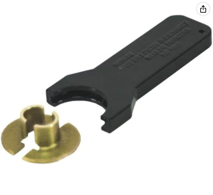

Co-signed. Also, this tool will ease working in a cramped space to disconnect fuel line from the filter.
