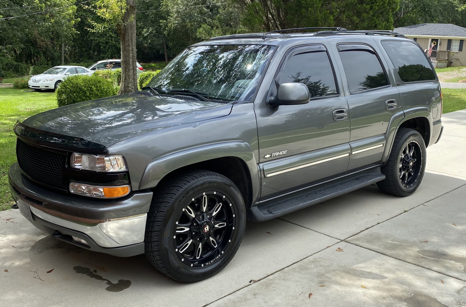

Im just outside of Mobile, AL. Sounds like you’ve been a little more involved in your rehab. I’ve done a fair amount of work to mine, but mostly fixed things as they failed for the longest. In the last year or so I’ve gotten into a position to be a little more proactive and start looking for things before they become an issue.
My ‘hoe is grey.
