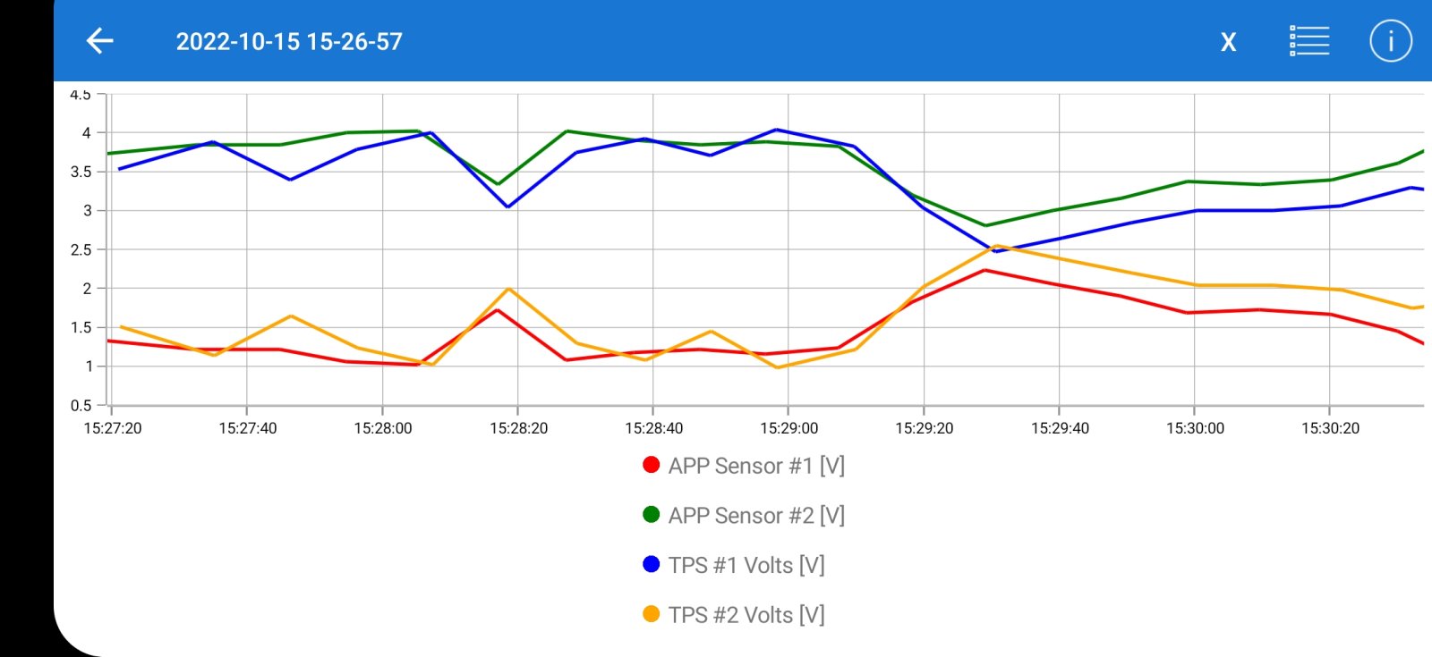

I sometimes use an OBD2 dongle with the Car Scanner app to capture sensor data for review and analysis.

Well the two indicated positions should be sensor data, but only one frame..
If indicated and actual TPS don't match, it should be the TPS, or TAC, or associated wiring... Kinda narrows it down?

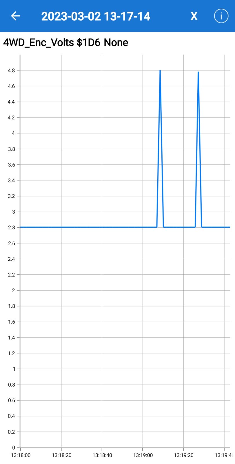

Particularly useful catching poor connections. Here I caught a bad connection on a low reference circuit from a 4WD encoder signal.
You can tell it was the low reference by the direction of the spike. Lose the low reference and the sensor voltage shoots high. Lose the 5 volt signal and the sensor voltage goes to 0.

Note that the APP #1 and #2 (and also the TPS #1 and #2) values are inversely related; when one goes higher, the other goes lower. In the graphic that @TJ Baker posted in #10, they each vary from their respective high/low voltage by the same amount.
In other words, when one APP value is 1v higher than the low voltage, the other is (or should be) 1v lower than the high voltage. This provides for sensor accuracy validation, so when one is not tracking the other, it can give fair warning of an issue with throttle commands.
