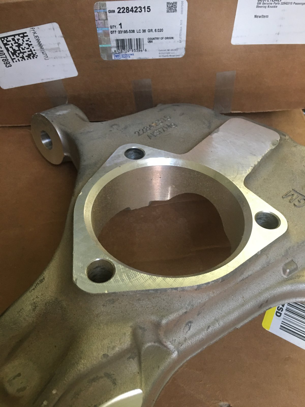

GM OEM Alum Knuck P/S. New $48.49 shipped off Amazon “save with used” category which was actually a dented box. # 22842315
GM OEM Alum Knuck D/S. New $54.03 shipped off Amazon “save with used” category. # 22842314

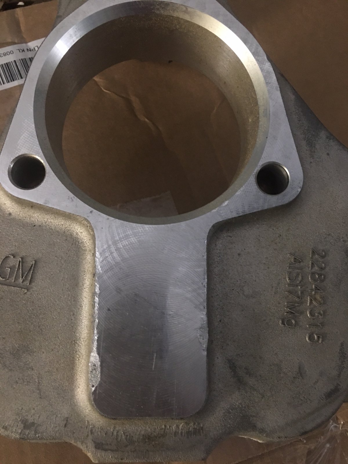

Is this going to be a problem? I got this aluminum hub from Amazon bargain basket that has two blems on the mating surface. Is it a critical or non critical area? It can catch my thumb nail but also easily be buffed smooth. Whatcha think?
45,013
That's a knuckle. The hub bolts to that knuckle. Those blems below the three bolt holes are 100% harmless. Nothing mates to that surface. I'd file down the dings on the mating surface where the hub goes, though. In this pic, the one at the top right halfway between the bolt holes and the ones to the left of the lower right hole. Plus any others that might be out of the picture, at the top.
Nothing mates there, the wheel bearing assembly will line up with the 3 holes and stand off the knuckle
