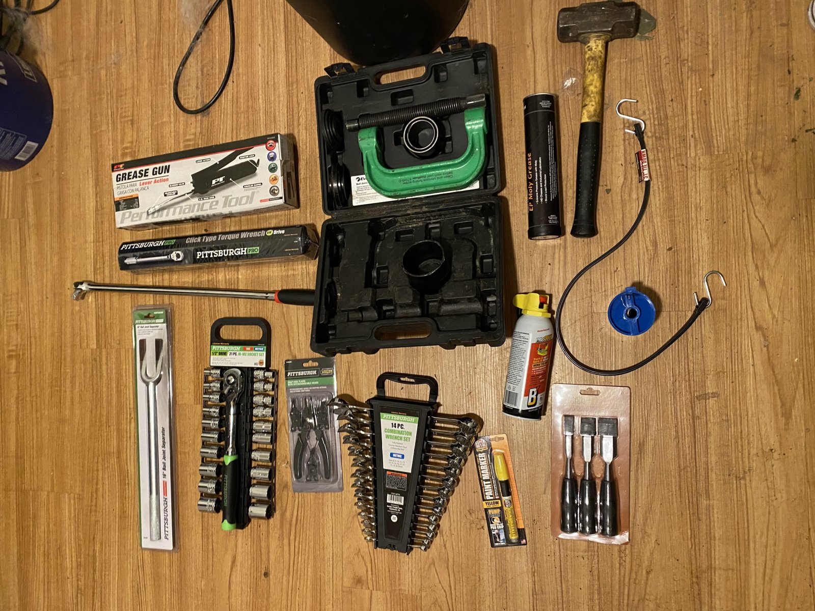

Gonna give her a go tomorrow wish me luck. Think I have everything as far as tools go but we’ll see
