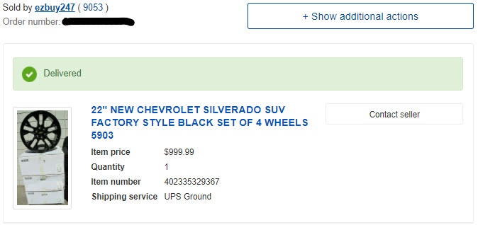

So, the eBay seller I got my wheels from messaged me to tell me that there was an inventory glitch and that my wheels aren’t available and I can select something else or get a refund. What are the details on your wheels and did they require spacers?
Thanks in advance!
George

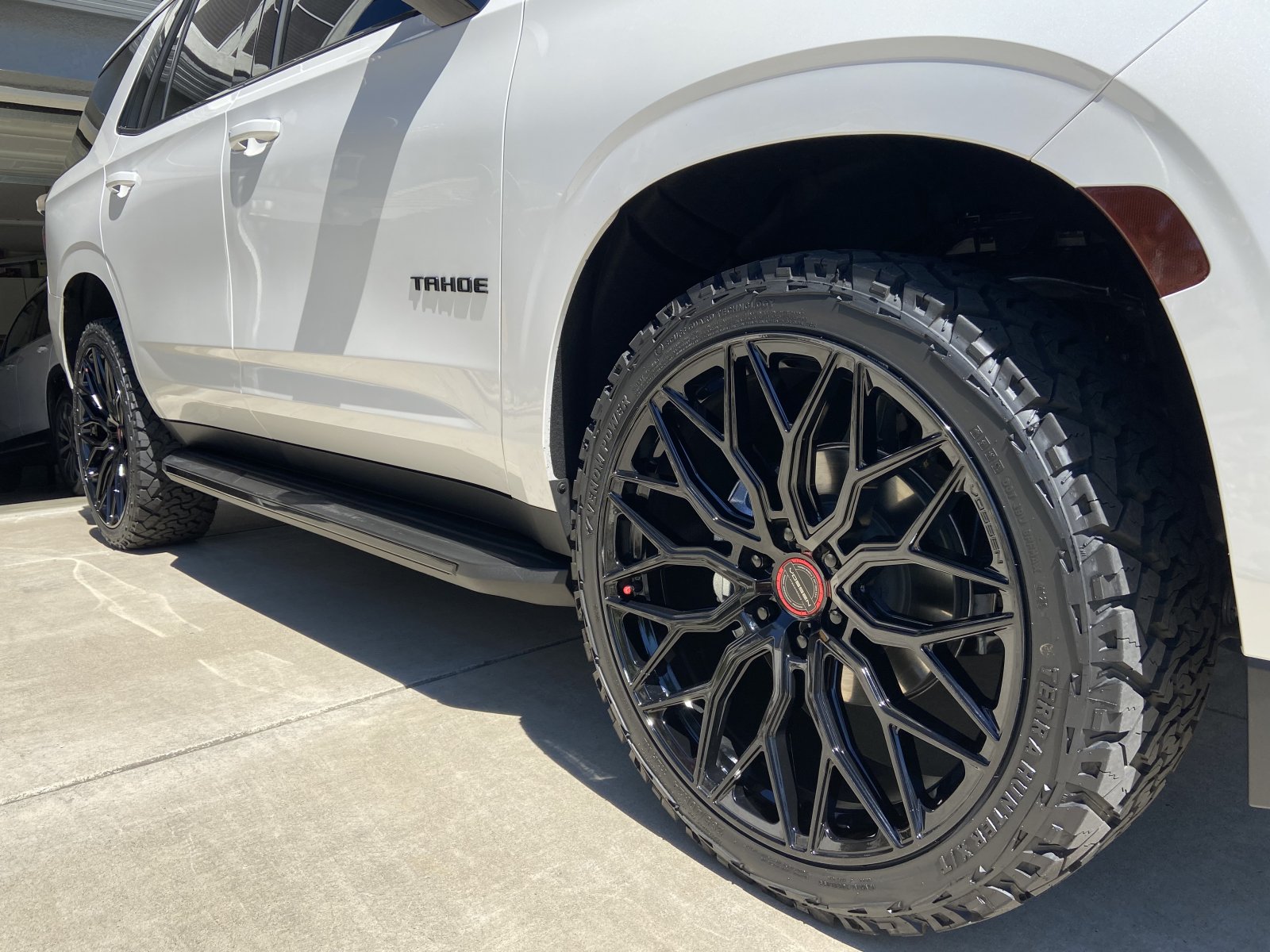

These are the wheels I purchased. Apparently not showing up as available now. No issues with fit.
Thank you so much. 22x9 + 24 right.
I think I have found them from another vendor. I’d gladly go with something that has a confirmed no issue fit.
Thanks again! My truck may end up looking awfully similar to yours, although I don’t have the z71 nose.
