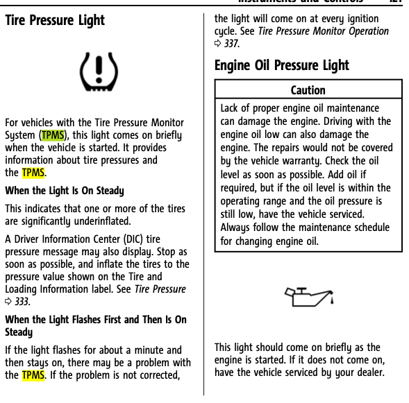

If the dealer cannot figure out how to diagnose your TPMS sensors, you need to find a new dealer...that is the craziest thing I have ever heard.
From the Owner's Manual:
So, is your light flashing, or just ON, or not on at all?

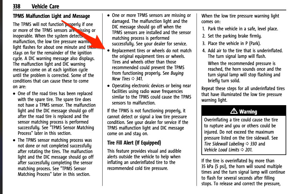

Also, note this section on "Replacement Tires and Wheels". Perhaps your new wheels are structured such that the location of the sensor is interfering with the radio frequency trasnmission and makeing the vehicle have a difficult time reading the sensors?

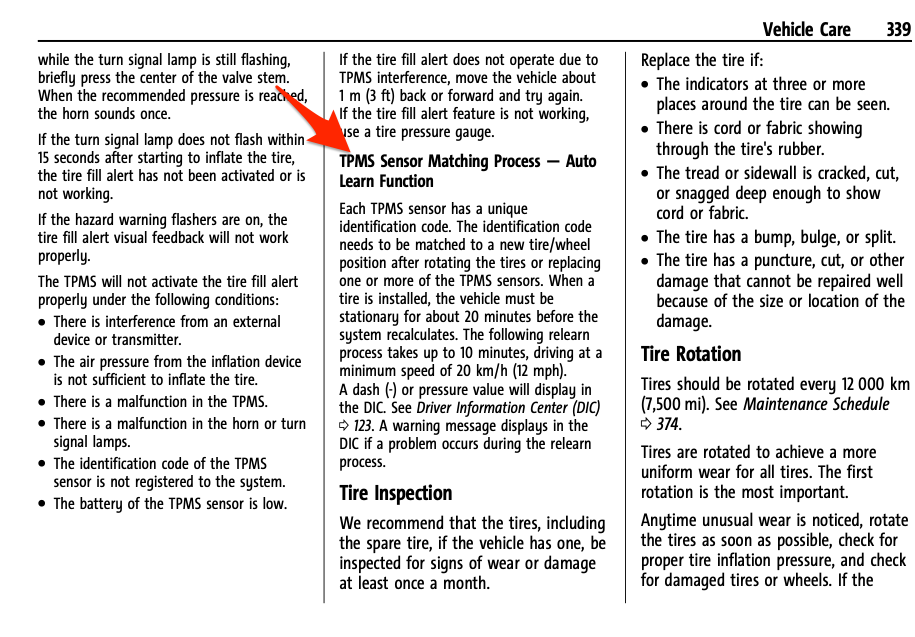

The TPMS Sensor Matching Process works like this, and is automatic...you just need to let the vehicle sit for 20 minutes, and then drive non stop at minimum of 12MPH for 10 minutes.
If these things are not working, my gut says your aftermarket wheels could be the culprit.
