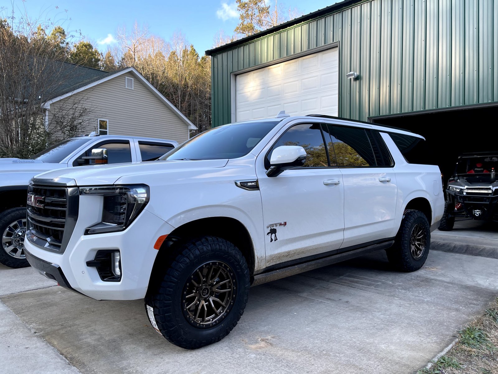

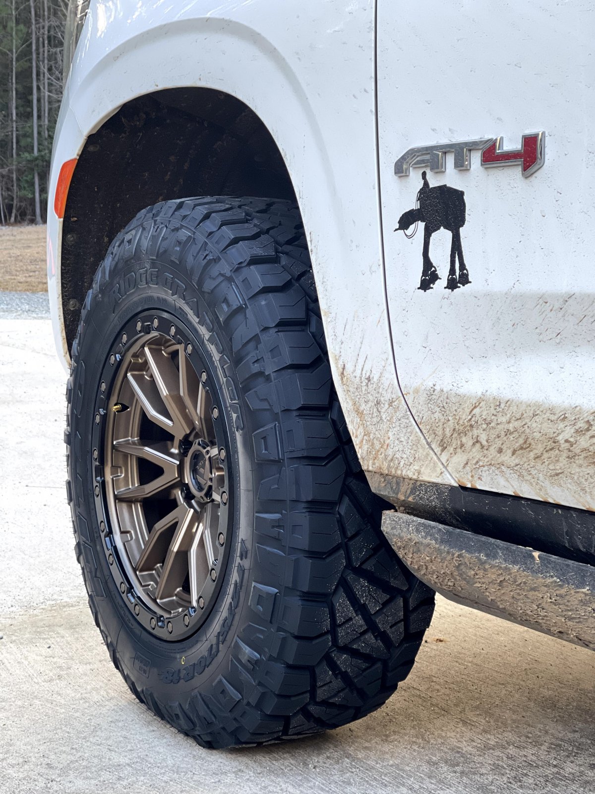

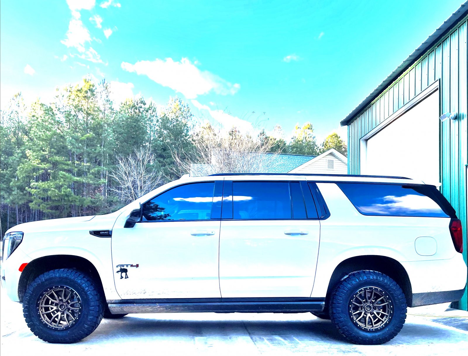

Posted a bunch more pics in my vehicle specific thread but I put on Fuel Rebel 18x9 +1 offset rims with 275/70R18 Ridge Grapplers this weekend. Really makes the AT4 package look substantial.
So for those who were curious 18's will clear the calipers easily. Just to my eyeball you may be able to go 17 but 18's are perfect for a nice balanced offroad tire combo with plenty of sidewall room to air down when desired.

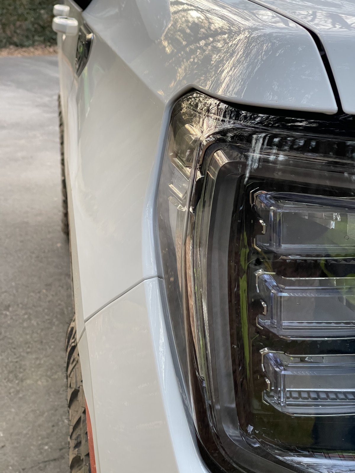

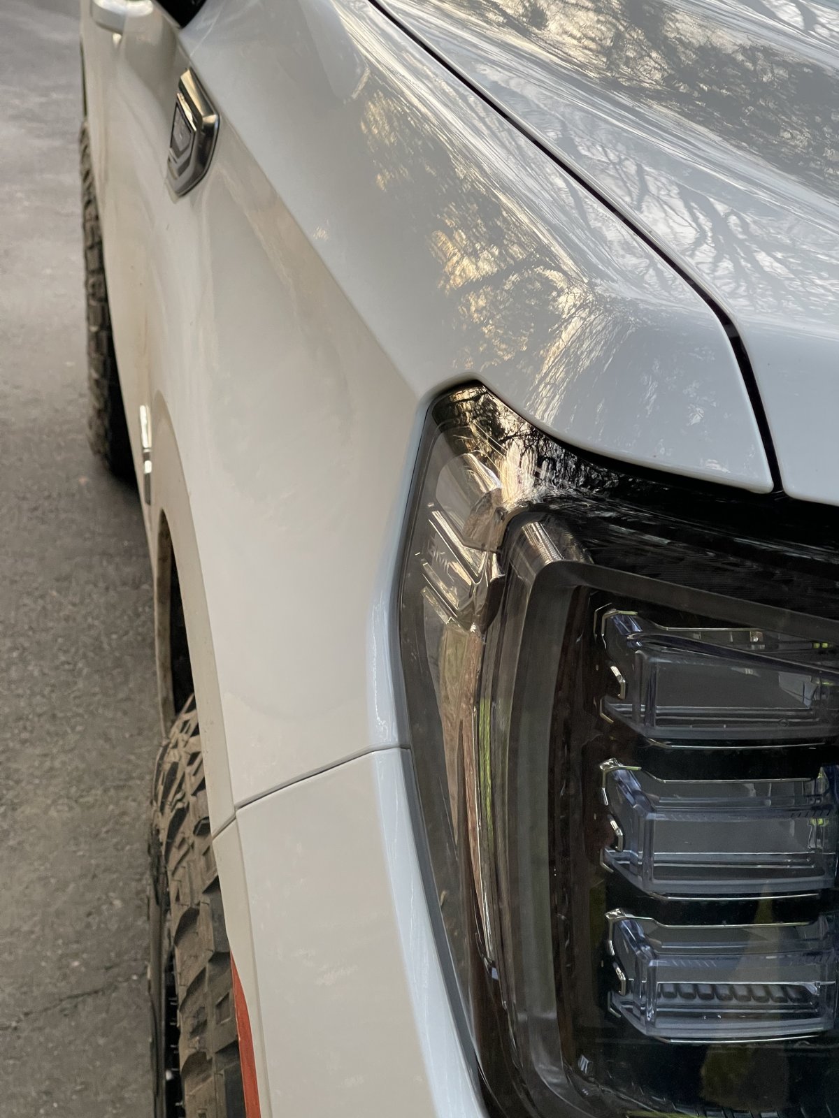

Can you take a pic from the front down the side of the vehicle so i can see how much the wheel is in the wheel well. Trying to see what that backspacing looks like.
Looks great and this is the look i'm going for with my tahoe.

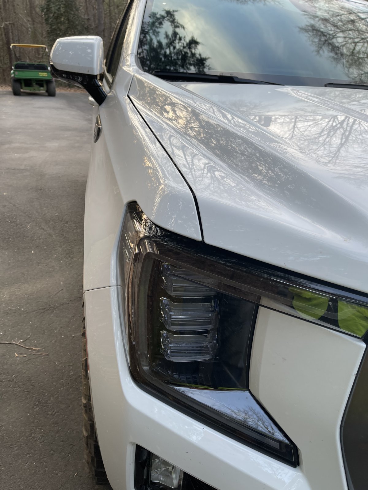

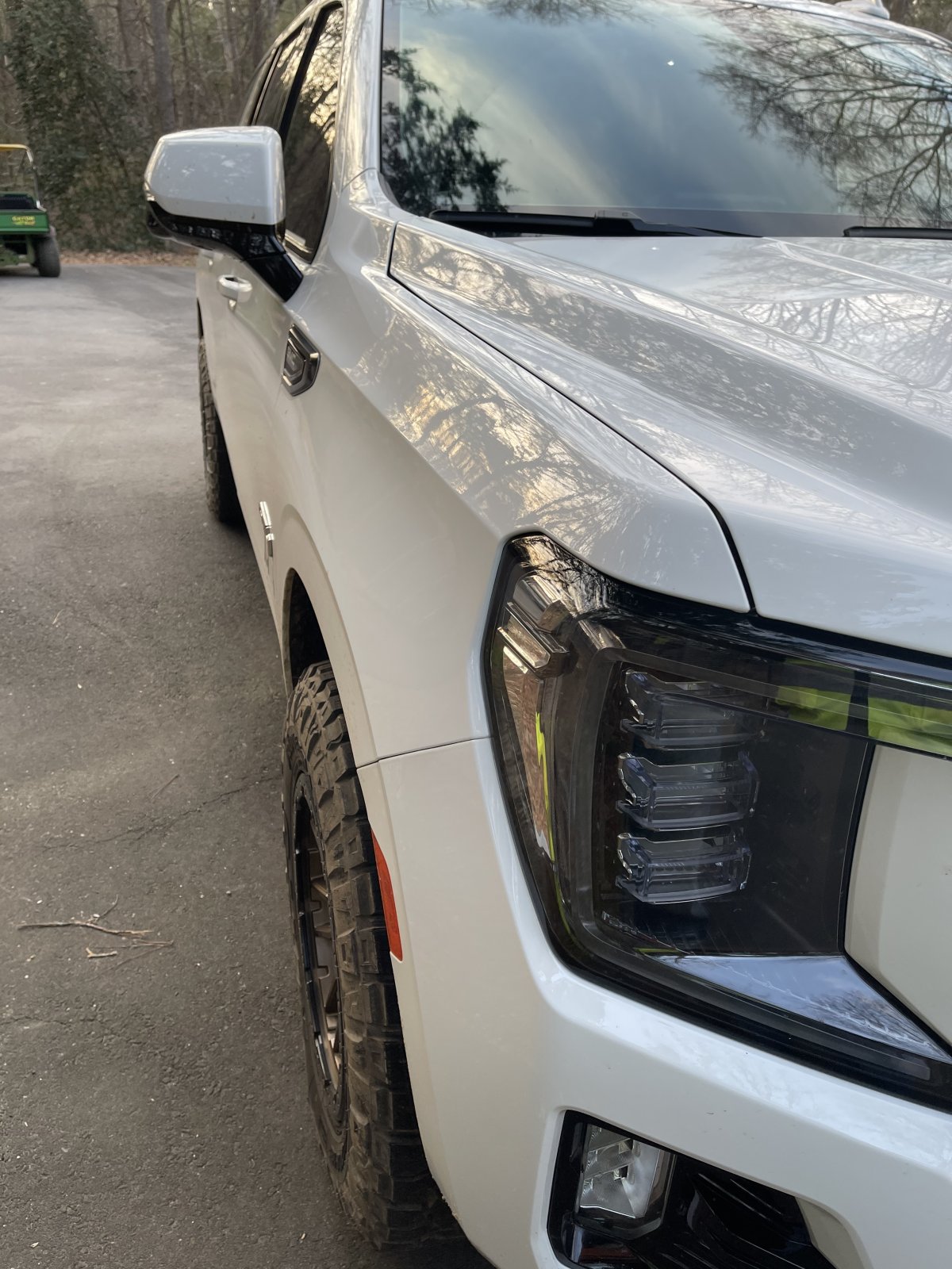

I took a few as it looks really different from slightly different angles. Hard to describe. I would describe the sidewall as dead on flush with the widest part of the fender but from slightly away from the side it looks stanced.

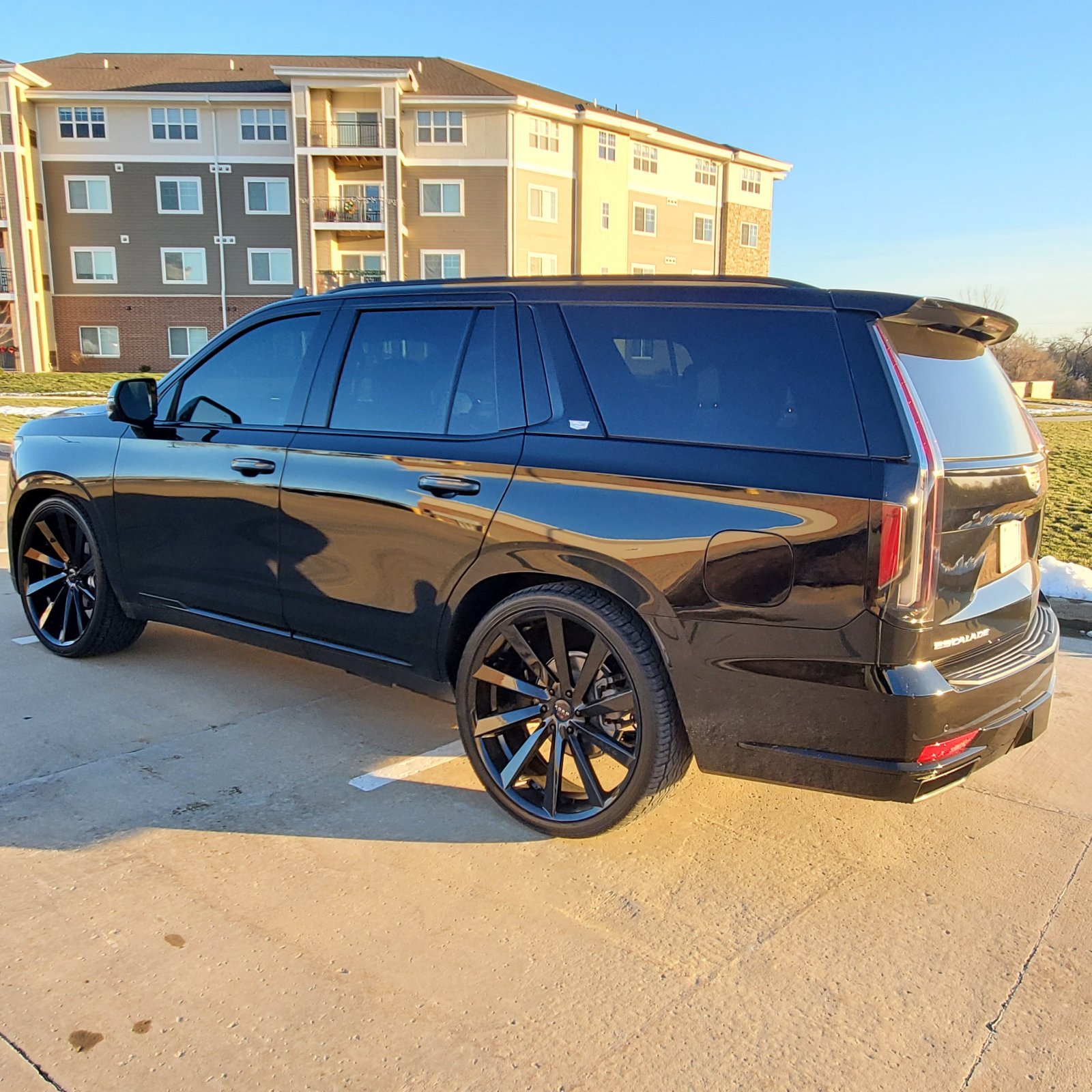

Can anyone help with a tire size recommendation for a 2021 Tahoe RST. Swapping from the factory 22x9” wheels to these.. Kraze Lusso 22x9.5 et 30
My brother who owns a shop seems to think the factory 275/50/22 tires will look anemic and suggested going to a 285/45 or 305/45 but no one seems to know what fits yet without rubbing etc on these new trucks yet. Help!
Thanks,
George

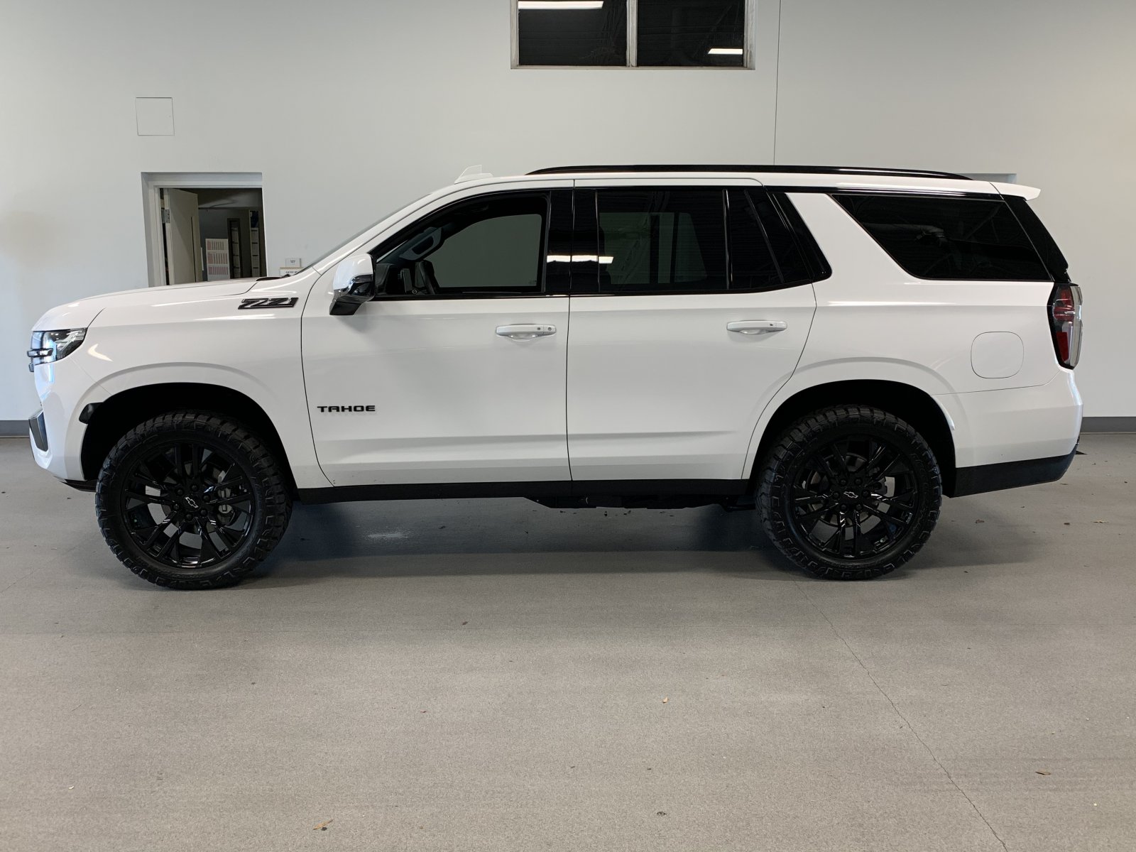

22x9 +24 offset. 285/50r22 no rub

Considering the same setup for my Denali. Are you having any rubbing issues? Thanks for your feedback in advance.
