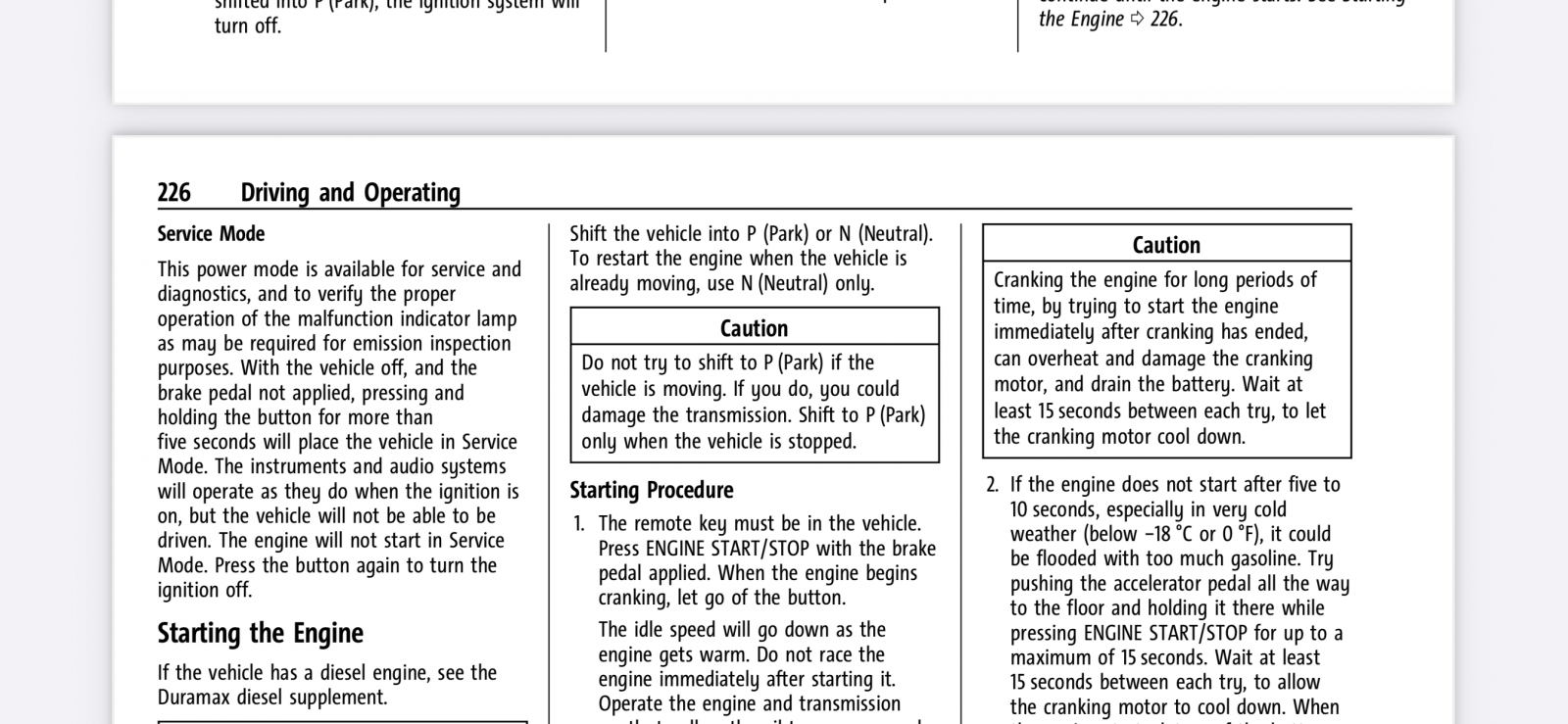

Press and hold the start button for more than 5 secs without touching brake pedal then shift trans or transfer case as usual
I tried that. The regular shifter won't move out of park and the transfer case will switch and complete its shift to everything but N and 4wd low. N flashes on the DIC but then returns to 2WD H.

Page 226 in your manual. Service mode

Hold it longer
I got the vehicle to go into service mode but when you try to switch out of park you get this message on the DIC " Conditions not right for shift" As for the transfer case it will move in and out of auto, 2wd and 4wd with no problem. When I try N all it does is flash for 5 seconds and return the DIC picture to 2wd. Kind of scary know this vehicle can't be put into neutral without the engine running. Kinda missing the old fashion shift lever now :(

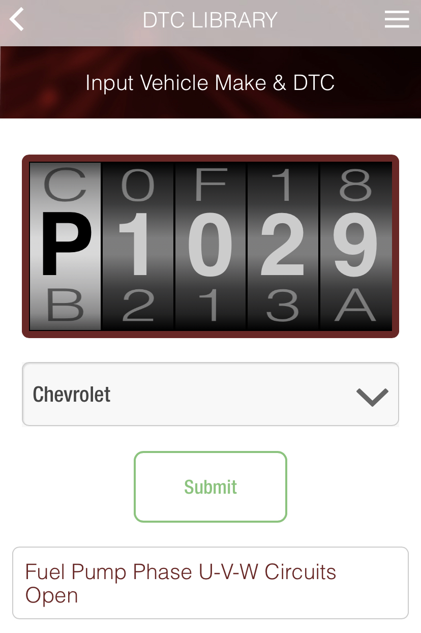

Anyone know what the hell a P1029 code is? I looked online on many truck and GM forums and no history of that code for a GM vehicle that I could read about. I know it means other things for other car makers but wondering what it means on a GM product.
My Innova DTC app shows this for that code.
