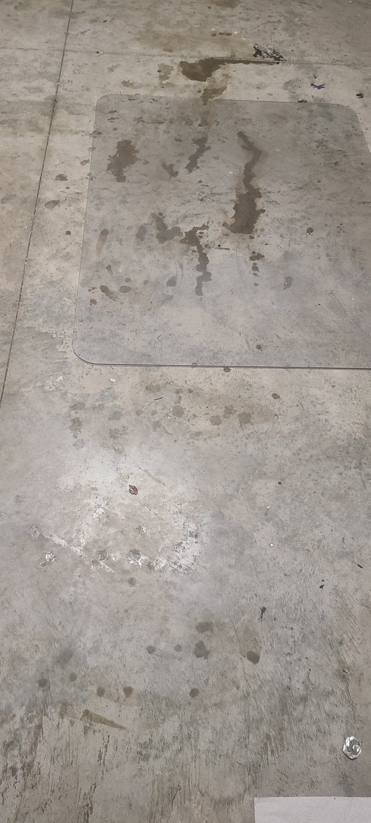

I finished up the afm/dod delete and the truck is running alot smoother thanks before however it seems I have developed an oil leak. Looks like one is from the front crank seal and I'm not sure what we the other one is yet. The 2nd undetermined leak looks like it's running down the oil pan and leaving like stream under the middle of the truck.
My question is, can the oil pressure sending unit leak down the back of the block, near the filter and onto the pan to cause a stream? I included a pic of my garage floor. The front couple spots are from the harmonic balancer/front seal and the stream behind if is what I'm curious about.
Yes, could also be rear cover, and most likely the oil cooler lines or block off plate near the oil filter.
When you installed the front cover, did you use the special tool that centers the seal on the crankshaft?
I agree with @swathdiver that the stream is most likely coming from the oil cooler plate. I found that the Fel-Pro gasket is not as good as the Dorman (a rare circumstance), which is modeled after the OEM part. Be super careful with the bolts that hold it on, or you will be putting a helicoil in there. Ask me how I know. :)

Yep, we did use the tool. I've hear they are tough to get on correctly.
I haven't been able to look at it too much yet but the reason I think it's the sending unit is because I had to transfer that over from the vlom to the valley plate and I did not use thread sealer or Teflon tape.
Assuming the sending unit is my other leak and I fix it. For the front seal, would it hurt to run blue devil through to see if that helps recondition the gasket to seal?! I'd rather not pull the balancer off again, it's a pain in the ass to tighten.
If you use an ARP harmonic balancer bolt, you can save yourself the hassle of torquing the factory bolt to yield with an angle gauge. I used an impact wrench to torque mine and it's solid. Note: I'm usually a stickler for torque values and have three torque wrenches for different ranges, but for that Jesus bolt, an impact wrench will do if it's an ARP bolt and you don't overdo it.

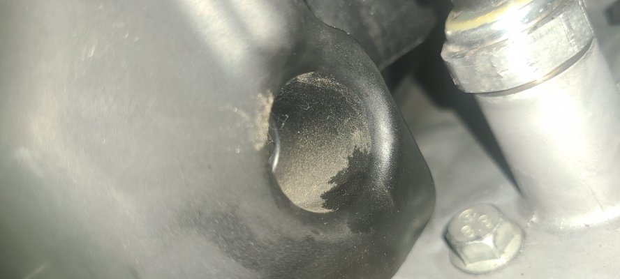

Yea, I took it out yesterday. Apparently when I put it back in the new valley pan I didn't seal the threads. I wrapped it with Teflon tape, put it back in, roughly clean the stuff under the car with brake cleaner and took it for about a mile test drive and had a little more oil pressure (was right below 40 from a cold start, now its right above 40) then let it sit overnight. I checked this morning and it looks like there may have been a few drops from the front seal which I know about but not a stream like before in the middle of the truck. I included pictures of what it look like around it before and after. I'll take it on a longer drive later and make sure everything is good to go. Now to figure out the front seal. Baby steps! Haha
