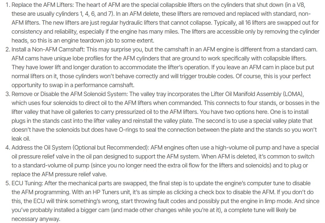

Here's a good article from Speedway motors that addresses the issue. Screenshot below, but here is the link to the whole article.
Screenshot of relevant info:
Of course, you can experiment all you want. Just be advised that if it fails, it can often be catastrophic to the engine. You may end up with a big paperweight and looking for a new block.

The cams are different, just measure.
I think it's pretty obvious at this point that this is the only way we'll get a straight, reliable answer. Not for lack of trying or ill intent, but just because GM makes it too hard to get the information needed.
But I don't even need to measure AFM vs non-AFM like I suggested at the beginning. I just need to measure the AFM cam that's in it.
It's real simple - either all the lobes are the same and the "must replace" guys are wrong, or the AFM lobes are different, and the "must replace" guys are right.
May be a couple weeks before I have data to share, but stay tuned...

A little info according to blindsquirrel on hptuners forum...
Lobe Lift 1-4-6-7 (DoD) 0.289
Lobe Lift 2-3-5-8 (non-DoD) 0.283
From google..
AttributeAFM Lobes (Cylinders 1, 4, 6, 7)Normal Lobes (Cylinders 2, 3, 5, 8)
Tappet/Lobe Lift~0.286" lift (higher)~0.275" lift (lower)
Duration & Timing3° to 4° longer duration; valves open earlier.Shorter duration; standard ramp rates.
Ramp ProfileSmoother, specialized take-up ramps designed to absorb the ~0.010" of mechanical slack inside a collapsible AFM lifter before it locks.Aggressive, standard hydraulic roller ramps optimized for direct, rigid valve action.
  • The Extra Lift (~0.011"): The AFM lobes feature higher lift and longer duration at the camshaft to overcome internal compliance. The special collapsible AFM lifters naturally absorb about 0.010" to 0.015" of mechanical slack and oil compression inside their internal locking pins before they completely rigidize. The extra lobe lift ensures that after losing some motion to the lifter, the actual valve open height matches the normal cylinders. [1, 2, 3, 4]
  • The Massive Take-up Ramps: The AFM lobes feature highly extended, gradual base-circle ramps. This slow-opening ramp design slowly picks up that mechanical slack inside the lifter to prevent the internal locking pins from slamming violently, protecting the valvetrain components from shattering. [1, 2]
If you use a solid standard lifter on these AFM lobes during a delete, the valve opens way too early, opens too high, and slams closed roughly—instantly triggering uncorrectable misfires. [1, 2]
