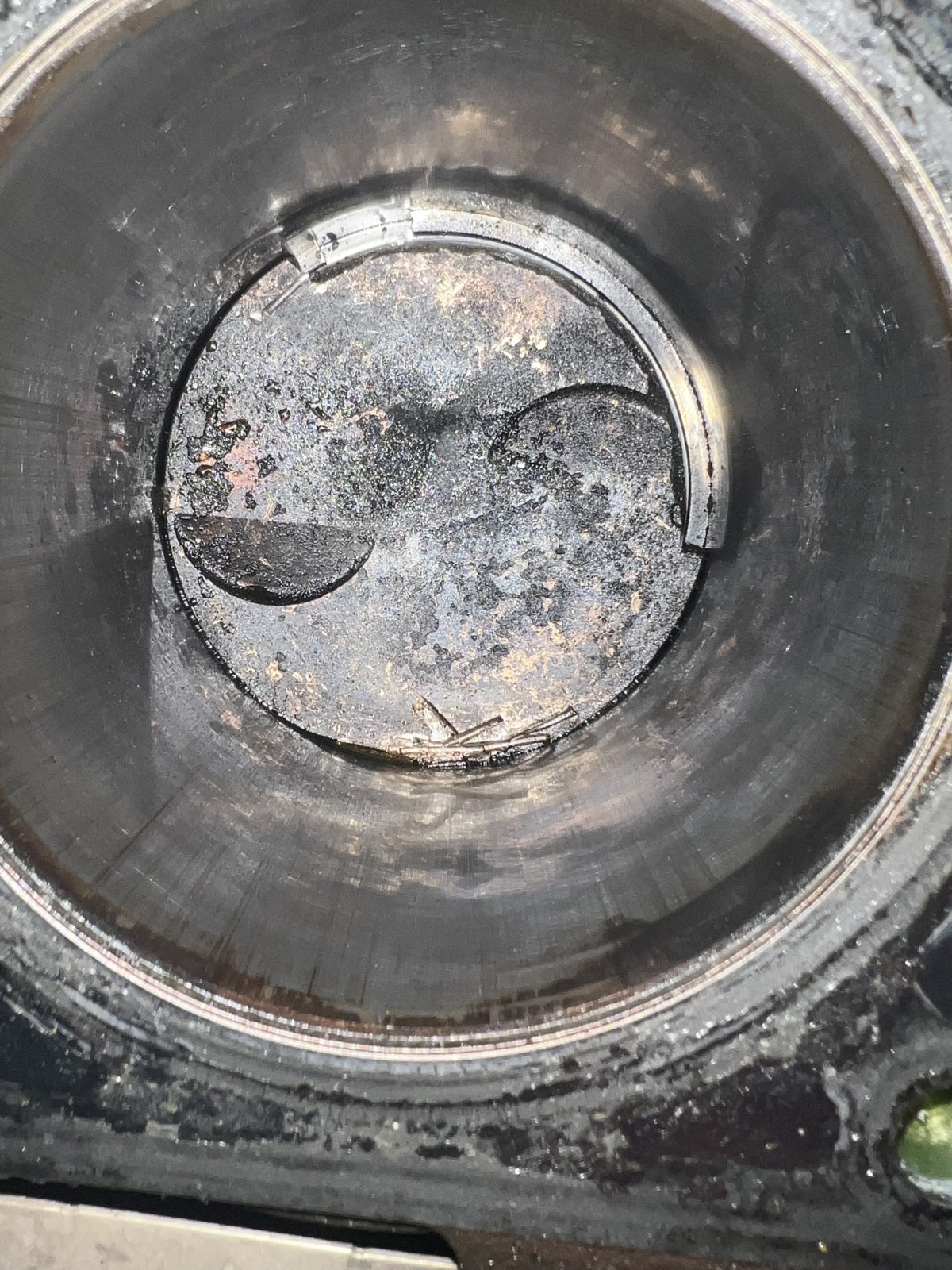

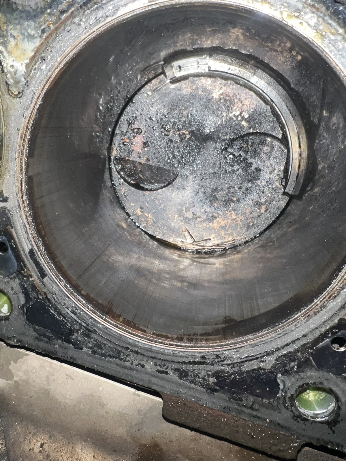

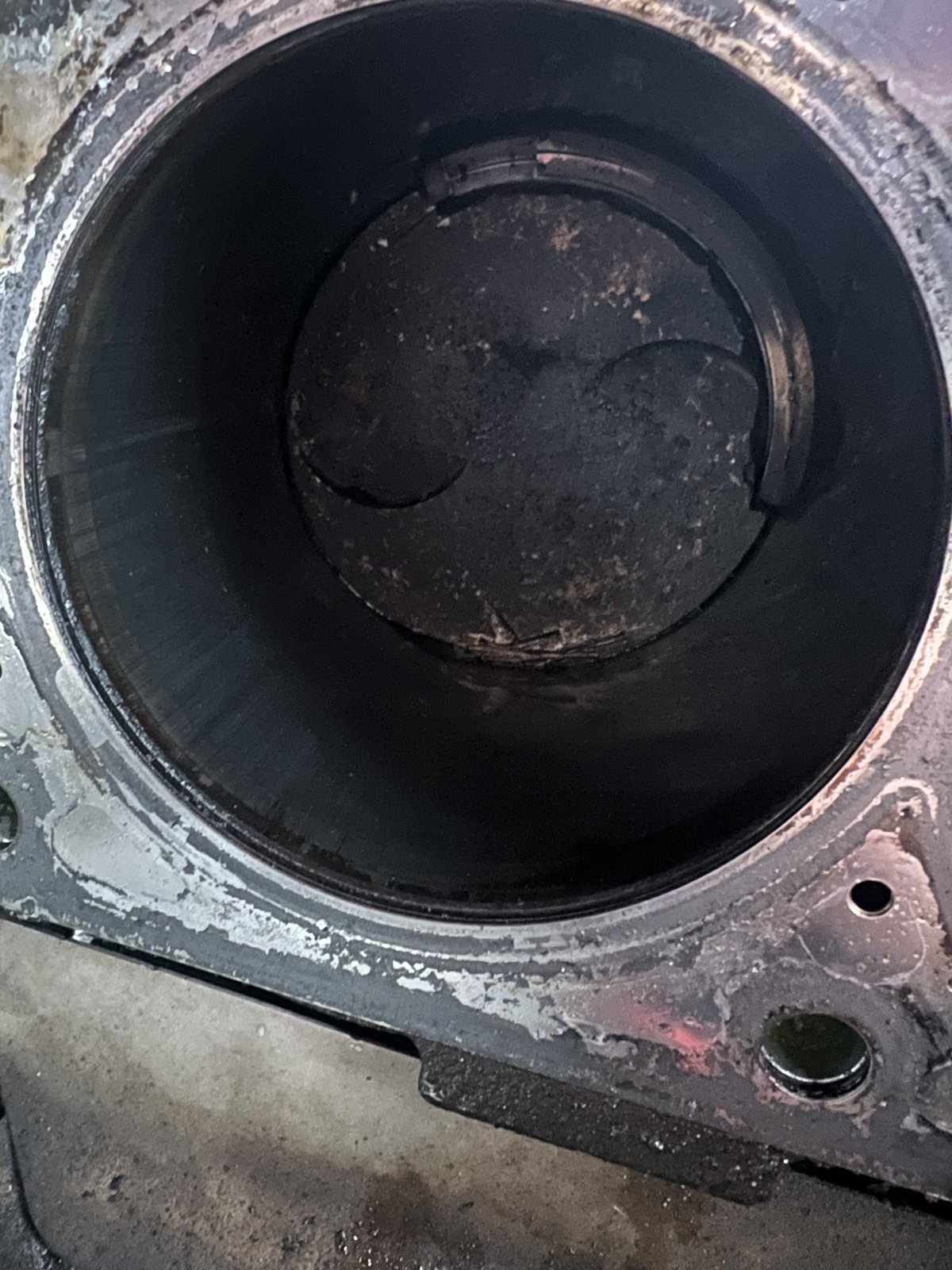

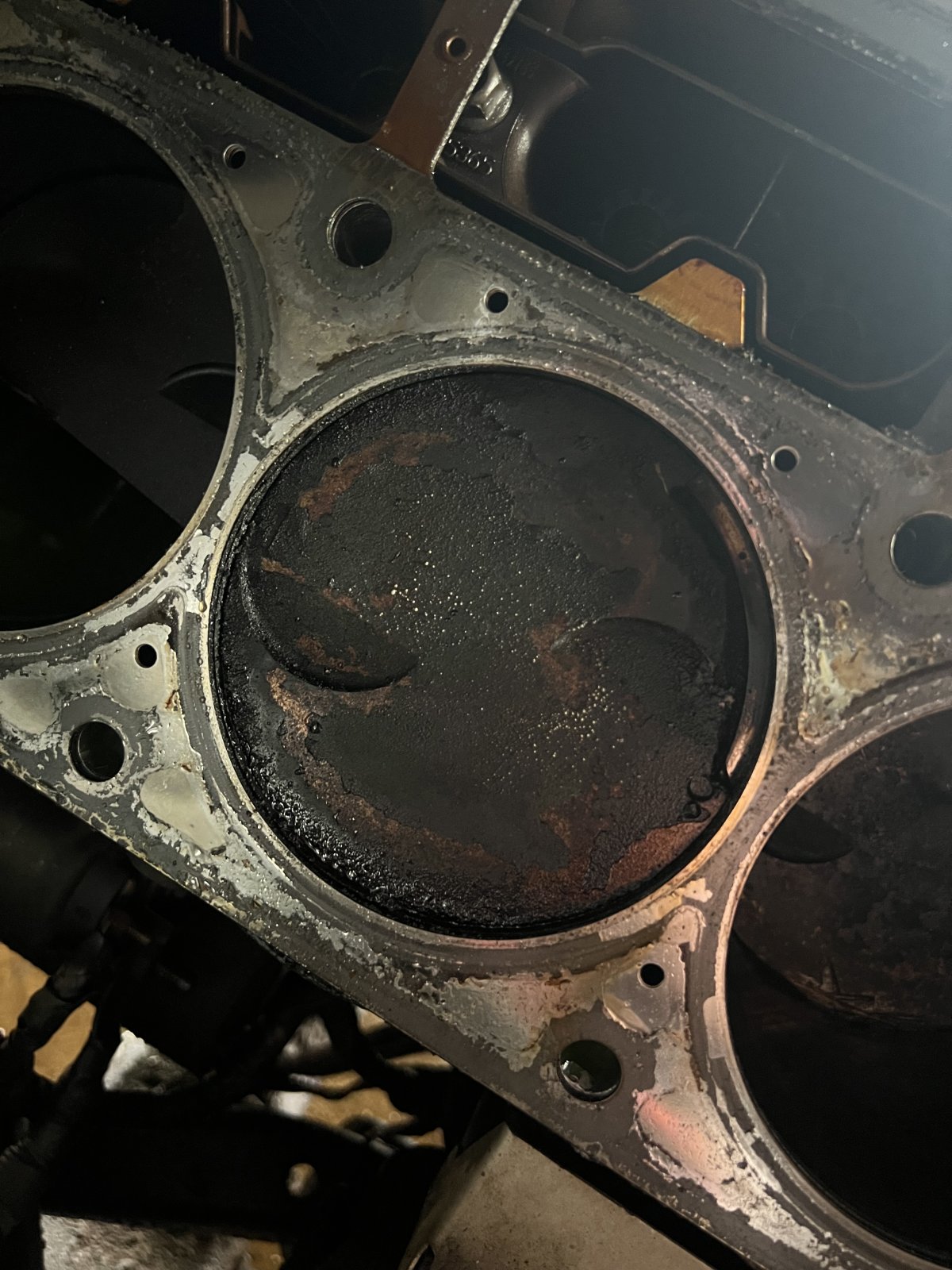

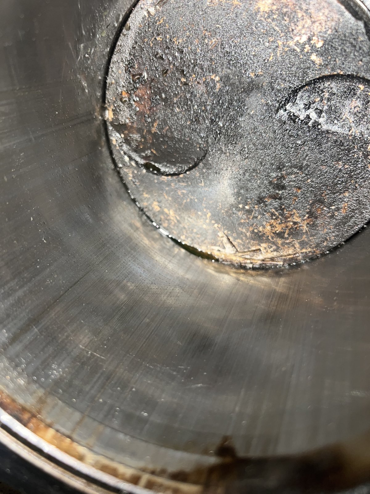

Well so what I was hoping was a lifter problem turned out to be much worse.
I’m amazed that the cylinders are still in such good shape. All the marks on it I can’t even catch with my finger nail.
So I think the best plan of action is to just have the cylinders honed and a new set of pistons. I already have new lifters to go in it.
New oil pump and new cam bearings while I’m there.
This is cylinders 4 and 6 I only had a misfire on cylinder 4 though

I gave your photos a hard look, I am wondering how the piston ring got out of the ring bore and on top of your piston with no holes in the block or pistons? Your cylinder head probably shows the impact marks from the ring impacts.
I’m wondering the same thing. I honestly don’t know how it didn’t damage the cylinder. It’s the lightest scratch marks. I can barely feel it with my nail.
Yes there is marks in the cylinder head that match the piston.
Cylinder 4 was the only one that was misfiring. But there was a massive amount of blow by.
I’m trying to decide if I’m going to hone it my self and put new pistons in or if I’m going to take it to a machine shop. I’ve definitely seen worse and honed with new pistons and sent it.
Either way here’s where I’m at
New pistons
New cam bearings
New hv oil pump
New lifters and trays
Hone the cylinders
Shave the heads
When I bought this it had oil consumption and I thought it was just the normal stuck rings now I’m thinking someone ran low octane for a long time and hammered the pistons with detonation but the others look fine only 4 and 6 are bad doesn’t really make much sense
