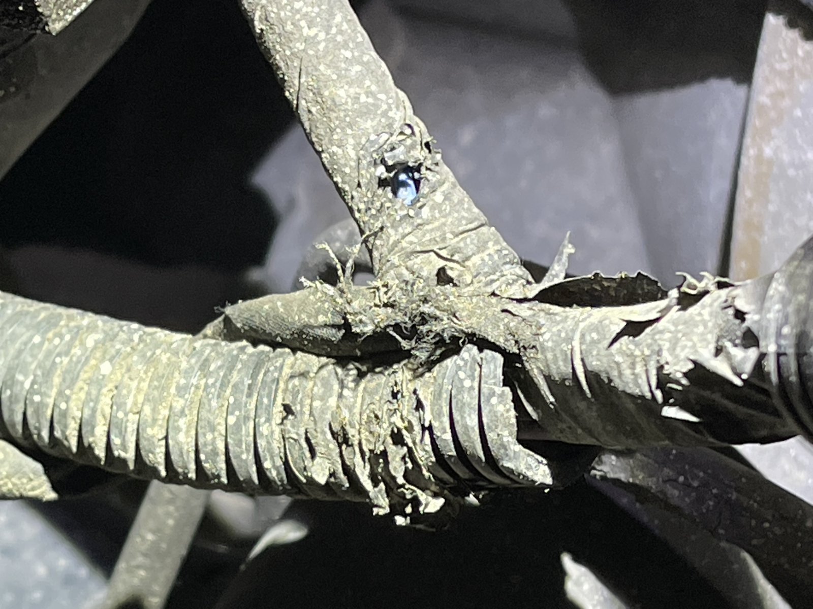

my 2010 had a strangely similar issue once, I'd circle back to that bundle of wires near the power steering pump. I've seen a few threads out there on the internet about those wires rubbing through and shorting, and the weird nature of this one feels very similar. Your P219A could also be indicative of an issue with that side's injector's harness. I'd get the pin outs to the ECM and ohm the connector from the injector harness to the ECM and with your meter connected I'm betting you will see the issue if you jiggle that harness by the power steering pump.

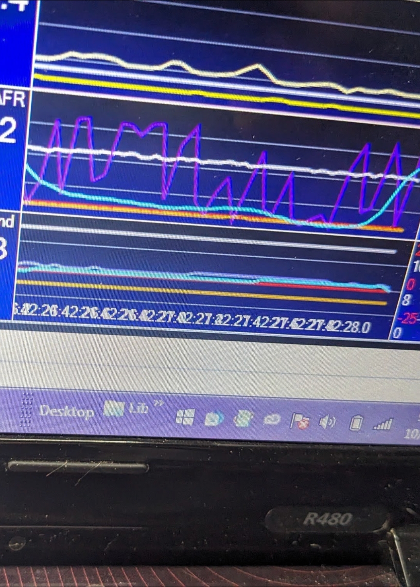

well #5 did have carbon on the plug and running rich.
but if you could graph o2 voltage to confirm. that would be handy. here's what a high ohm injector looked like on my ls3 car. no miss or any signs till I happened to see the o2 volt on in a log and started investigating. purple is the saw tooth miss fire, light blue is normal side. it's zoomed in very tight time was in this pic. about 1.5sec full screen width

Is that a scanner with an oscilloscope feature?

hptuners scanner side. it's pretty good for surff like that. they have something to make the update rate much faster than normal scanners. which is needed for capturing fuel trim data to tune off. but side effect is you can log tons of stuff really nicely.
there was a time you could buy just the scanner side. but I don't think so anymore.
