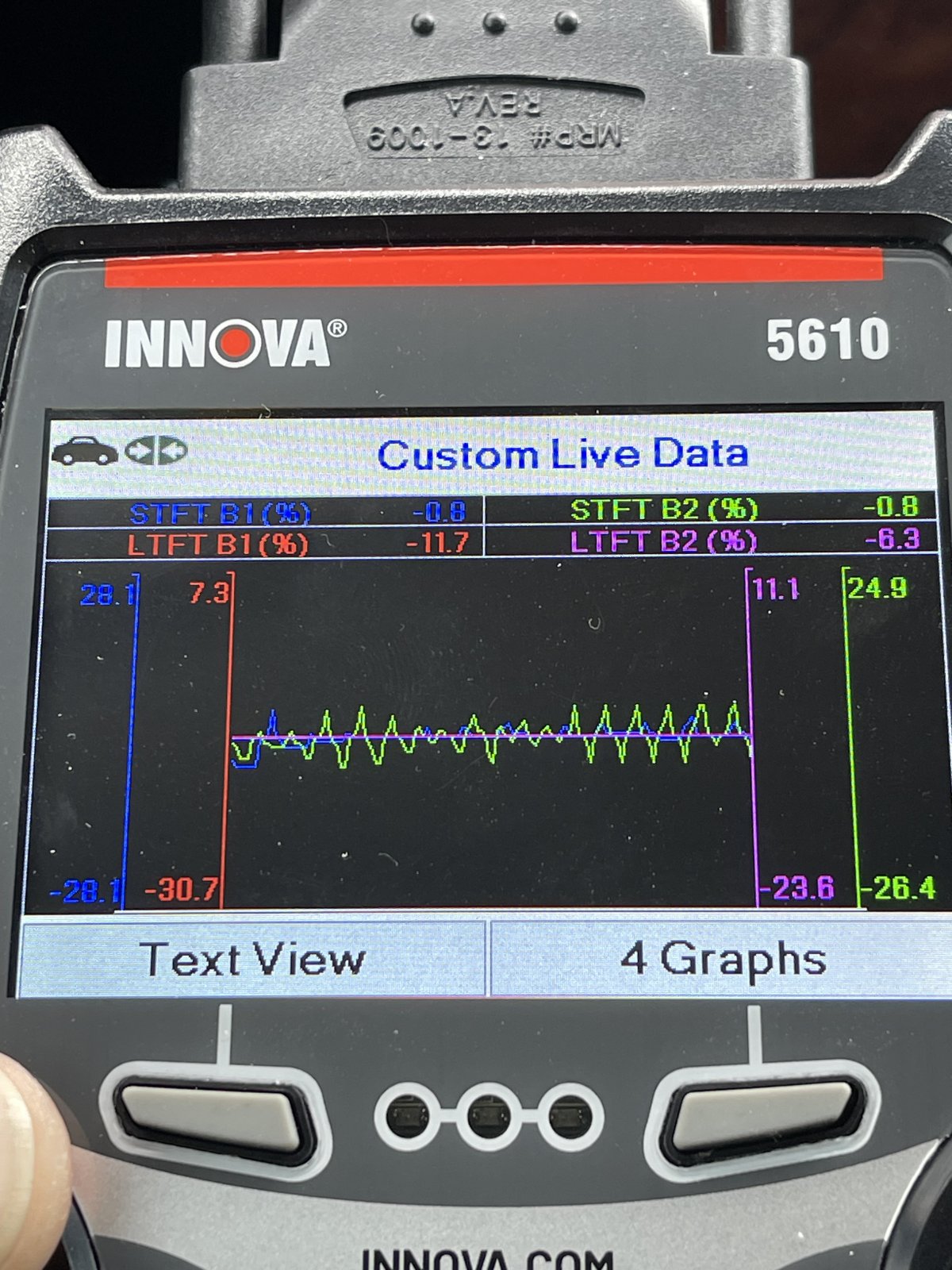

After drive here we’re the fuel trims

Did you try swapping the number 5 injector to another hole? Wonder if the injector is over fueling based on those fuel trims?
j91z28d1
Feb 28, 2022
4,655
5,900
that's removing a lot of fuel from bank one. you like the total to be around 5% long term + short term. you're at almost 20%.
now what's causing it, I don't know.
All the injectors, plugs, and wires were replaced, gave a rundown of all the usual suspects have been swapped then replaced and am down to wiring other than what has been shot or internal failures
Could it be not enough intake valve opening due to cam lobe and pulling fuel? We may find out. I am waiting on a noid light and may be out of other options to check
These things have kinda a noisey valve train at idle when not damaged. I'd be really surprised if you had valve train damage of some kind and it ran smooth and quiet.
but I'm also out of ideas. you'd done really good diagnostic at this point.
I just realized I read that wrong. it's removing 10% from bank one and 9% from bank 2 as well.
so 2 things I don't know if have been asked. will your scanner read alcoholic content? it should be 0-5% or so, if it's up in the 40+ on non e85. that can cause issues and what does you maf read in g/s at idle warm ac off? it should roughly match the exhaust cc.

well knock counter isn't active while missing, and the one plug seems a bit carboned up.
so yeah, this one has me stumped. Just trying to think of the basic stuff missed. something is making the whole engine run rich.
so you replaced injectors. any details on those? other than a oem injector of the same part number, there's a bunch of injector data about dead times and voltage in the tune. even thou they arw the same lbhr rating they can be completely different flow rates without the correct data. of course this doesn't explain the 1 cyl but I could explain the fuel trims.
