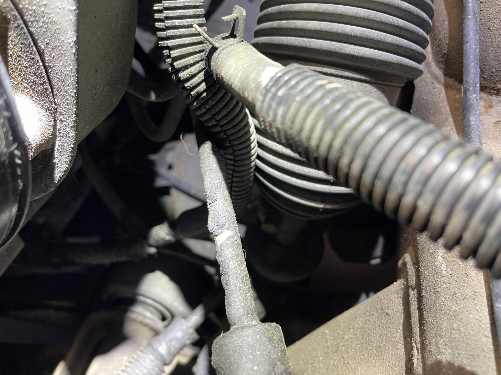

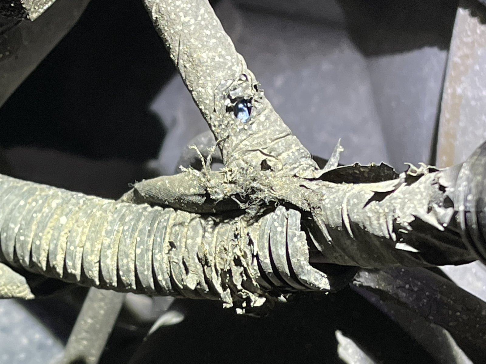

Just looked over wiring and checked for power and ground to the main coil pack disconnect, had both there with key on engine off. Shot for continuity from coil #5 connector back to main coil pack connector and all wires were solid there. Also 12V was solid at first injector connector. I did find some wire bundle with wear indication way down under power steering reservoir also looks like it was misrouted during someone’s previous service work.
