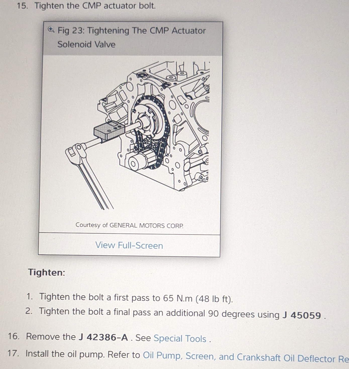

just took a look at my software, it does say replace the bolt, which they call the CMP actuator bolt
tighten it to 48ft lbs and then 90deg.. so yeah it's probably torque to yield bolt.

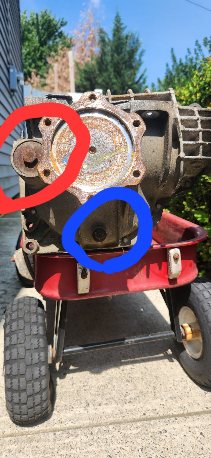

Got another question for you guys. The input shaft seal on the transfer case is leaking so I'm gonna change it before I put it back in and drain and replace the fluid. Having trouble finding a video that shows the type of case that's in my truck. I just wanted to verify the drain and fill holes. I circled what I believe to be the drain hole in blue and fill hole in red. You guys agree?
View attachment 404016View attachment 404017
Yes, the one circled in red is the fill plug. They can be a biotch to get off. Ask me how I know. Soak it with penetrating oil for a while before trying to take it off.
Also, a small point of clarification…that is your front differential, not your transfer case.
Just realized that! Thank you for the info!
