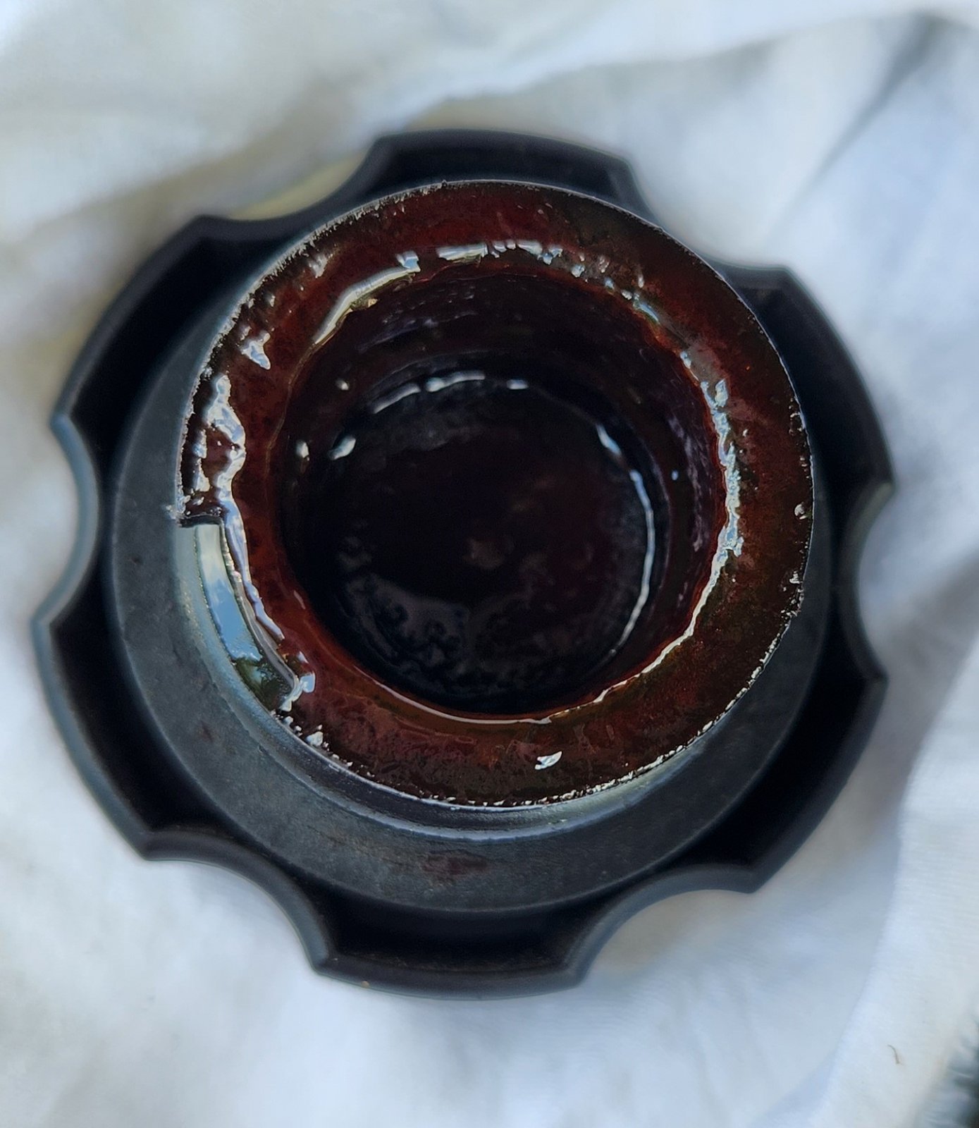

You're doing/planning to do all of the things I would to narrow it down. That cap looks like it's showing signs of dark coolant foaming deposits, so there's that. How does the oil look on the dipstick? There are rare cases of cylinder heads cracking on these - more on the 823 heads on 6.2's between the valve seats than on the 5.3 heads. Head gasket leaks are also rare but not impossible - especially if it's been overheated with doesn't seem to be the case here.
Let us know what the leakdown test reveals. You might be sending the heads out for inspection afterwards. :-(
Oil on the dipstick actually looks pretty good. Definitely not a milkshake. The stores near me don't rent the leakdown tester so I'm gonna have to buy one. Any suggestions? Harbour Freight has one for $80 and Amazon has one for $25. I don't usually like buying cheap tools though.

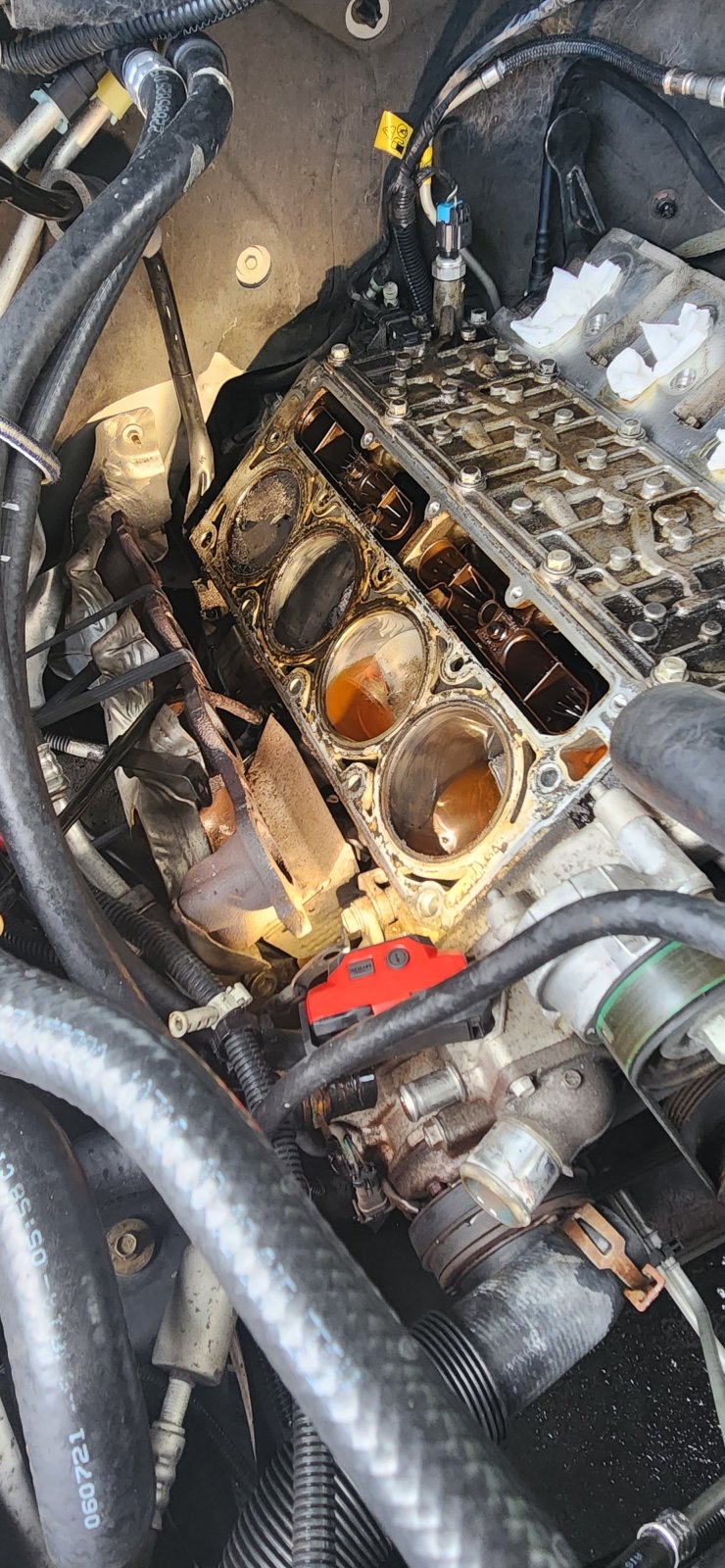

So I rented the coolant system pressure tester and of course the system stayed solid @ 17lbs with no loss for 2hrs so far. I'm going to leave it on all night and see what happens. I did the test on a cold motor. I pulled the valve cover and found more evidence of coolant in the oil with some white sludge under the cover and in the oil fill tube. Also I'm noticing that oil pressure is up which I was told is also another indicator of coolant in the oil. I know there is coolant in cyl 4 so I'm going to move forward with the idea that the leak is only occurring under a certain condition that I haven been able to recreate but either way the head needs to come off. I'm gonna start tearing it down tomorrow and get the head to the machine shop on monday.
Solid plan. Thanks for the update.

Drivers side valve cover...I guess I should do both sides...Money is tight and I was hoping go get away with just the RH side

That is the updated driverside valve cover.
You got a coolant leak into your crankcase.
After you find and fix the coolant leak, cleanup that valve cover (submerged in solvent) and reuse it. Do the same with the passenger side.

Well there you go..I can't believe this thing was actually running...Now how did it get in.
You’re always going to have coolant in the cylinders when you remove a cylinder head. You break the seal between the water jacket in the combustion chambers the moment you pull that head off… And coolant will settle in the cylinders.
You're right. I'm gonna clean it real good, check for cracks and then drivers side tomorrow. I wish I had the funds to eliminate the AFM but that's not happening. Do you think I should inspect the lifters or just leave them be? I haven't had an issues with them in the past.

Check out the difference between left side and right side. Right side is the suspected failed side. Much cleaner thanks to the steam clean from the burning coolant. Another sign to look foe when you're chasing something like this.
