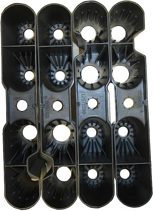

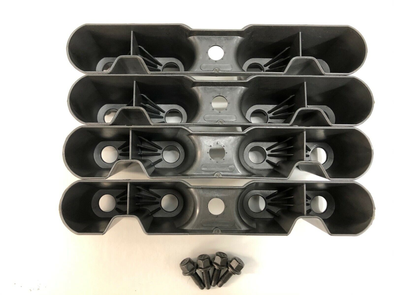

They are different. Here are the AFM trays (note the different hole sizes and ribs)
Non-AFM:
Non-AFM:
Chris, after all these years you think I don't know about AFM trays! LOL I meant that I don't know if there are different trays for regular lifters, the question posed was do GM Performance lifters use different trays. I didn't think so but never even thought to look. But then again my memory is going bad! Who makes those braided brake hoses you like again? LOL I already forgot and you told me the other day! LOL

Oh and here are your lifter trays,
:ehcapt:

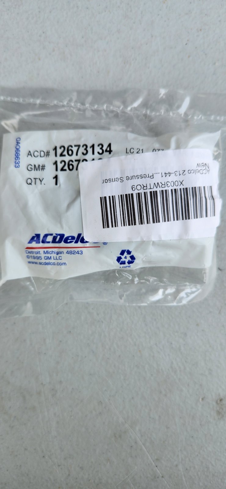

Thanks man. Just ordered them off Amazon and they claim they will be delivered overnight by 8am tomorrow which is crazy. I verified they are GM genuine. I'm gonna keep the AFM trays I ordered since I suspect I might need them when I start dealing with my 08 Yukons misfire. Just an FYI the Amazon AFM trays I just got where legit GM genuine parts but you have to look real close when ordering. A lot of vendors are trying real hard trying to disguise knock off parts as GM originals using deceptive phrases and copying GM part numbers.

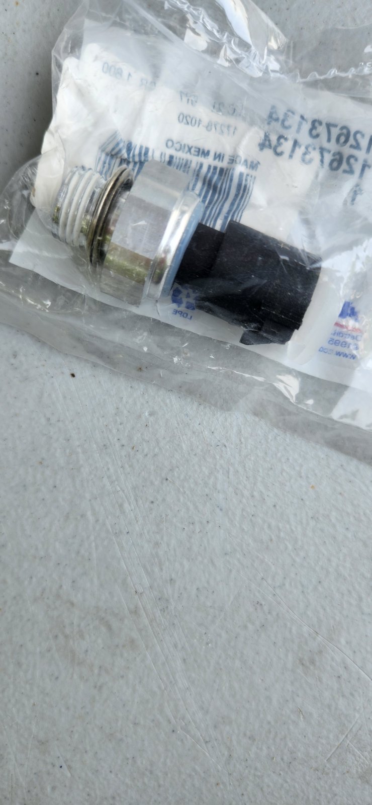

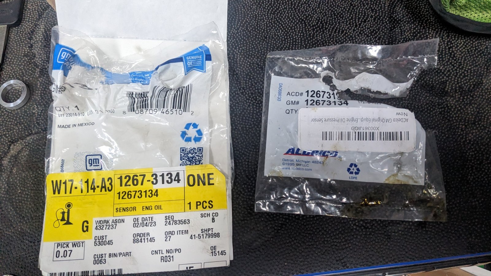

again.. you might never have a issue. but just incase.
the failed Amazon on the right, looks like a old school Delco bag. on the left is from the dealer, newer light blue bags
So the question now is do I put it in or keep my 170,000 mile original one which has never given me a problem whatsoever. I've been messing with both my trucks so much lately I honestly feel I could pull the intake in like 20 minutes so if it does go bad it's not the end of the world.
