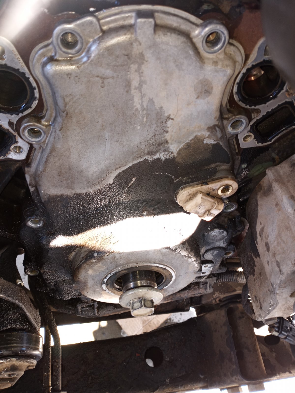

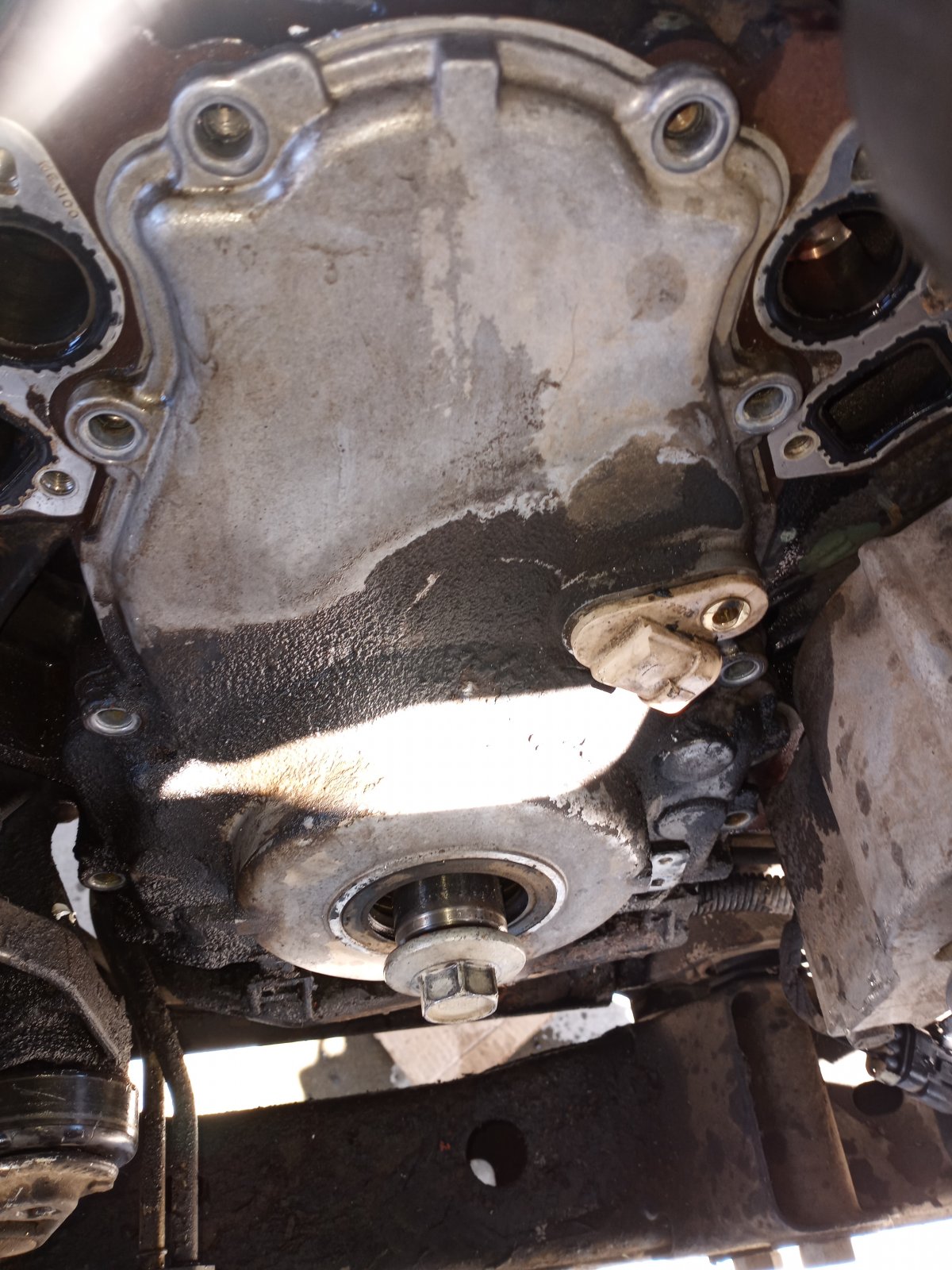

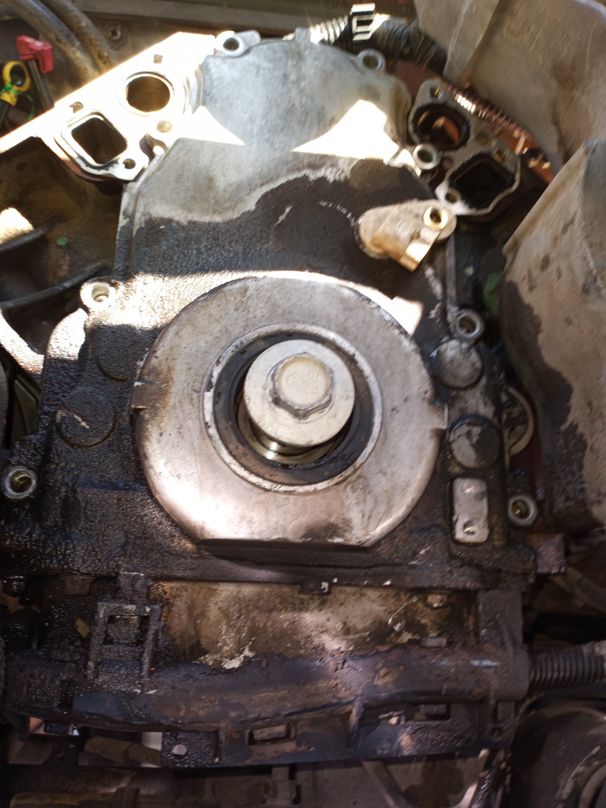

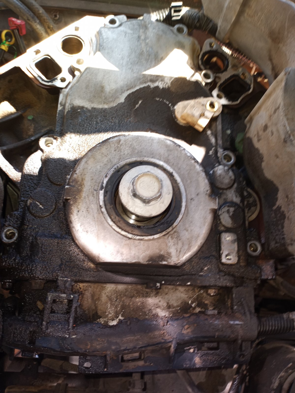

Still waiting for parts guys. Have pulley and water pump off. Removed 8 10mm bolts on the timing cover but it isn't budging and I don't wanna have to pry more. Would two oil pan bolts be bolted into the timing cover? Chilton only refers to 8 bolts which are removed.
View attachment 272849 View attachment 272850
Yes, there are 2 bolt that go through the oil pan up into the bottom of the timing cover; you have to remove them.
Also, you'll probably want to remove the crank bolt to remove the cover, if not it will/could damage the crank seal..........but I will recommend replacing that since you're in there or the new cover should have one in it already.

Thanks for the quick reply. I just removed the bolts. New crank bolt on the way already order. I have the old one in to get back to TDC.
