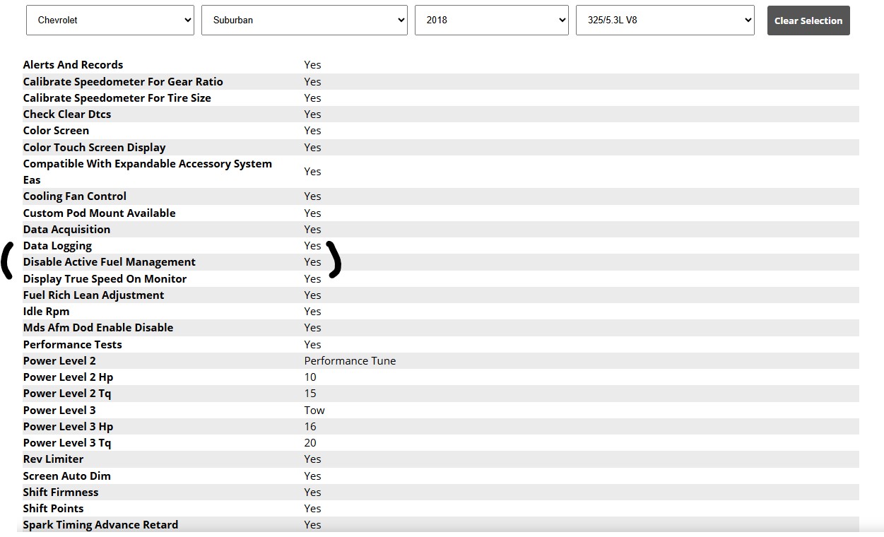

GSP Blue Yukon
Dec 16, 2021
Screen shot of Edge options...
