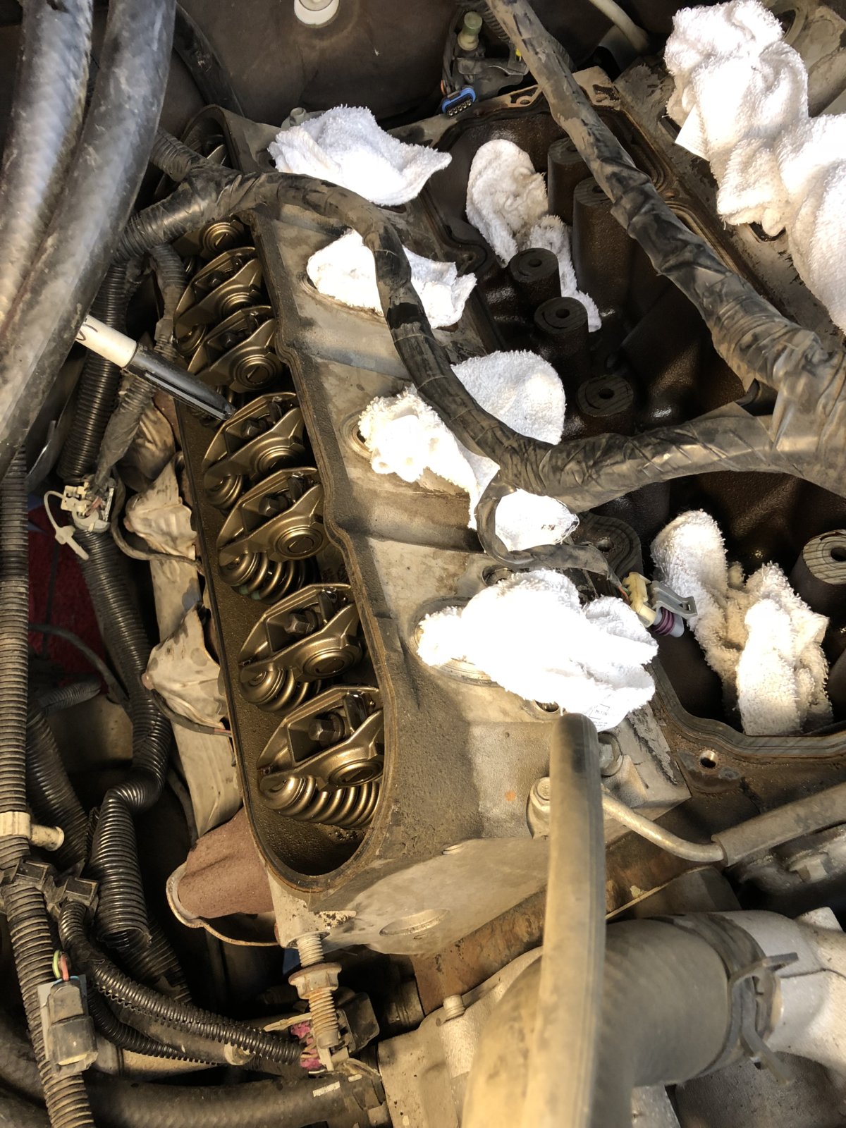

Ouch

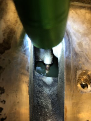

Was about to get everything back together and noticed the #4 intake valve chamber on the head is holding about a cup of coolant.
Ouch
Guess I’ve got crackedhead or popped a head gasket.
Crud
Boohoo
B
buddyhotrod
Aug 12, 2018
90
88
Good Morning Ron
The cup of fuel was likely because of the #4 intake lifter being collapsed and the injector spraying but the valve was not opening, so the fuel just kept adding up.
I suppose the collapsed lifter was the intake side and not the exhaust side.
Im not even sure.
Today everything should be back together and running, so we shall see.

Good Morning Ron
Im not even sure.
How did it go? I've been following your drama!

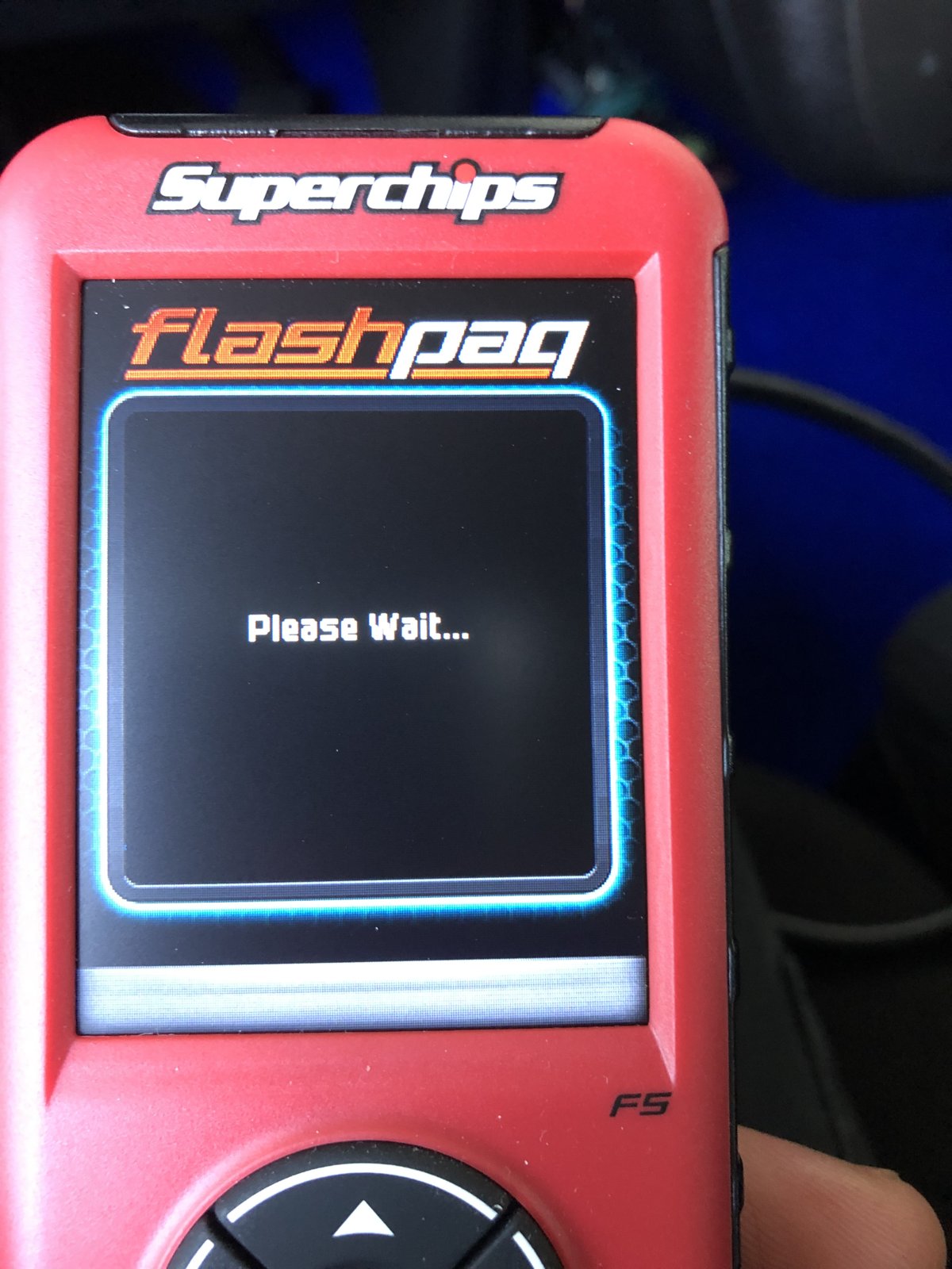

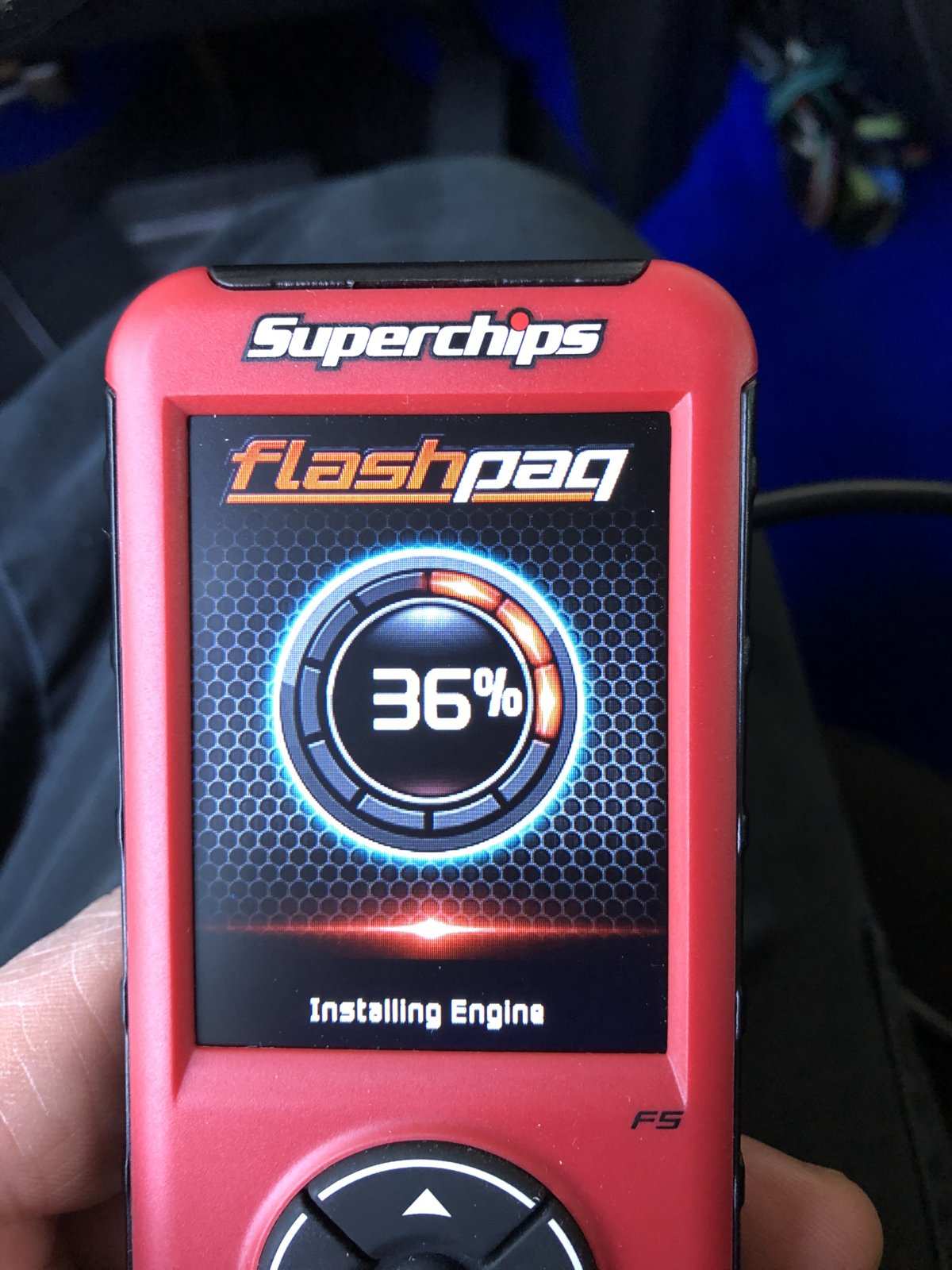

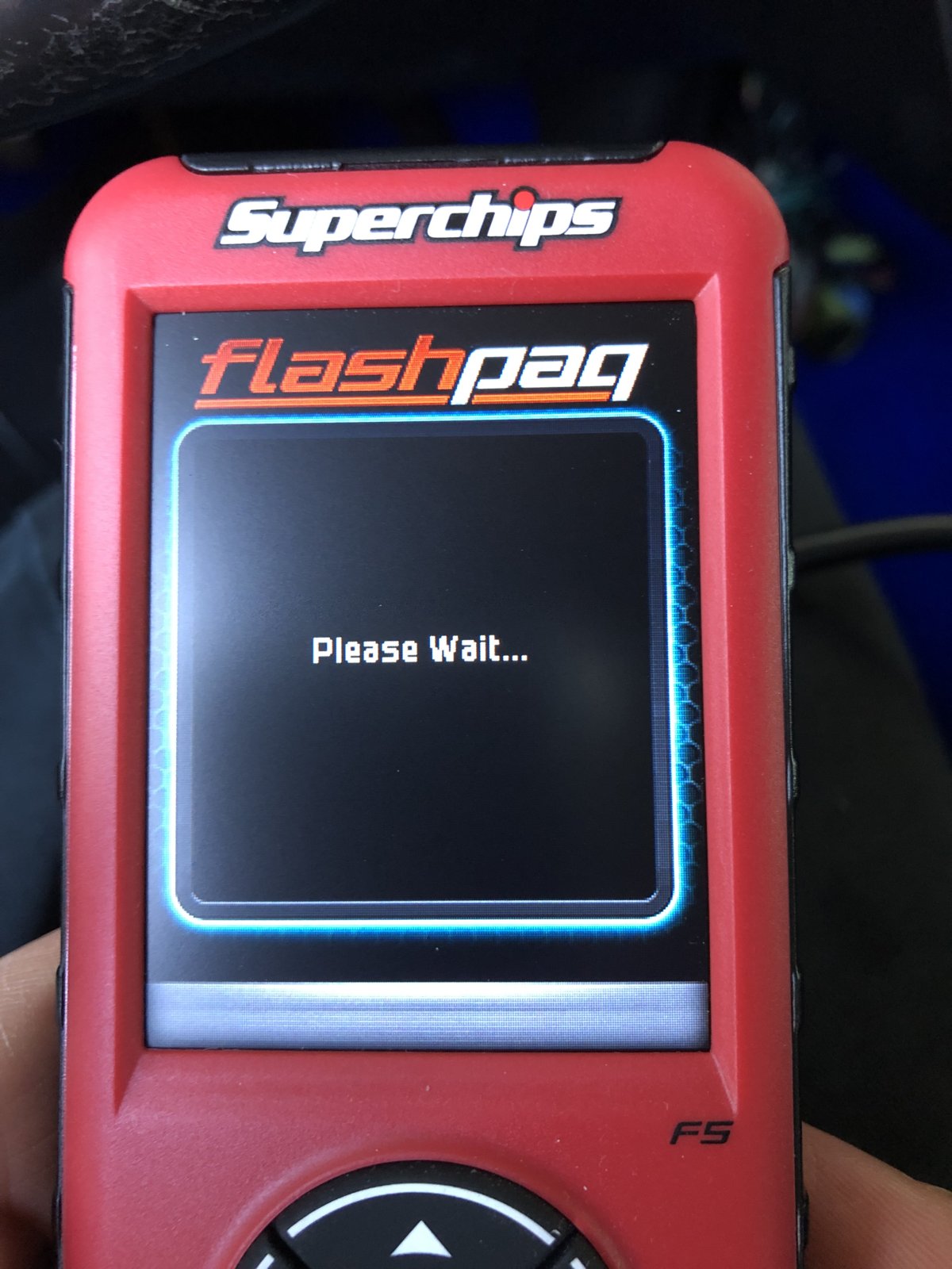

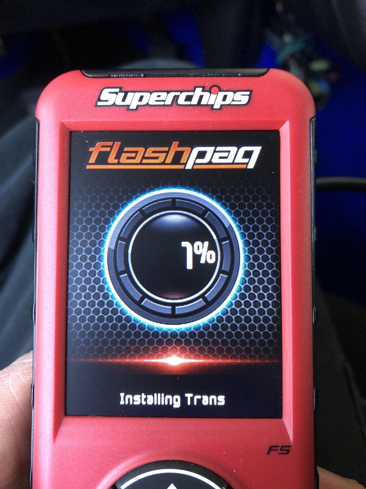

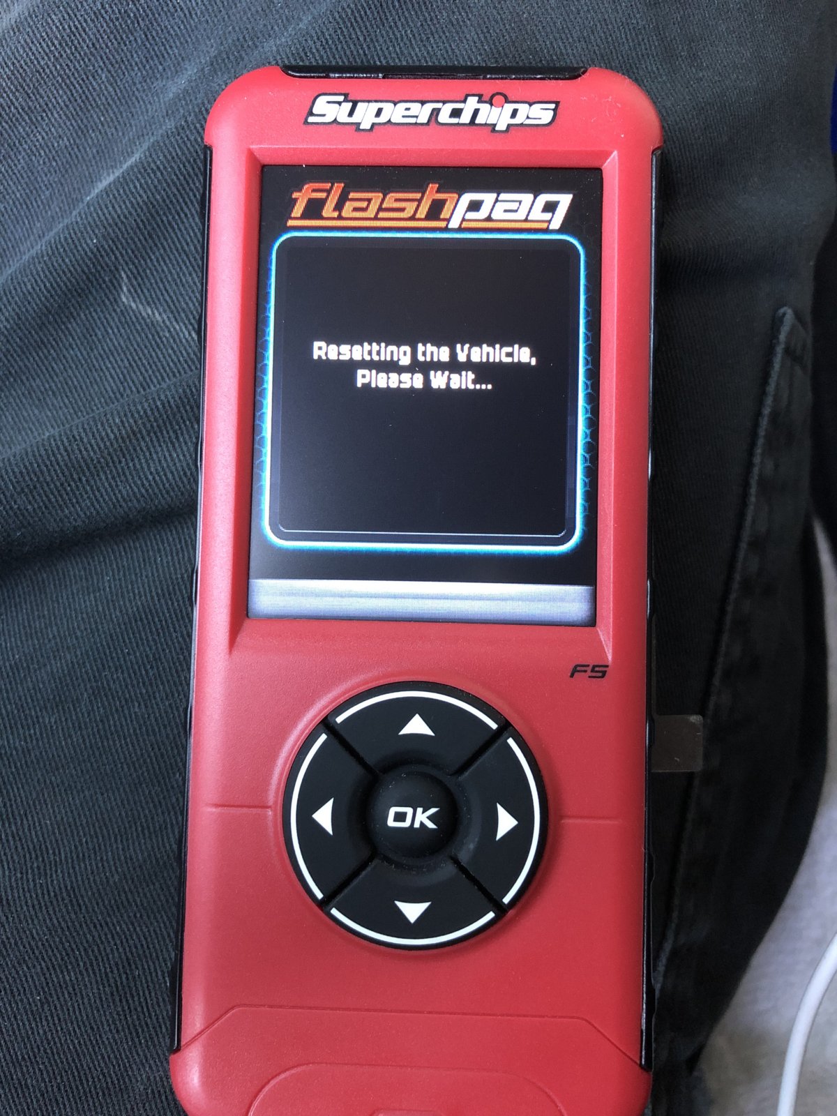

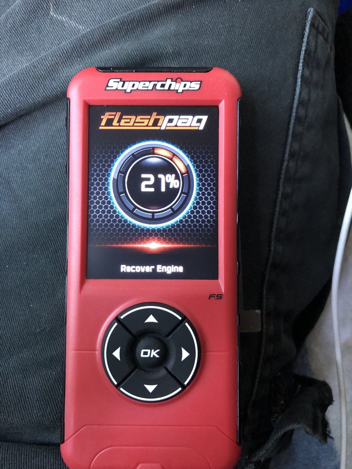

All back together up and running just fine.
Used the superchips flashpaq 2845 to disable the AFM and I gotta say the stupidchips programmer is a joke.
Takes nearly 10 mins to make small adjustments.
Zero performance at all.
Sometimes when using the programmer just to make sure the AFM is still disabled the entire thing would upload a new tune and put the AFM in enable mode.
Damn near ran the batteries down in the Tahoe after 40 plus mins of programming.
Key has to be in the run but not start position for programming.
Cant decide if I should send it back and look for another type of programmer.
Superchips flashpaq 2845 seems like complete junk.

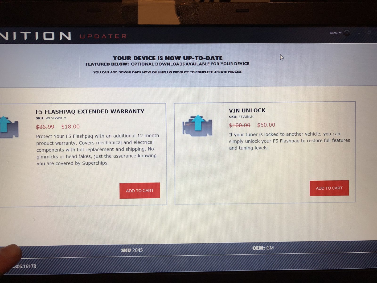

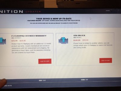

The manual kept saying to be sure and plug into your computer to download the newest updates but anytime you plug it into the computer and fill out your name and info all you have is a screen of for things to purchase for your scanner.
