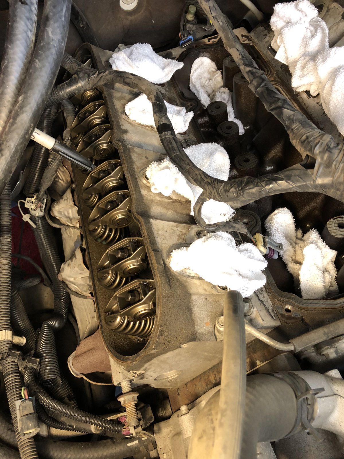

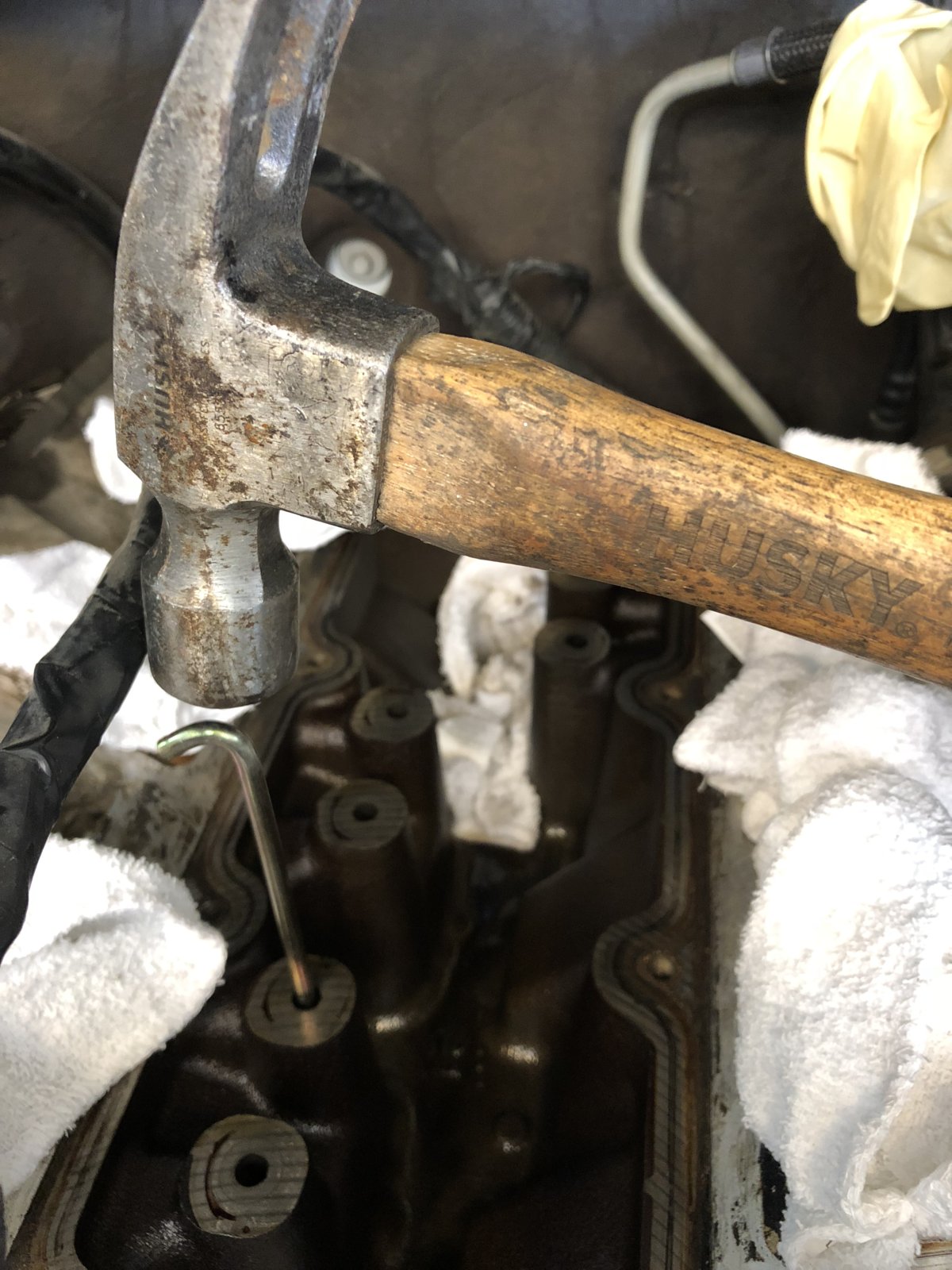

Collapsed Lifter for exhaust valve on #4.
Pulled the intake and was able to get the lifter back in place with little tap trick.
The exhaust valve rocker was completely loose.
Now just need to decide on a AFM OBD disabler.
Also waiting on new gaskets.
Amazon has a AFM disabler that plugs into the OBD but Not sure how that will work when it comes time for the States OBD inspection.
Perhaps a OBD splitter would work.
Need to do some more reading.
Also open to any tips.

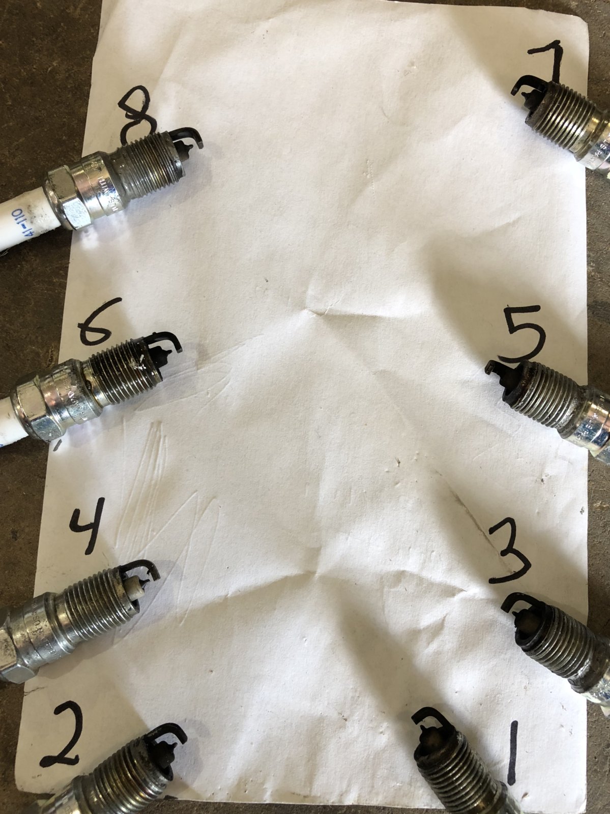

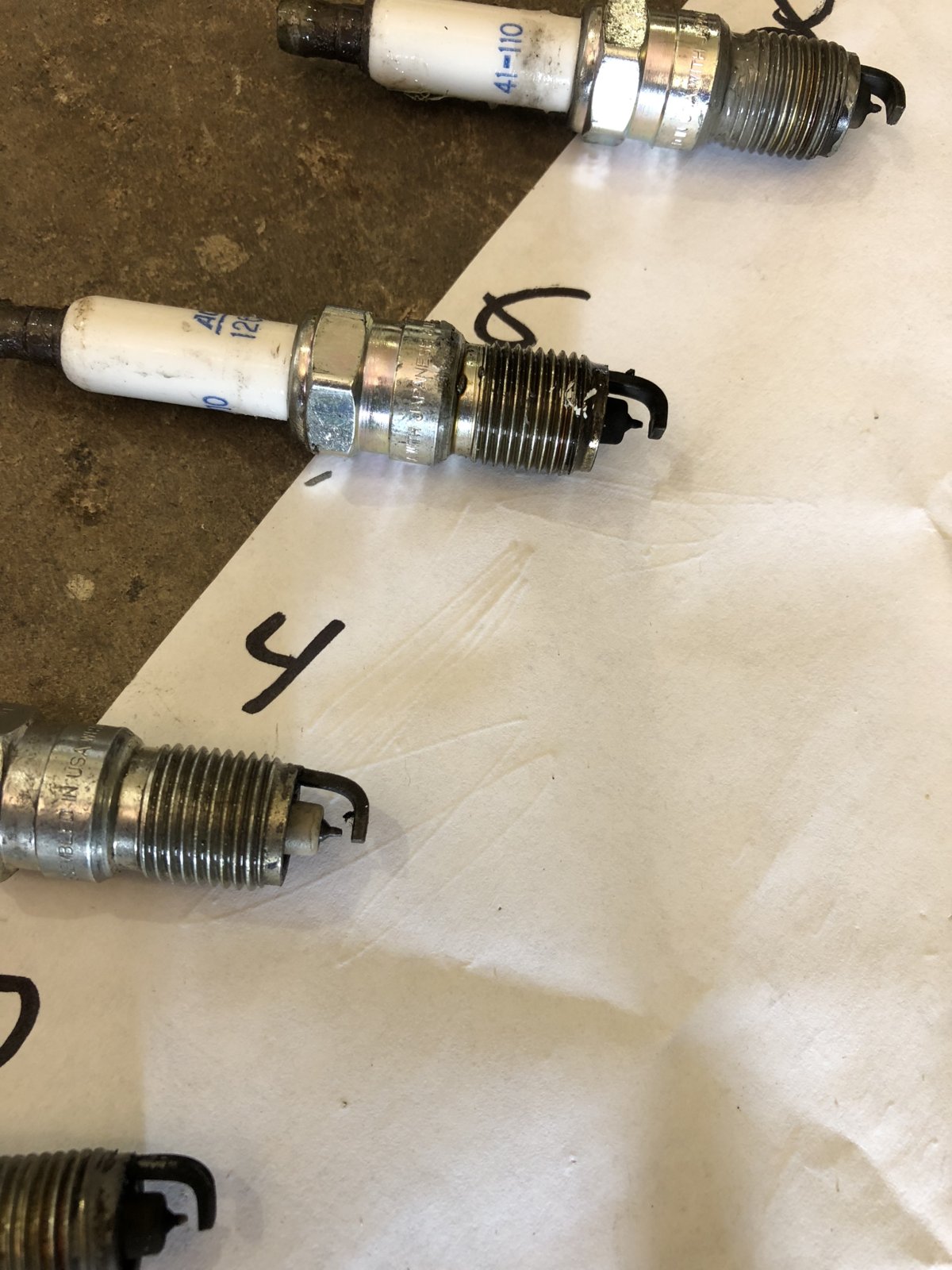

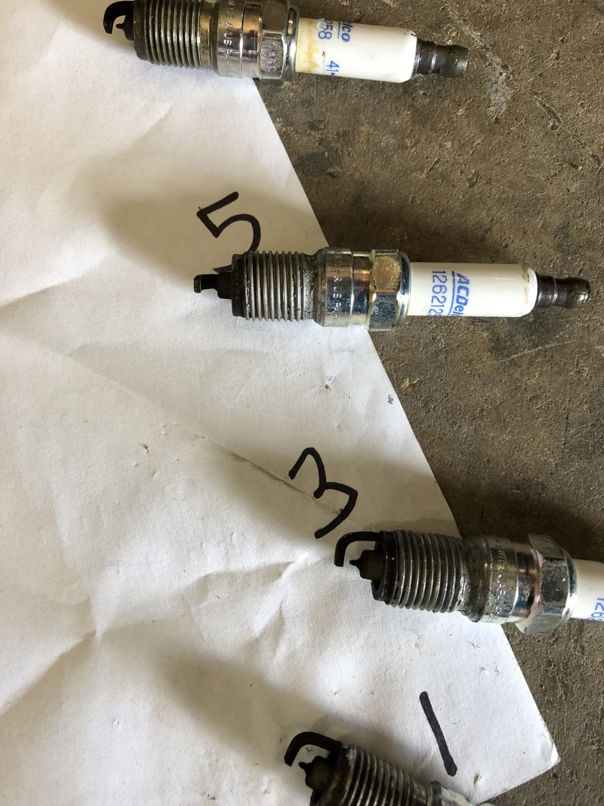

The spark plugs have about 1000 miles on them.
Anyone think they look odd?

A plug-in AFM disabler won't affect anything with your inspections. Just remove it before going to get the inspection so they can plug their computer in the ALDL port then plug it back in when you leave. Since you asked for tips, I'd say that since you're already that far into it, you may as well pop off the heads and valley cover and replace the lifters and VLOM ("valley cover") with the newer/updated designs. If you wanna go a few steps further and never have another AFM-related failure, replace the AFM parts (lifters, VLOM and cam) with their non-AFM counterparts, then get a tune to turn off AFM. Of course, this is much more involved. But, just replacing the AFM lifters isn't much more work than where you currently are. That lifter collapsed once and I don't see what would stop it from happening again soon after you put it all back together and start it.
Considering the way the PCV and AFM system dumps oil into the intake and combustion chambers, I'd say the plugs look about as expected. You may wanna add the updated LH valve cover to your parts list for it's revised PCV design.
