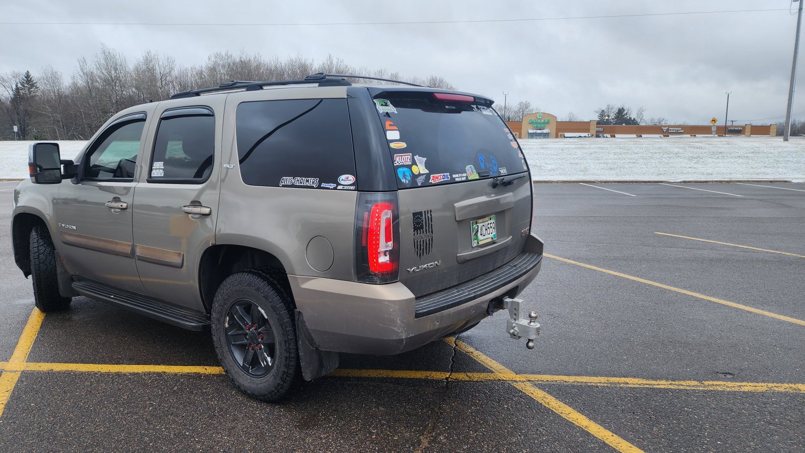

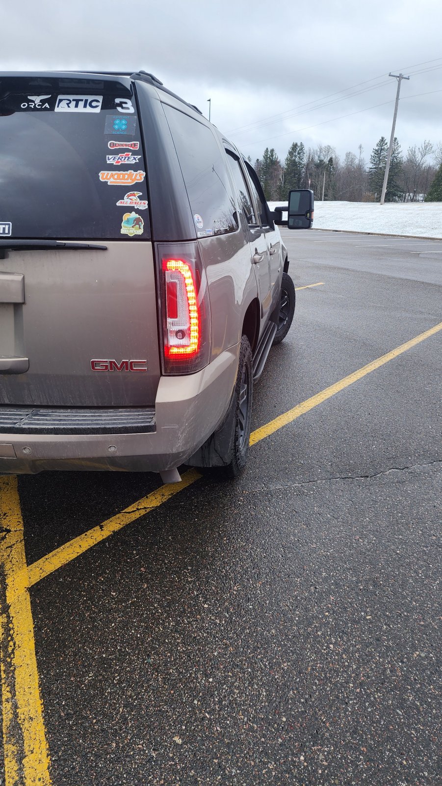

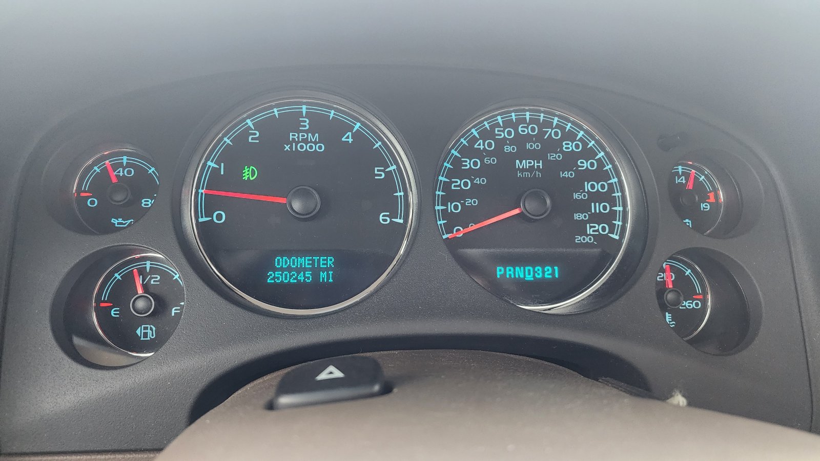

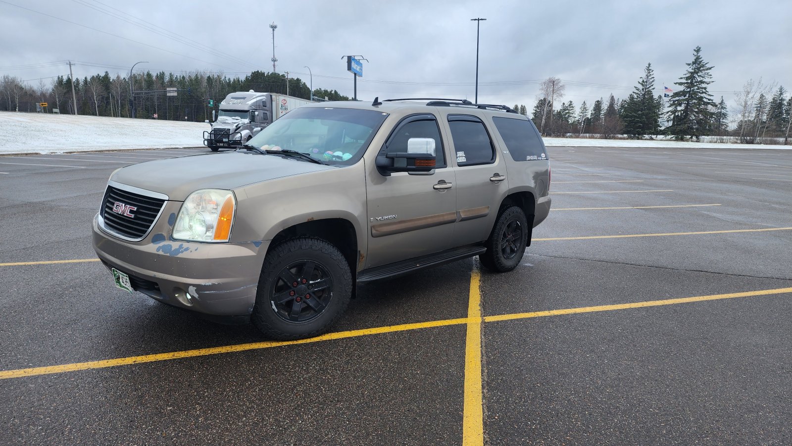

When i found this forum, i didnt know what to expect, but it has so far, completely amazed me at the wealth of knowledge, here is my Yukon, its seen better days, but its the family rig and my daily driver. Ive done some work, and have alot more to do. As soon as i get the motor issues figured out, i can continue cleaning her up, and make her look nice again!
