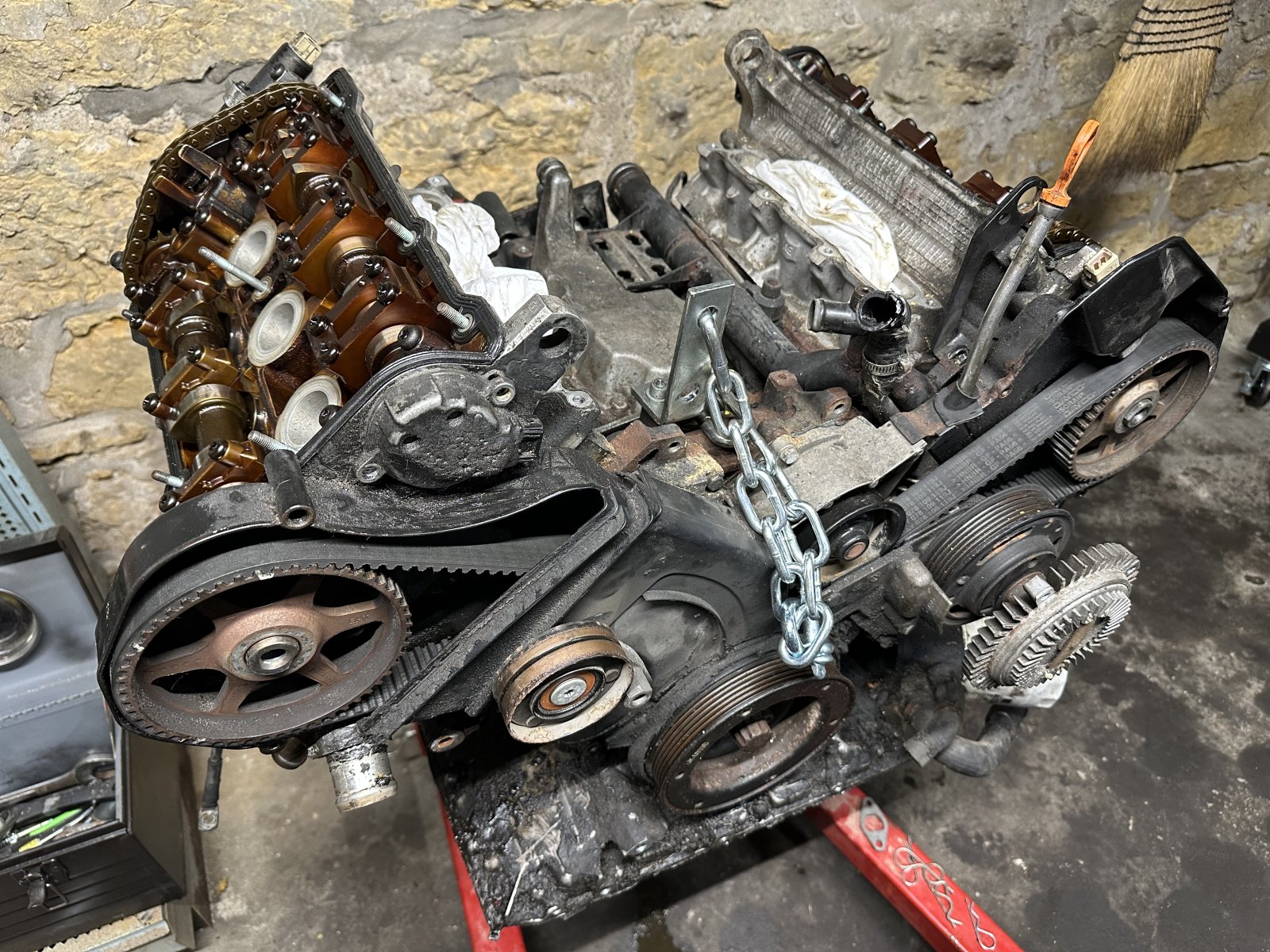

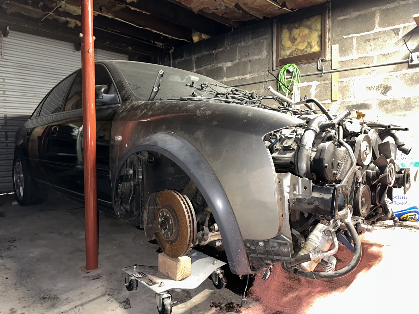

My Audi is twin turbo, AWD, and manual trans… There are very few cars in that category. Not to mention Audis don’t rust.
They are definitely maintenance-intensive, but they aren’t unreliable if you are willing to deal with all of the tedious work.

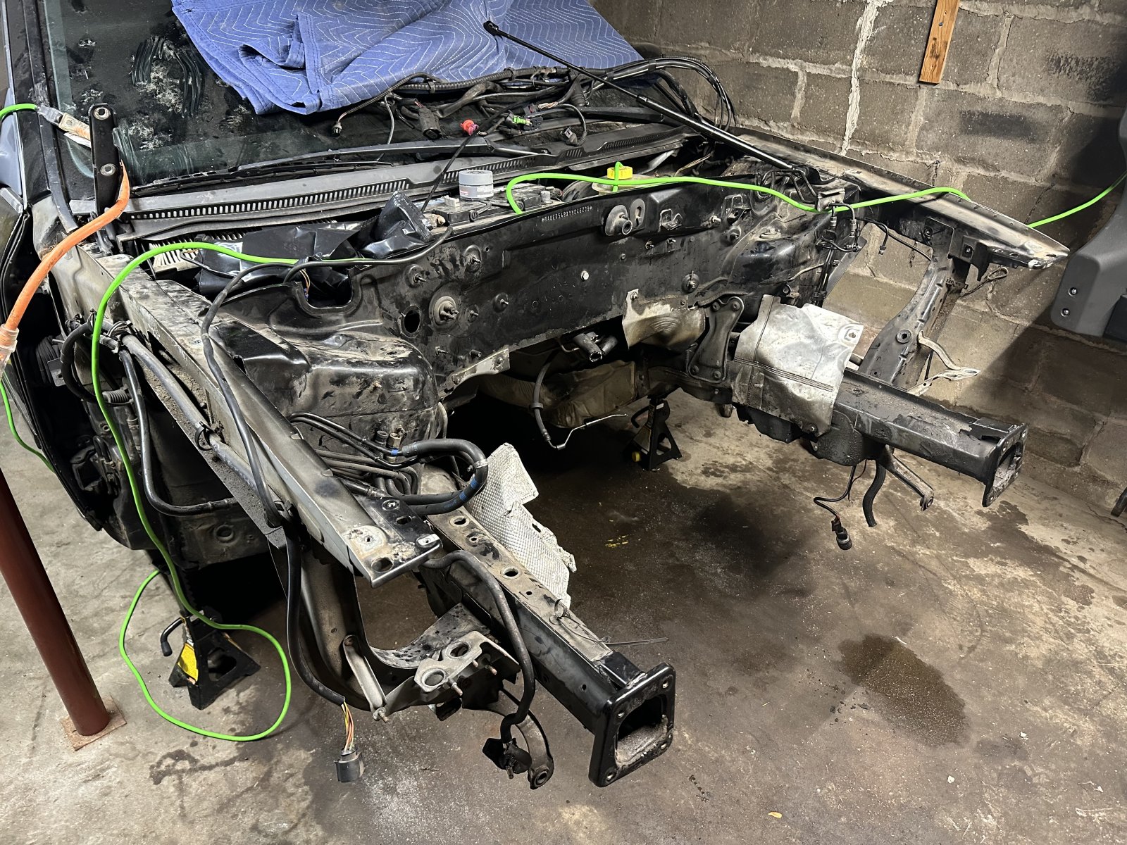

I already have the car completely torn apart and the engine is on a stand. I’m about to run 20 psi on an engine with 250k miles.
I’m also doing a wide body conversion with Allroad parts… I’ve only seen it done in Germany… I don’t know of any Allroad-swapped sedans in the US.
I have bigger Audi plans down the road but I will keep quiet until I’m at that point.

Just keep in mind that the game plan changed a little bit along the way, so the introduction post isn’t completely accurate anymore.
I got brand new turbo cartridges from Mellet in the UK and I’m now completely overhauling the engine as far as gaskets, seals, and all maintenance items.
I will be running an old forum tune that is basically aimed at pushing the stock K03 turbos as far as you possibly can. The tune peaks at 20 psi and tapers to 15 psi. I should be well into the mid 300s as far as power, and the car only weighs like 3800 lbs. Oh, and it has a Torsen-based AWD system that is 100% mechanical.
Additionally, the 2.7T is a great example of how peak horsepower and torque numbers don’t tell the whole story. You can feel it when you drive the car. A stock 2.7T makes it’s peak 250 ftlbs at only 1200 rpm.
