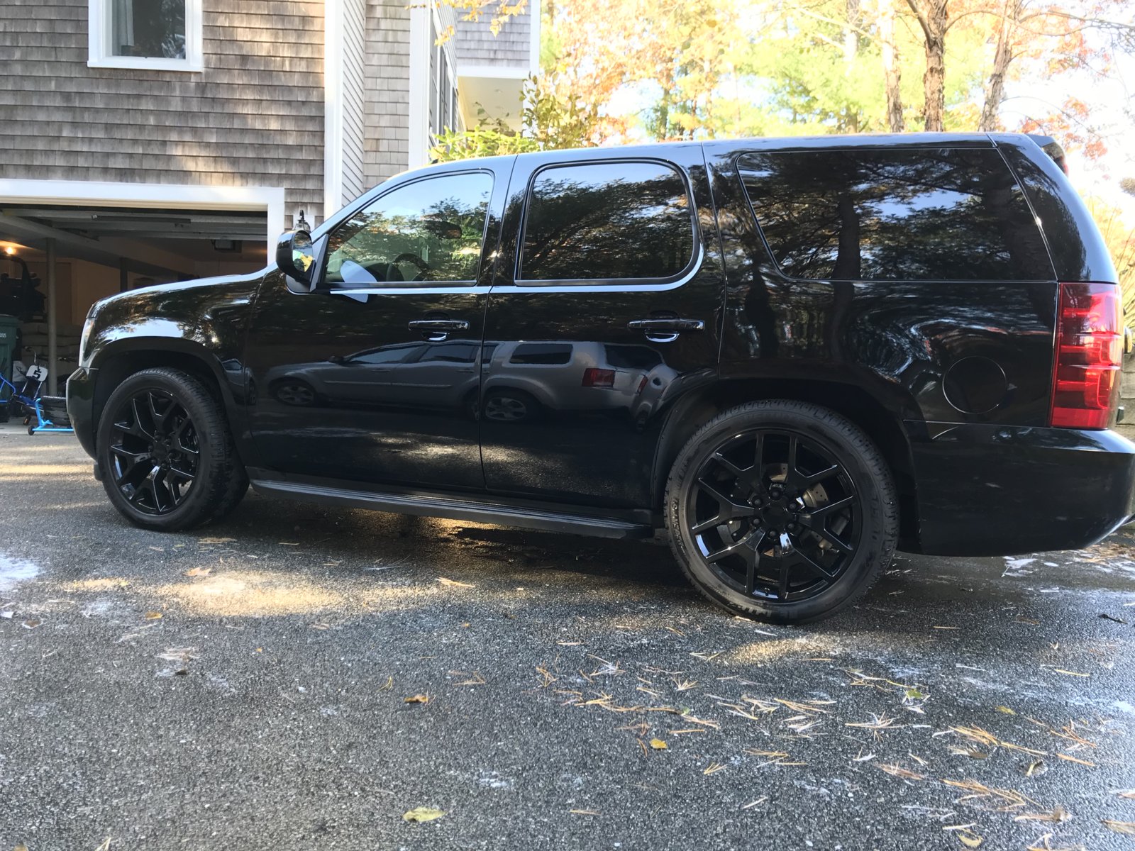

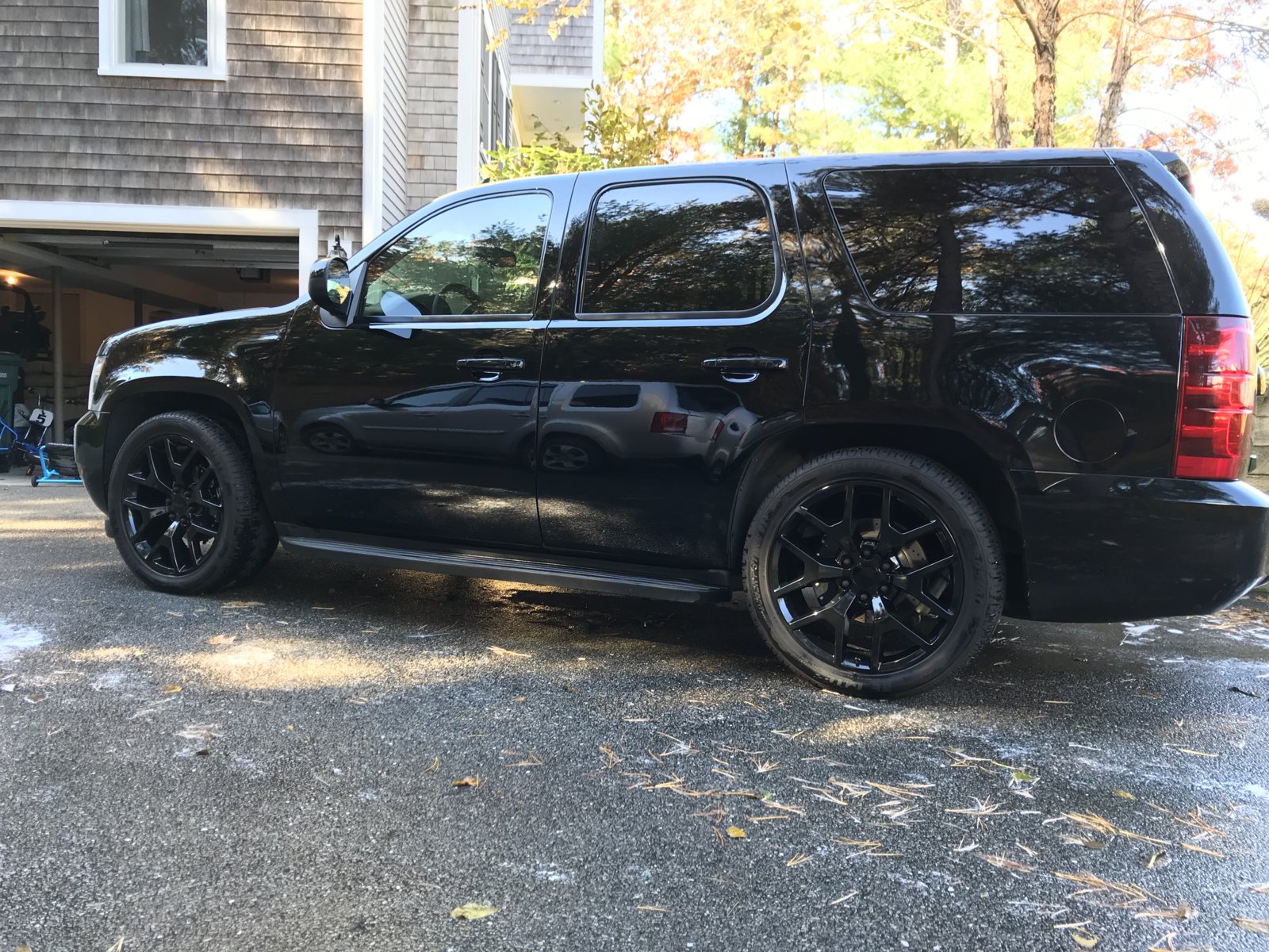

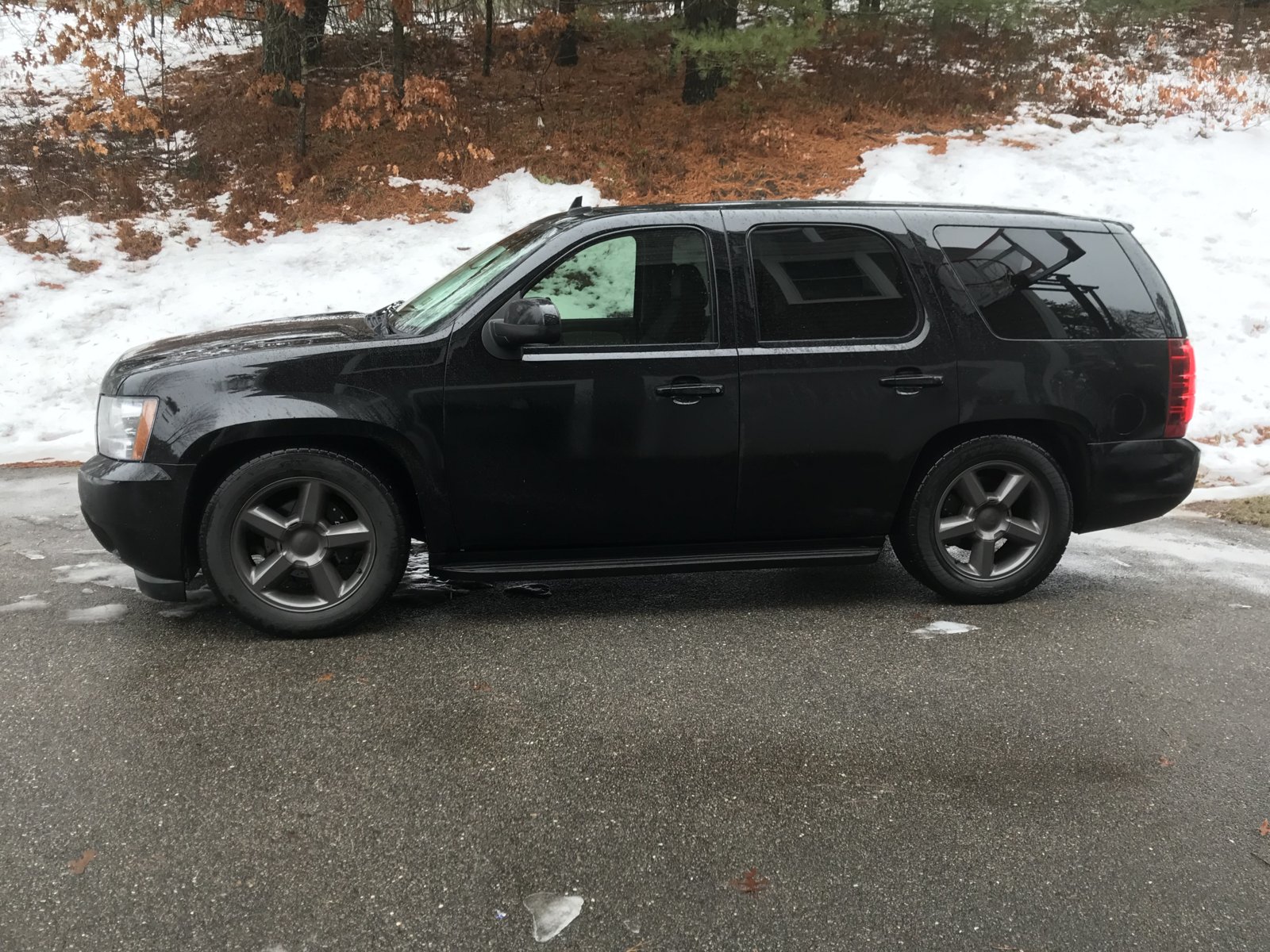

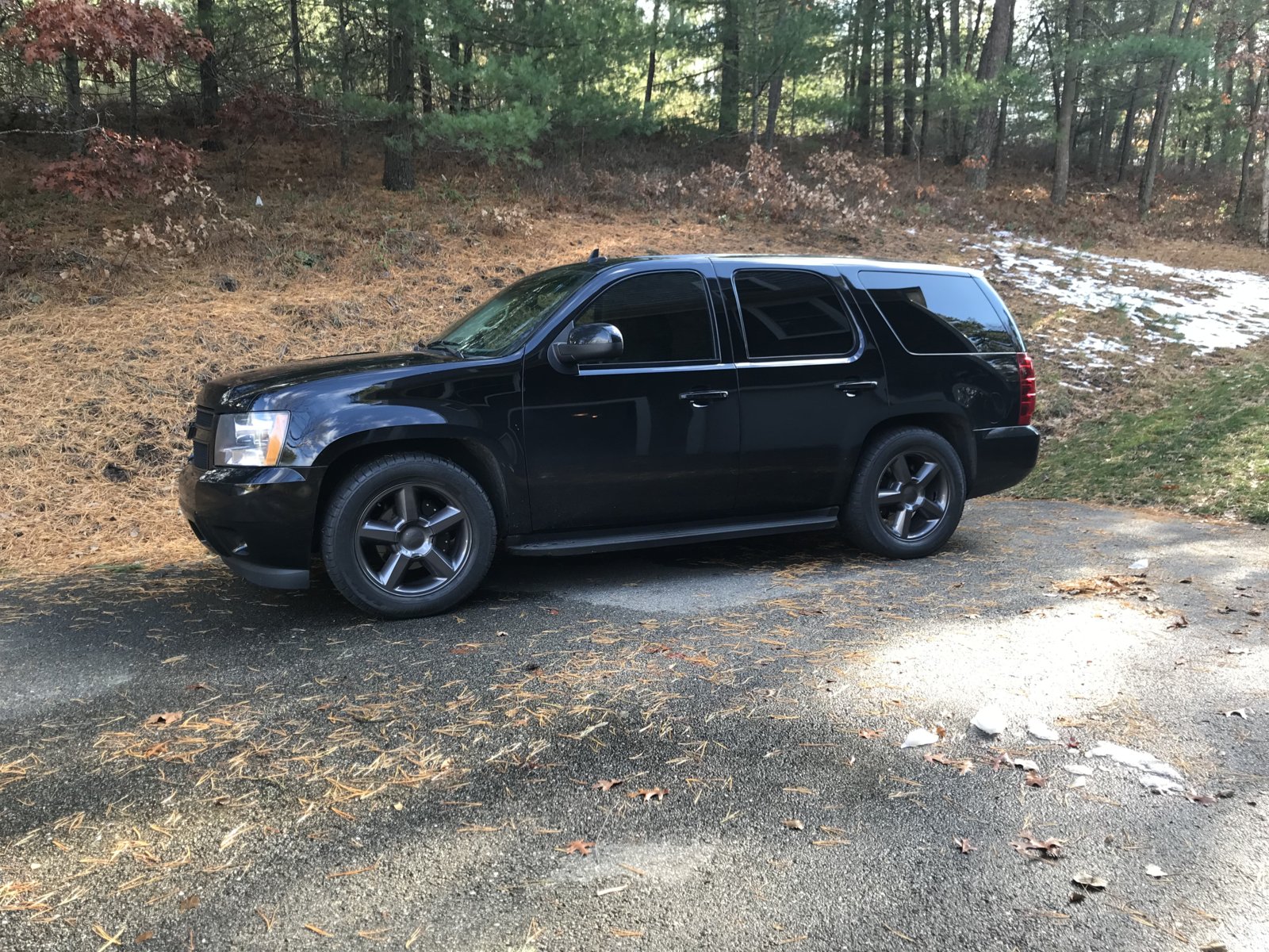

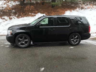

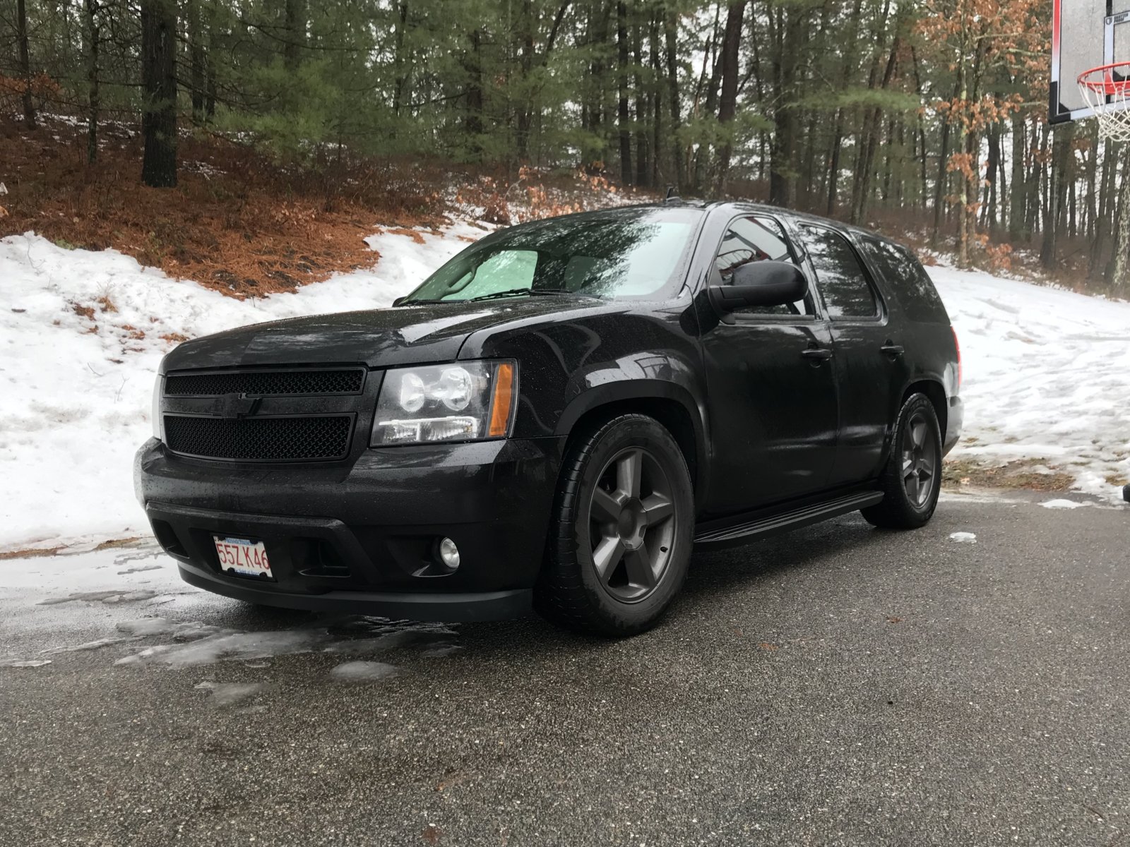

Hay guys I am in the process of lowering my 09 Tahoe again buy adding Belltech Drop Spindles 2511
To Belltech struts and pulling the spacer out of the rear so I am going from 2/3 to 3/4 at what point will I need to do trailing arms like DJM or Spohn I already have Spohn track bar and DJM sway bar end links and free travel mod Thanks pic is how it sits now
45,014
Looks slick with the black stocks!
4" rear is kinda iffy when it comes to needing the adjustable arms. What really matters is if the driveshaft still has enough slack in it when the suspension is bottomed out to not bind and be shoved up into the trans tailhousing. I think what usually drives people to get the arms is to push the axle back to center it in the wheel well because it moves forward the lower you go.
If it were me, I'd lower the jack with the rear coils out and shocks disconnected until the axle is bottomed out on the frame, then see if the driveshaft has any longitudinal play. The other reason for the adjustable arms is to set the pinion angle with such a drop. I think the stock geometry is pretty good at keeping the pinion angle within tolerances, but it doesn't hurt to be sure. Magnetic angle gauges are cheap and plenty useful elsewhere, so they're a good investment.

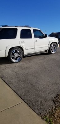

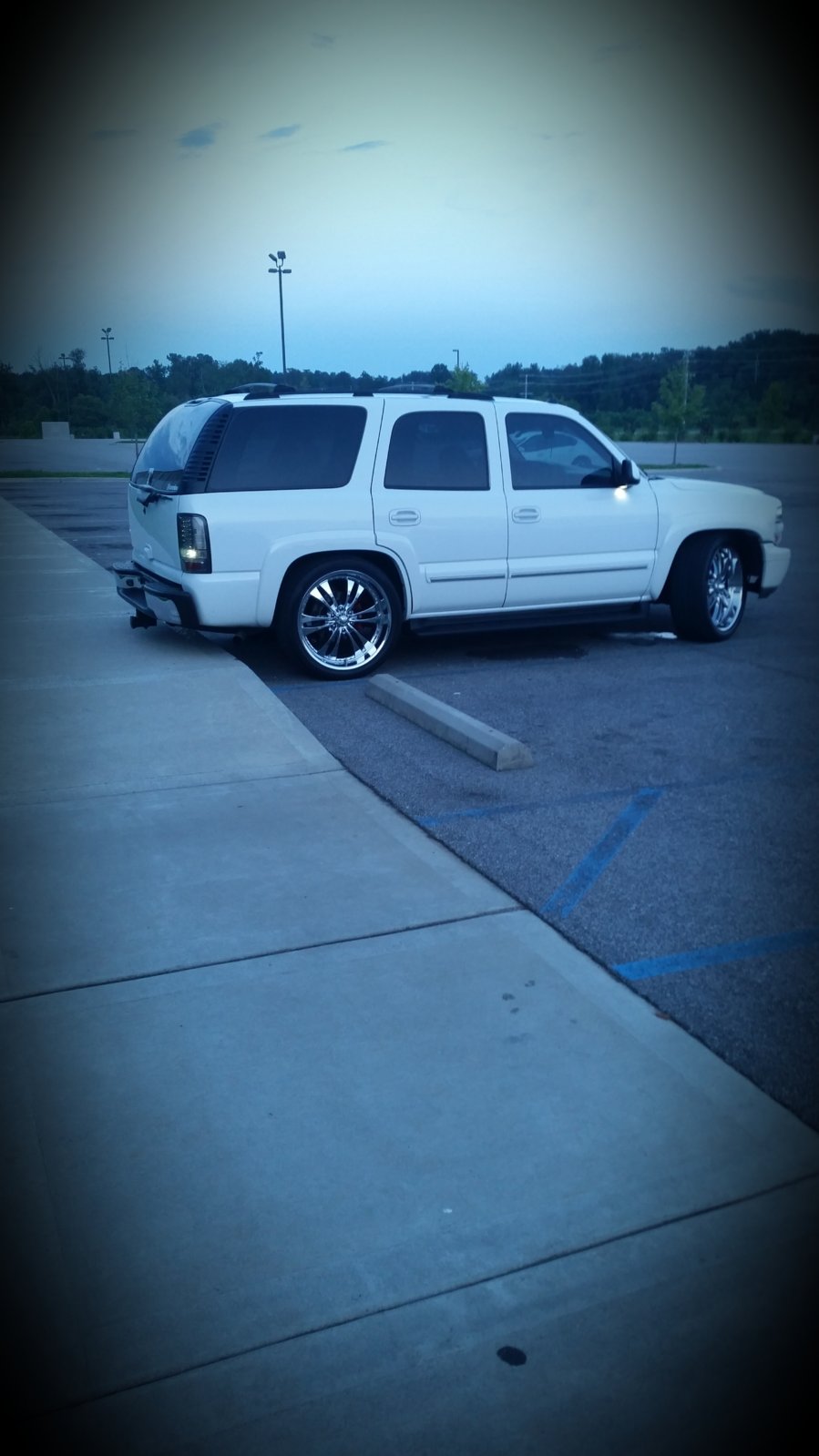

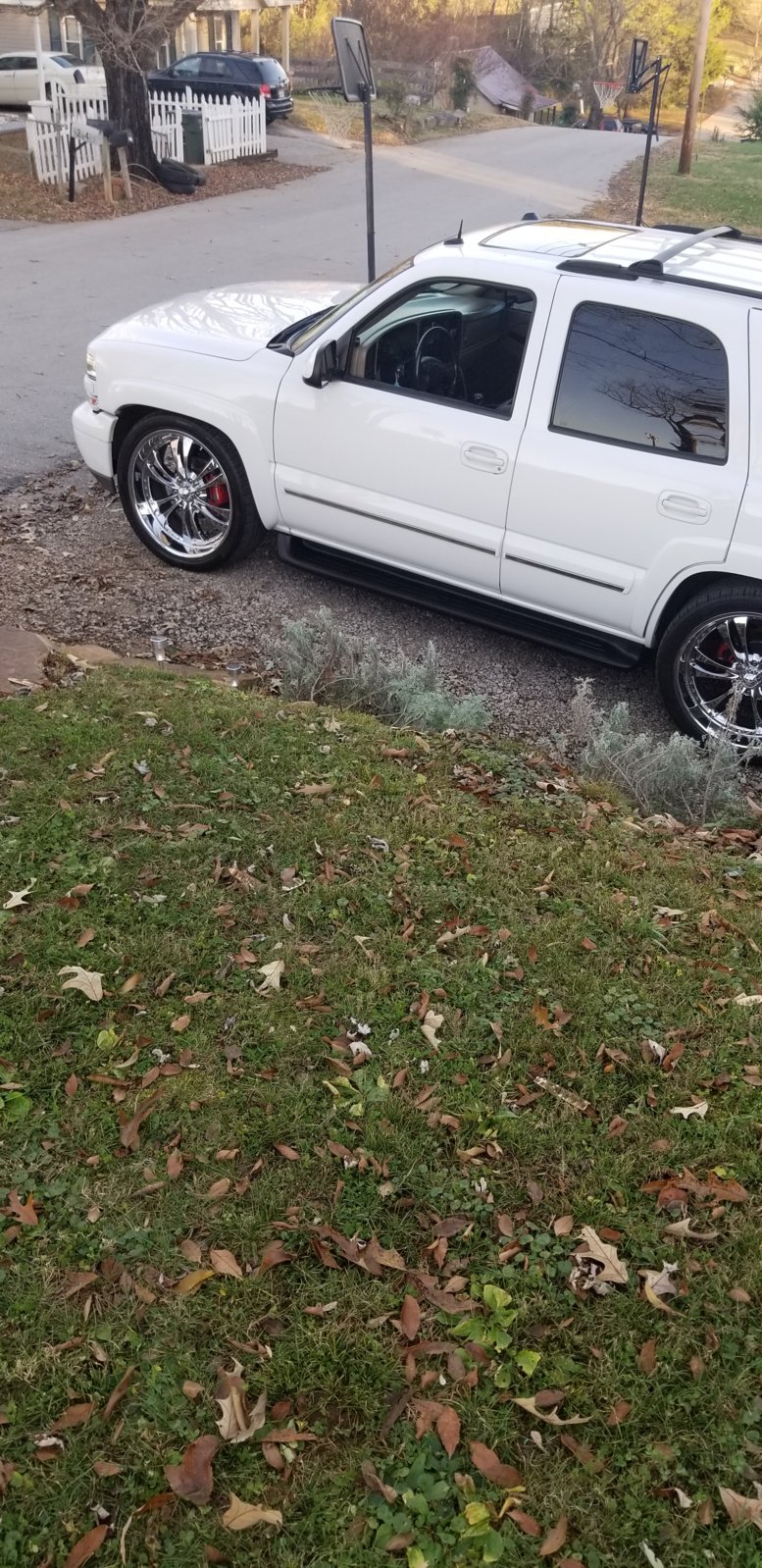

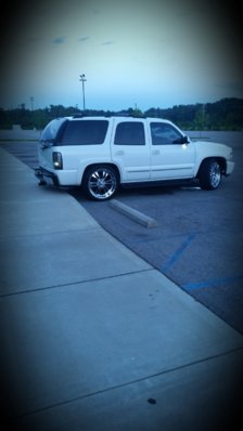

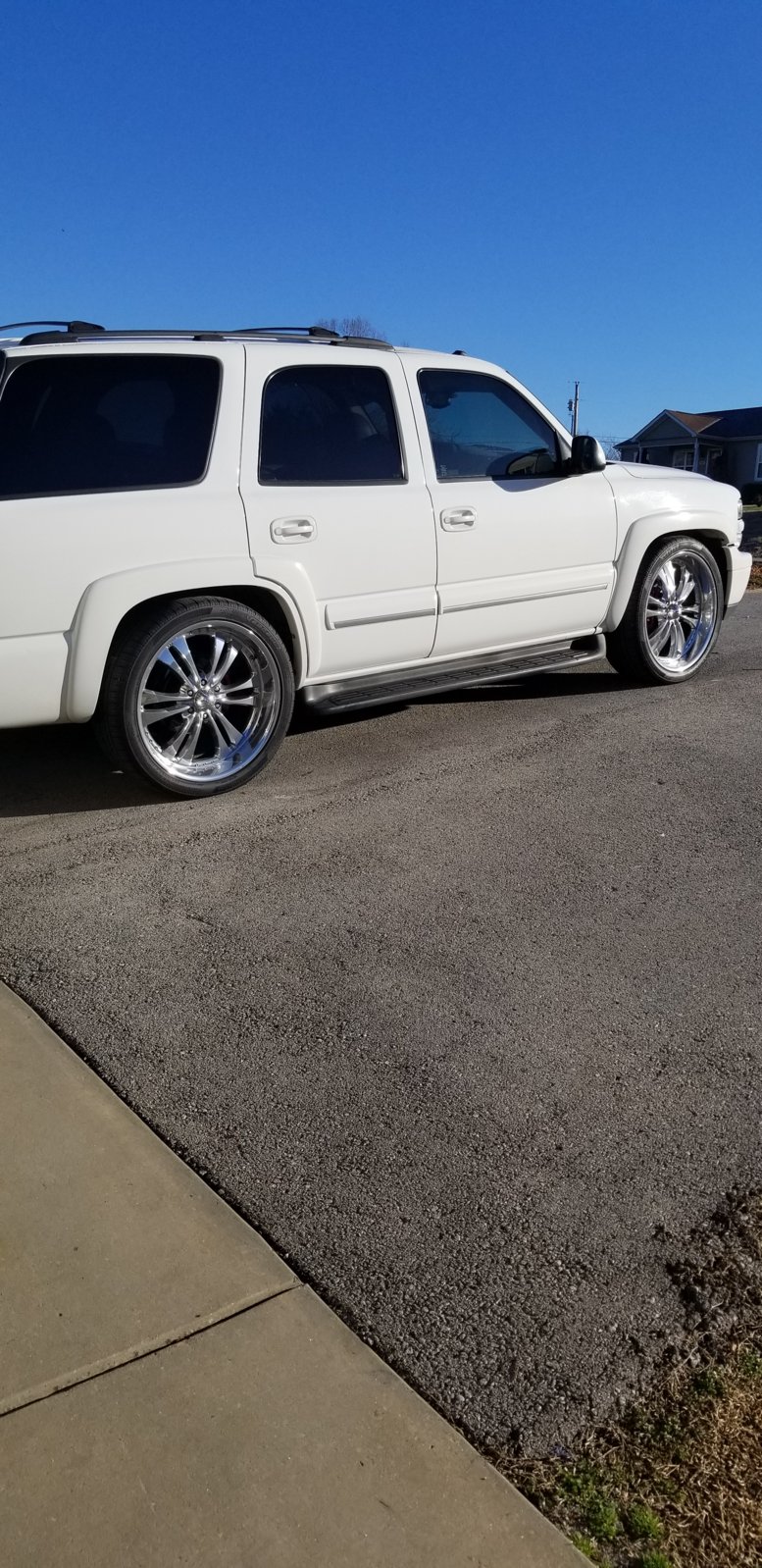

This is my 04 with a crown 3/4 drop with beltech nitro drop shocks riding on 24s. It dont ride to great so was going to put beltech spindles on the front with factory keys back in. The back do the djm trailing arm relocation kit with sway bar links help the ride in the back. I've already done the free travel mod.
45,014
They look good on my phone but show up weird on the thread how do I make them better
Taking the pic from the same ZIP code would be a start. And don't use IG filters like you're trying to hide the guys in the club photobombing it from the sides.
