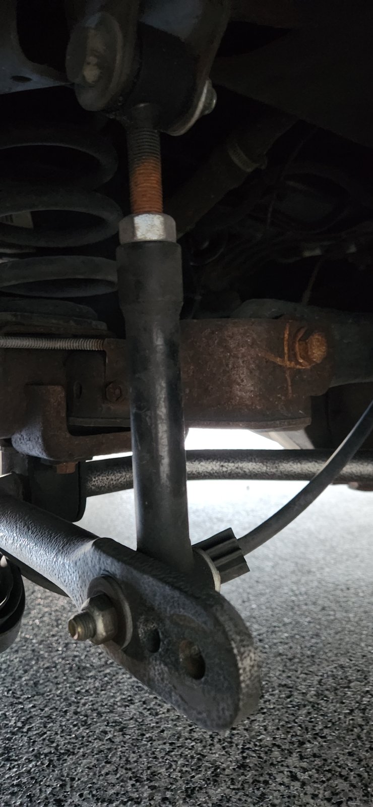

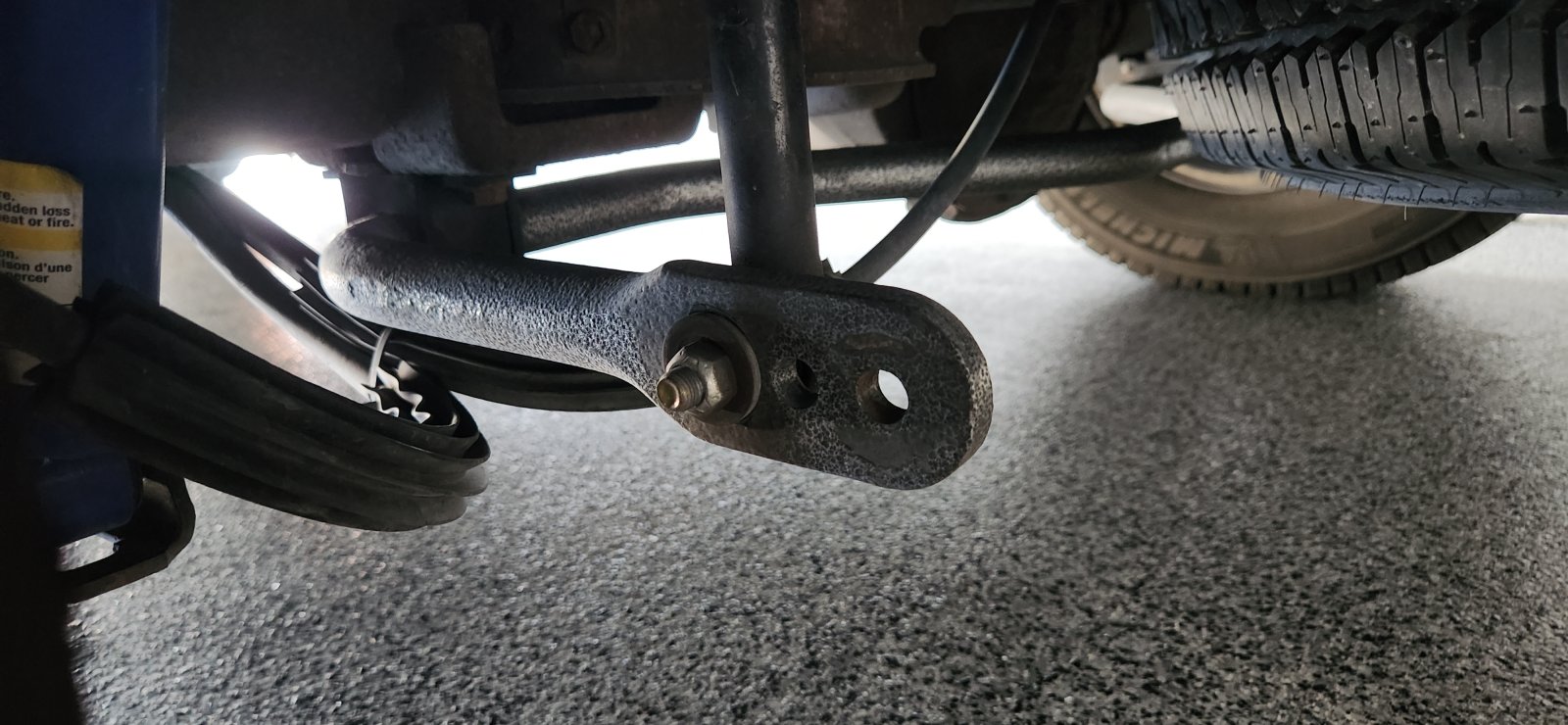

As per Hellwig’s installation, the rear bar should be level with the frame rail.
Hellwig’s rear bar has a ‘firmness’ option ( 3 holes )….. Just use the 1st firmest hole.
The improvement of sway is SO MUCH BETTER….. like a new truck… Your stock GM swaybar is JUNK…. It is a hollow tube, and very light in weight. The Hellwig is a solid chrome-molly solid bar, weighting about 40 lbs.
