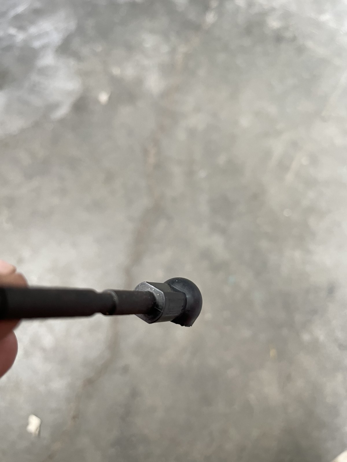

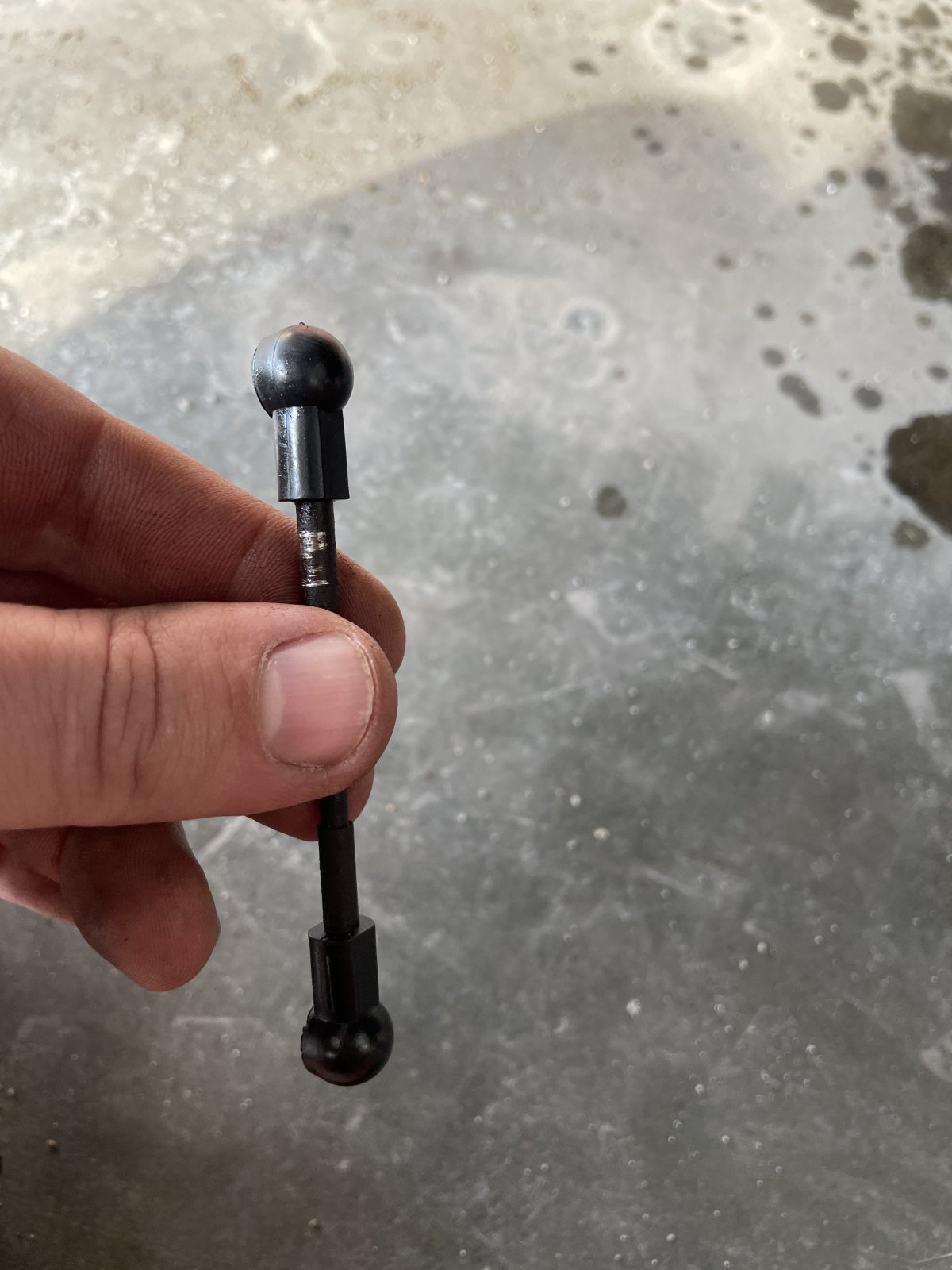

First thing I’m tackling is these autoride rods because if this isn’t successful then it’s a show stopper as I was to retain autoride on the rear. I’ve got the rod off but these plastic ends are corroded on. I’ve got some PB Plaster soaking on them to see if they loosen up. I’m afraid to go too hulk on them with vice grip or something because I don’t want to destroy these plastic ends.
Any tips and tricks from the peanut gallery?

Almost looks like they’re molded in or something

They will pull apart. Just takes a little effort.
