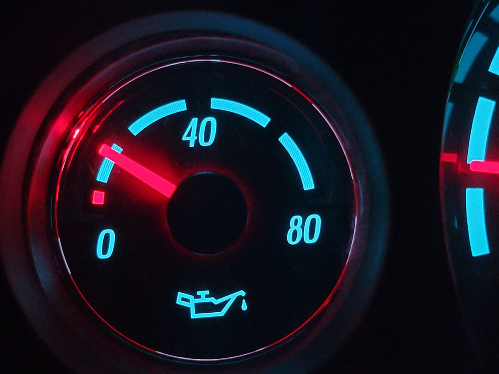

So when I did my oil change last week I used a larger wix XP filter per recommendations I've read online. I swapped the filter out today to the normal size filter wix 57060xp, and it brought my oil pressure up. It's now idling about 17-19psi.
As for the metal pieces we found in the oil pan my mechanic friend said there was copper in it. So we are assuming a bit of the cam bearing broke off. Here's a video of the oil pressure at idle also blipping the throttle.
I'm just going to leave it for now and drive it as is. I have great pressure on cold starts and cruising speeds. And the motor sounds and feels fine. I thank everyone for the input.
I replaced the oil pan gasket in the fall due to a leak and I saw some oil under there again so I'm assuming it's the rear main or the main plate gasket smh.

For me the video comes up as Private; can't view it.

19 PSI hot is just fine.... And then that does sound like the edge of a cam bearing. Just keep an eye on your oil pressure.
You will find different brands of filters flow differently. The more restrictive it is, the larger the drop in pressure up by the sending unit.
