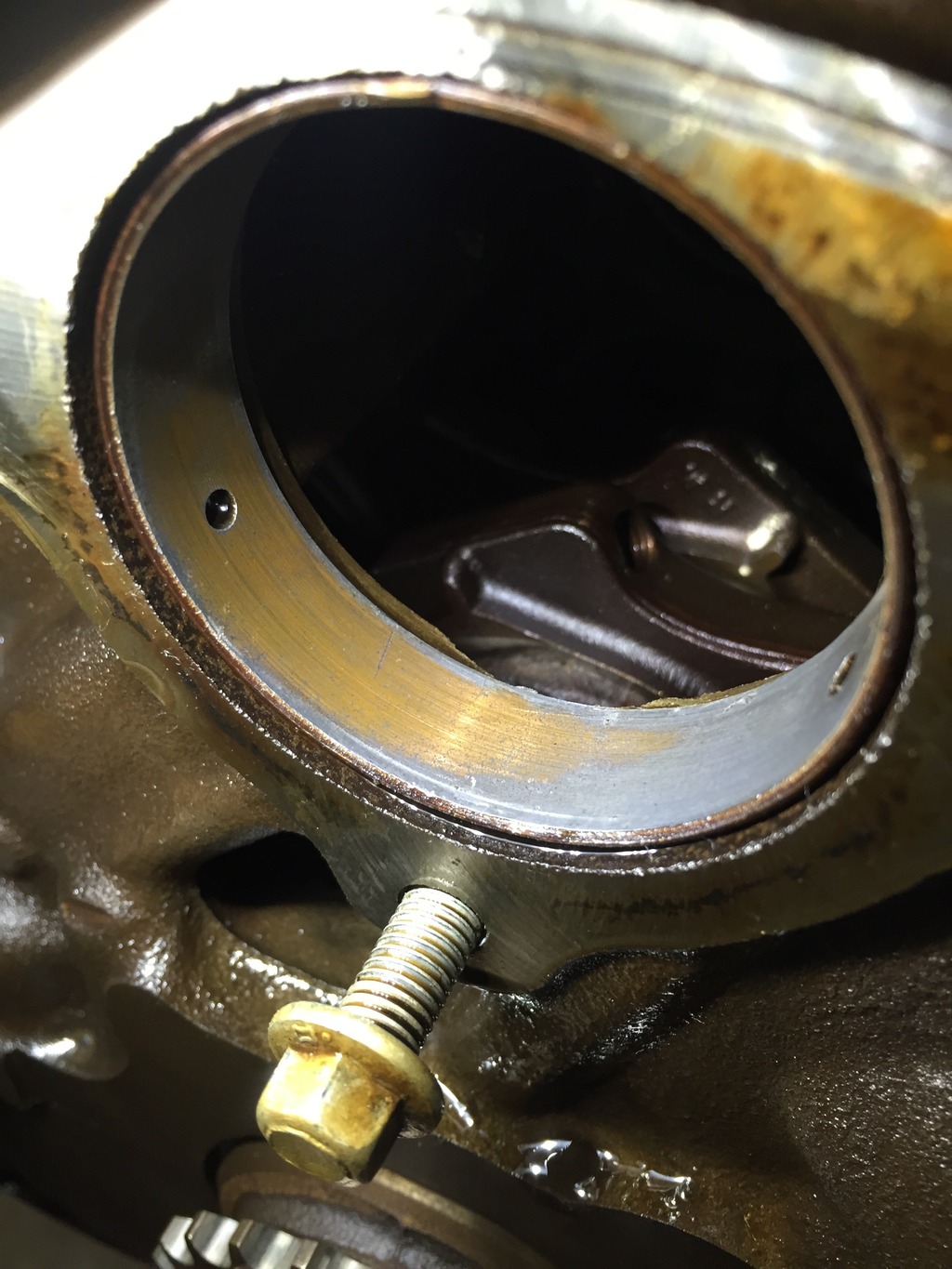

Cam bearings are either Aluminum or Babbitt material. Neither has copper in the mix. Mains and Rod bearings can have copper although most newer engines run a new aluminum high silicon mix with zero copper. The EPA has been pushing hard for companies to eliminate Copper Lead and Tin from engines, EPA says they are all toxic to the environment. I guess they think we will be feeding fish our engine bearings?

Uh....LS engine cam bearings do have a layer that's visible when the cam bearings wear out. Copper will show up on an oil analysis when the bearings get to that point.
The OP likely has a cam bearing that walked out of its bore and an edge broke off.
I've never seen the LS crankshaft or rod bearings with this layer.
