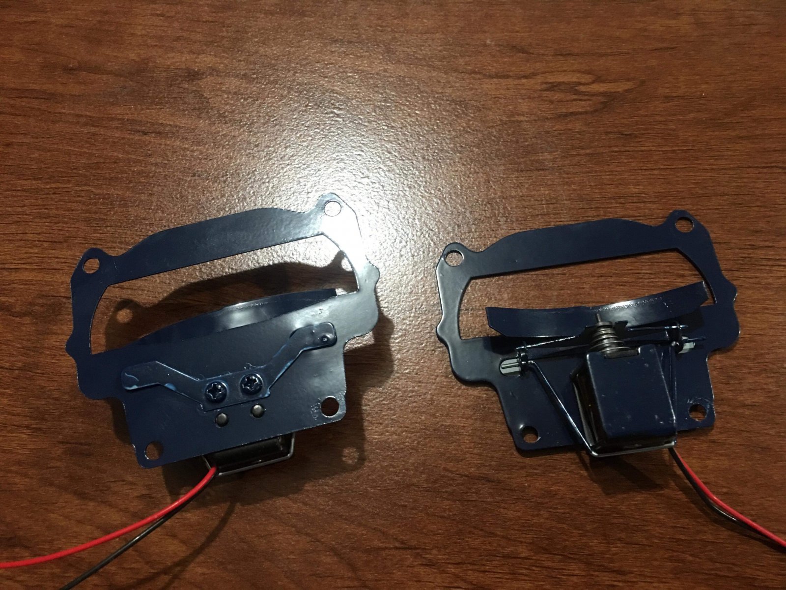

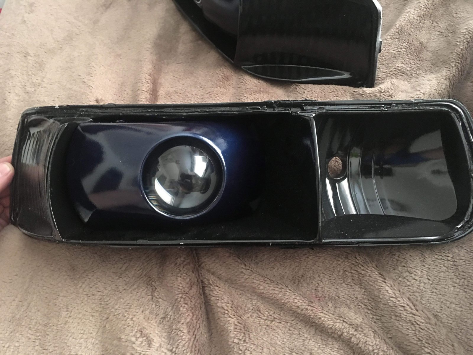

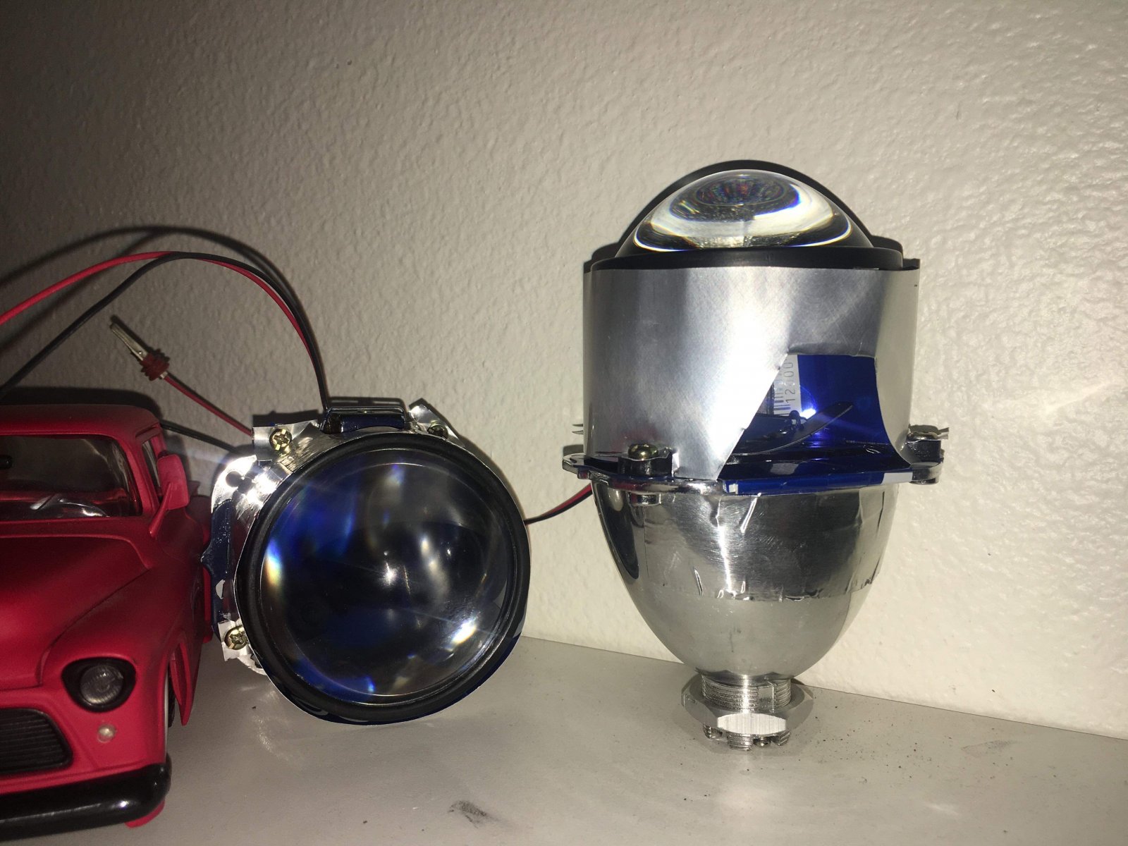

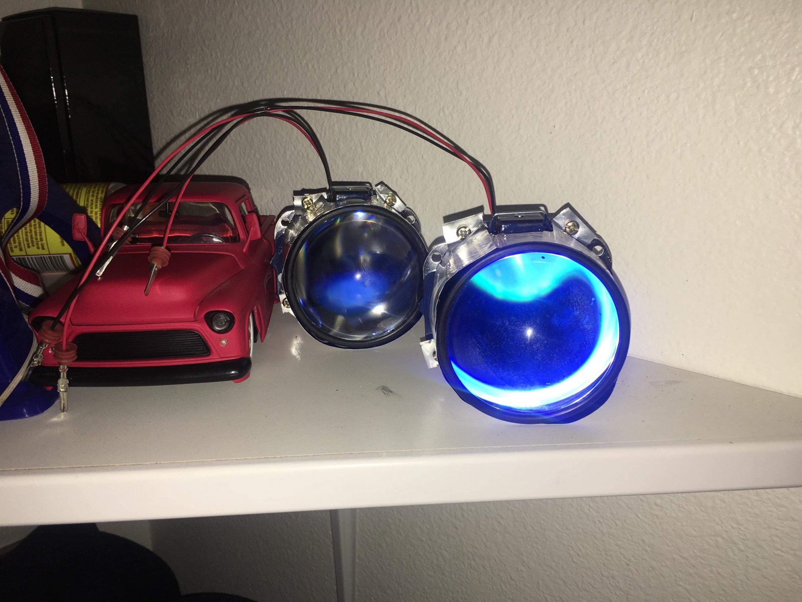

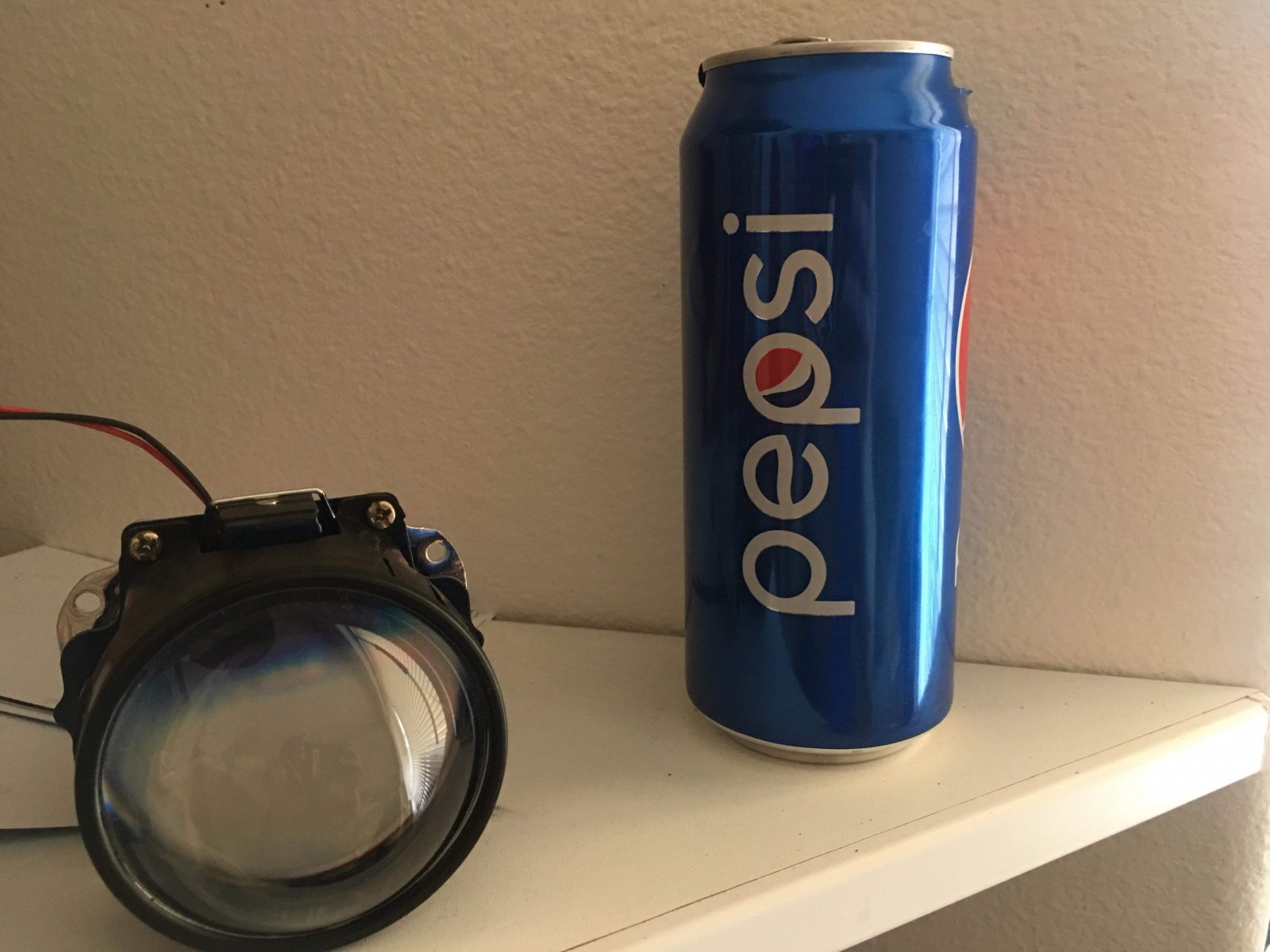

So I wanted passive blue demon eyes. It sorta works. Used a Pepsi can to get a super reflective blue for more blue appearance. Not sure if it works yet. Painted the bixenon cutoff shield blue. I think this dark blue was a bad choice and should went with red or white like I showed in my previous post on page 85 awhile back but oh well , maybe next set .

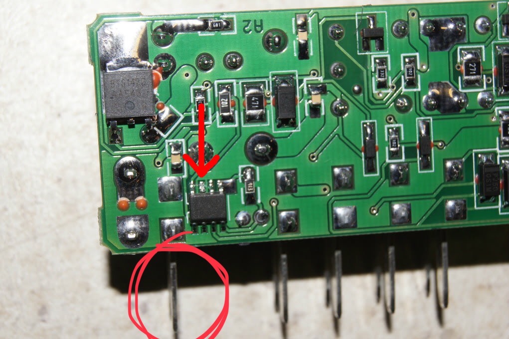

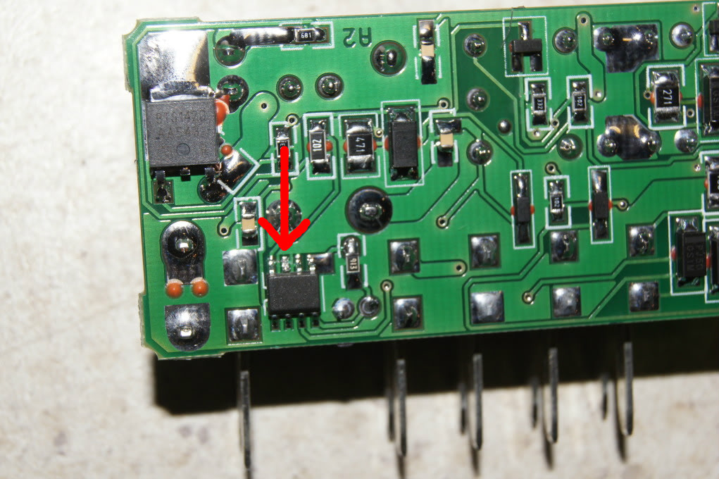

It’s just the one leg with the arrow pointing to it that gets clipped not the whole thing
Understood. What about the resistors wired for leds? Do they need to come off? Or can they just stay on without issues? Will regular bulbs work correctly still, with that leg snipped?
Sam Harris
Sep 26, 2018
7,445
14,977
Texas
Know which one?
Leg #7. Same as in the first picture as well. I suspect this leg provides the hyper-flash when resistance is lower than it’s supposed to be. So clipping it should only affect that function. (Guess..)

Here's my question: If you install resistors and an led bulb fails, does it hyperflash? I kinda like a function that alerts me to a problem.
52,954
Wholeheartedly agree. Can't believe this isn't in the "database" already.
No. You’ve eliminated the alert by using the resistor, and the led has basically no resistance so it doesn’t make a difference when it goes out.

Yup. On your own to continually verify all bulbs are in working order. Any LEDs installed in turns will eliminate the alert functionality.
