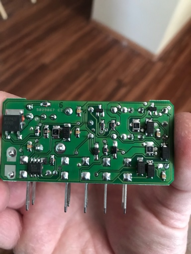

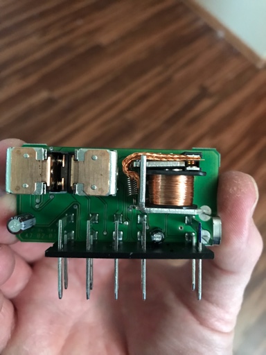

My original flasher:
guess that’s not gonna work for me.

Yours a 00-02 or 03-06?
03. I may have the same IC on board though... not sure if they’re the same or not. My eyes are too old now to read that shit without a magnifying glass. [emoji1787]

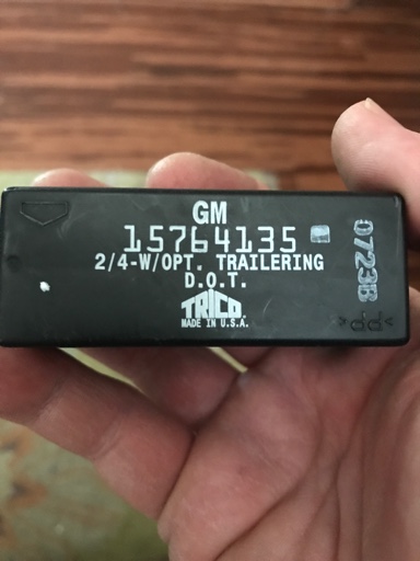

damn it, i bought my novita flasher for my 01 from autozone. could have saved $12 with this tiny mod.

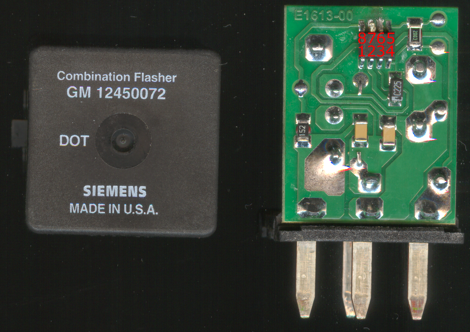

Ok. So the “ear clip” of connection #7 must be for the 00-02’s.? I suspect the same would work on the 03-06, if you get the correct leg..
eand28
May 6, 2017
250
283
Pennsylvania
Guess it works on both. Had a brain fart and forgot which one was which. Meant to post the 03-07 flasher pic
