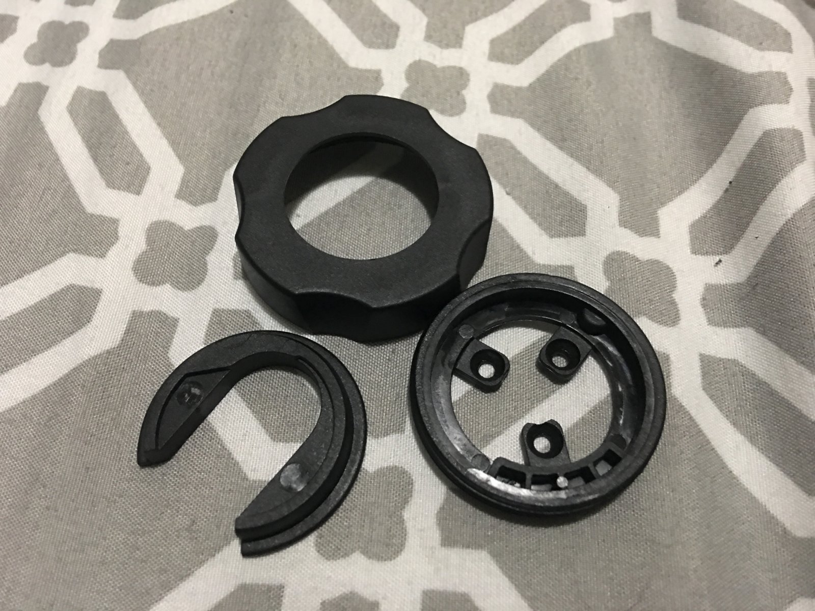

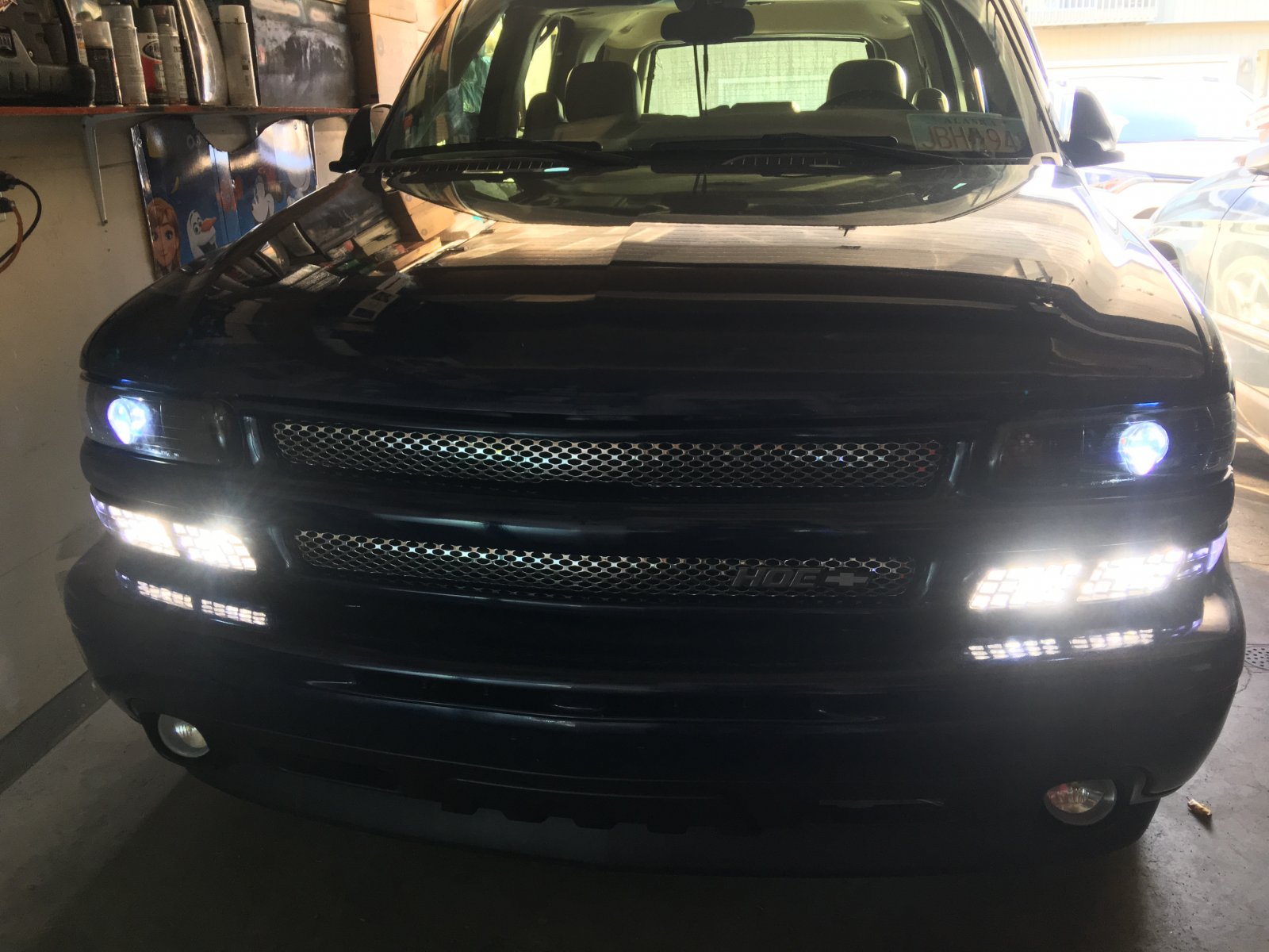

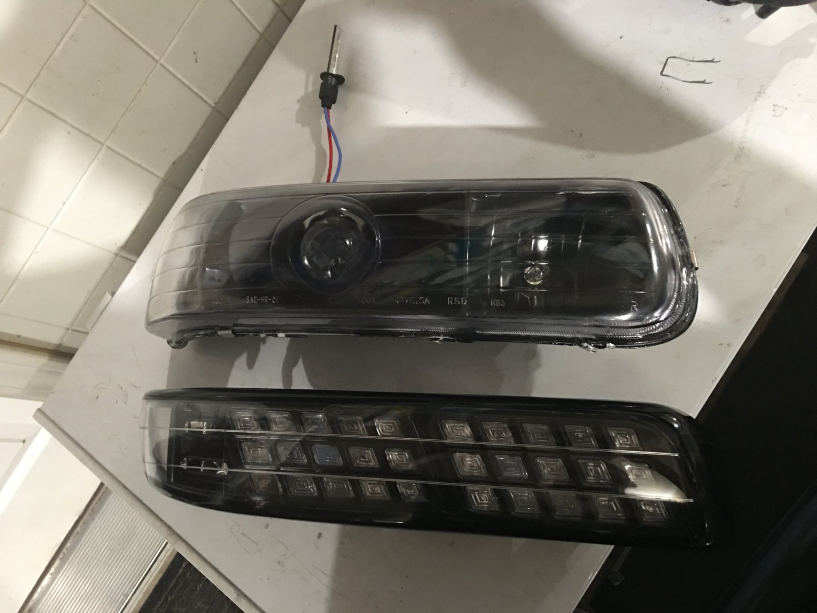

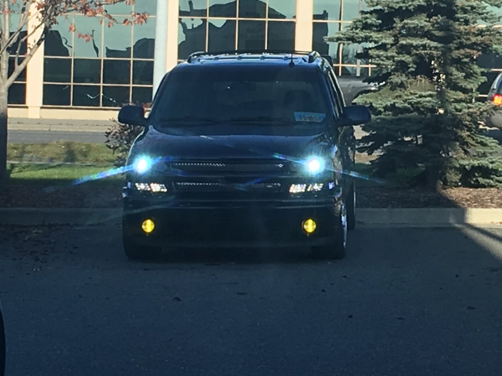

Got the H1 motoholders in the mail and upgraded to 55w hids. After doing some research I found out that 55w hids are risky in these housings with the H1 projector (burns bowls, melts housing lenses) so I’ll stick with it’s my 35w kit which is fine. Ready for install.

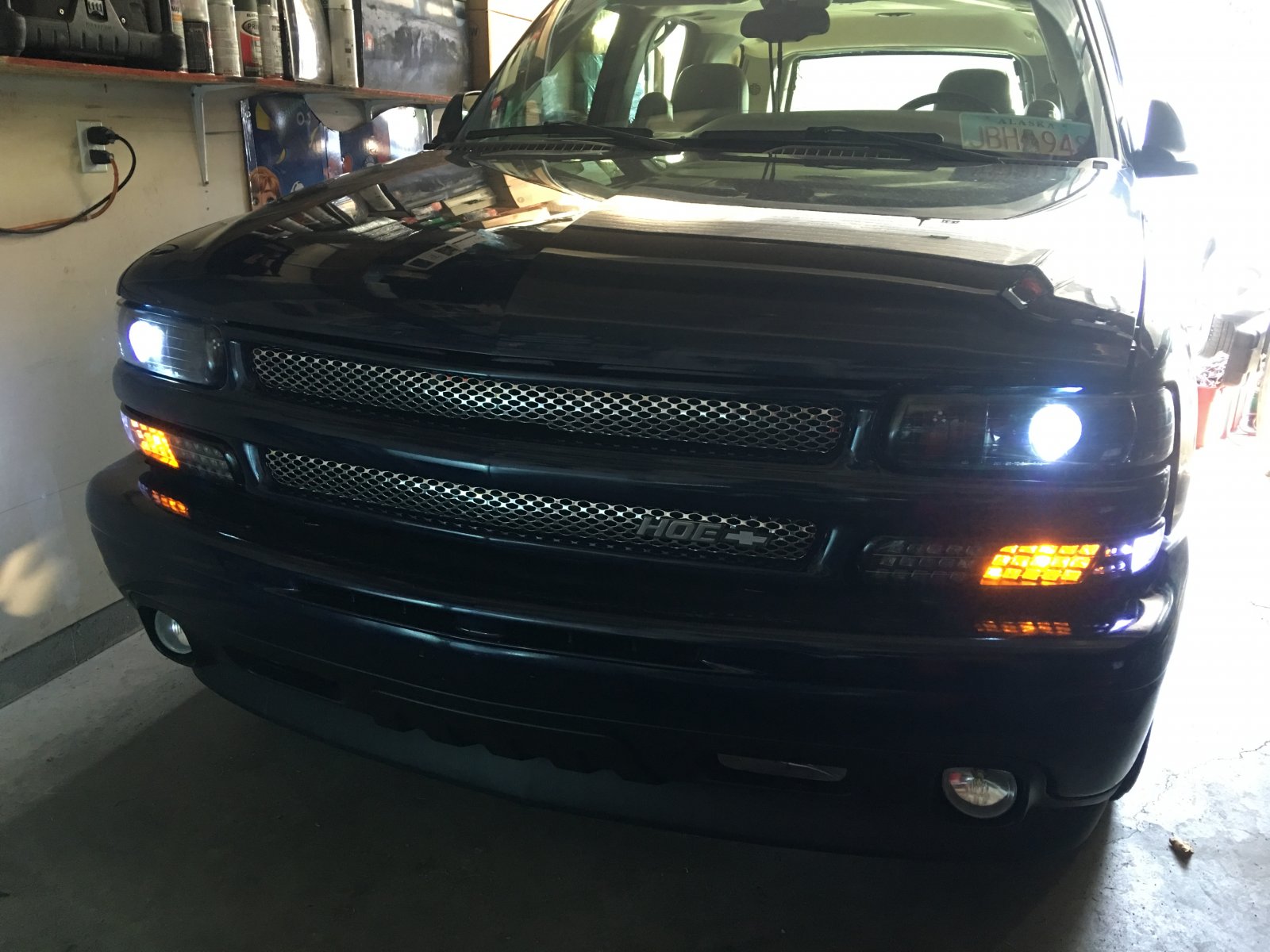

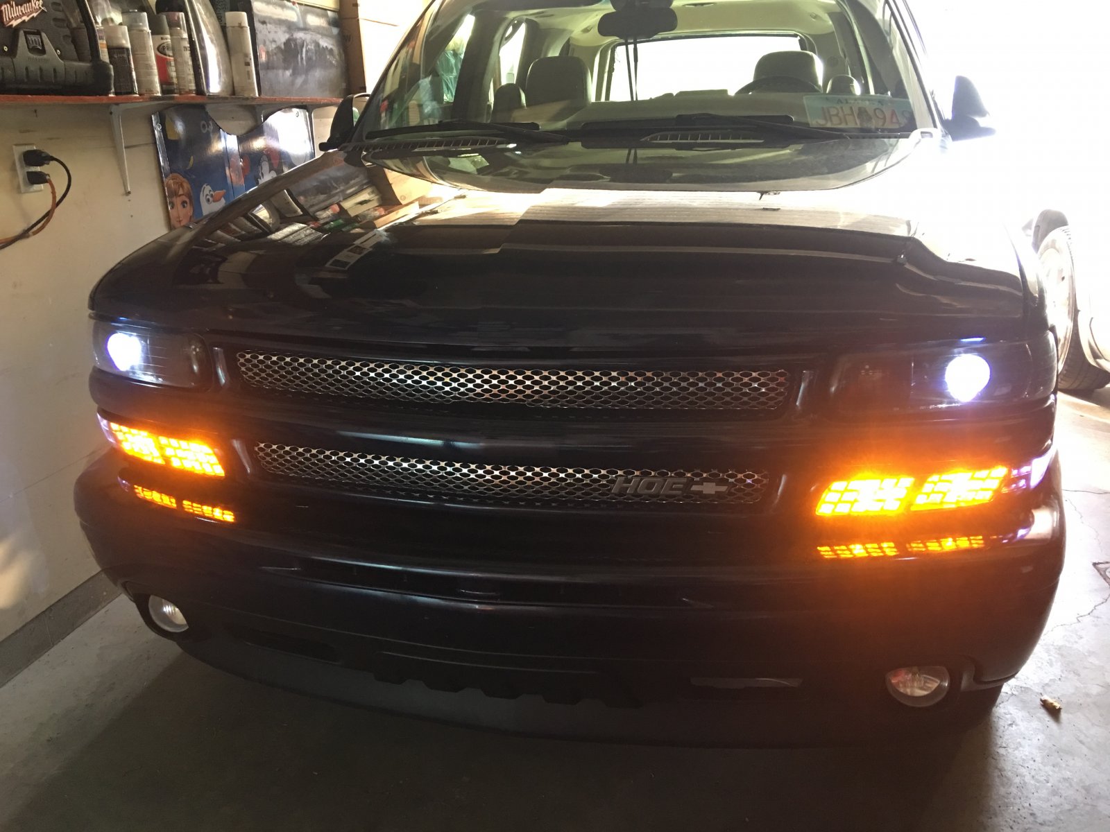

Love the grill. Those turn signals are quite sharp too actually.
Thank you. The turns for sure came out looking better than I expected. I’ve never seen another set like these so it was hard to imagine the end product

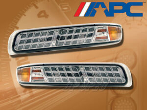

@05Single fronr lights look good! I really like the corner light housings! They look great! Wish they made them in Denali corners haha.
Edit: what brand are the turn signal housings?
I actually have no idea who maked the corner lights , I think apc . As always I just wanted something different

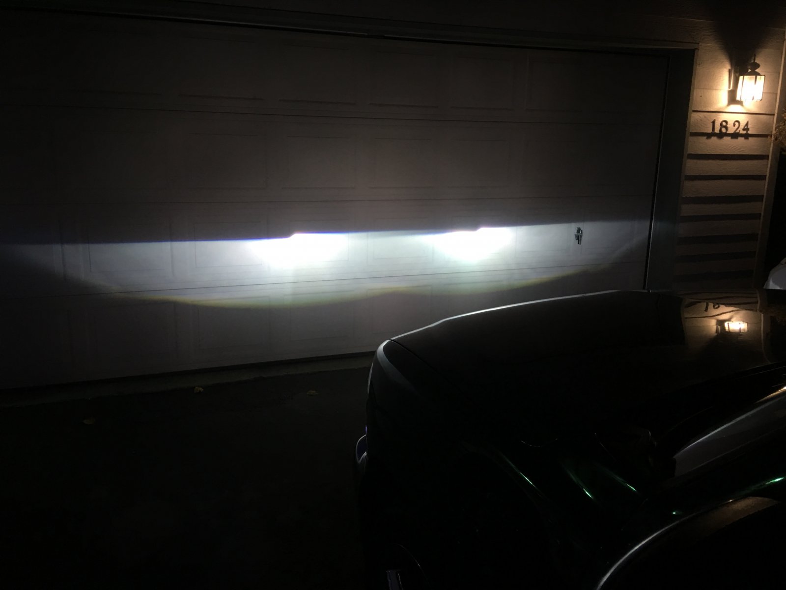

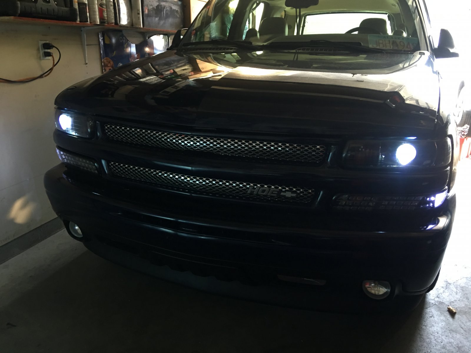

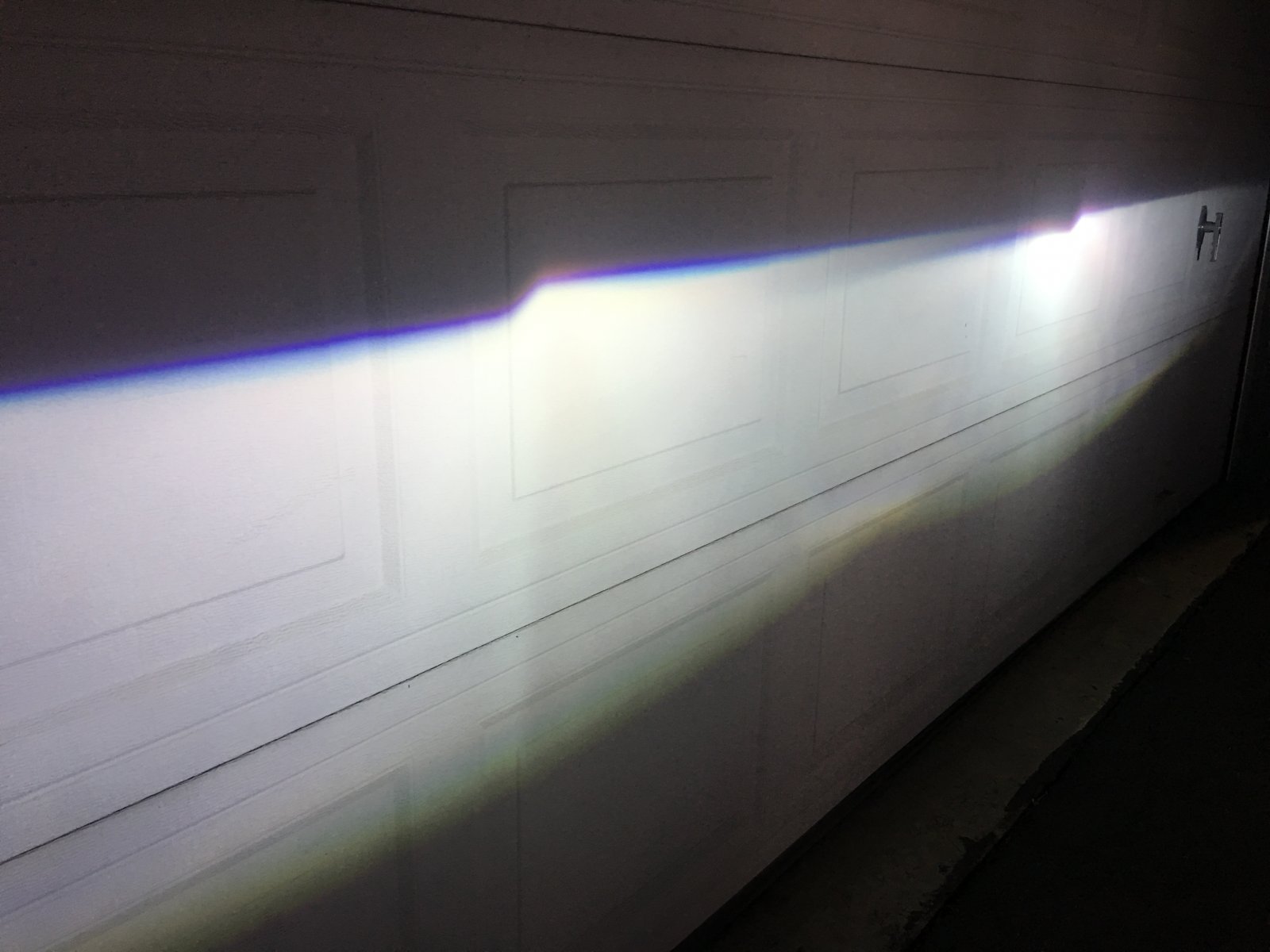

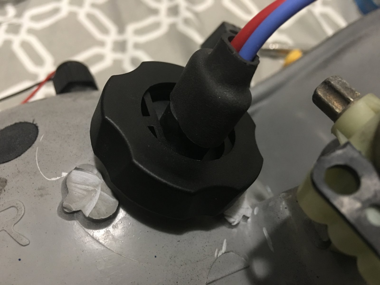

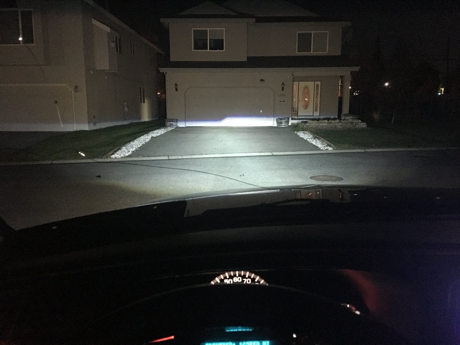

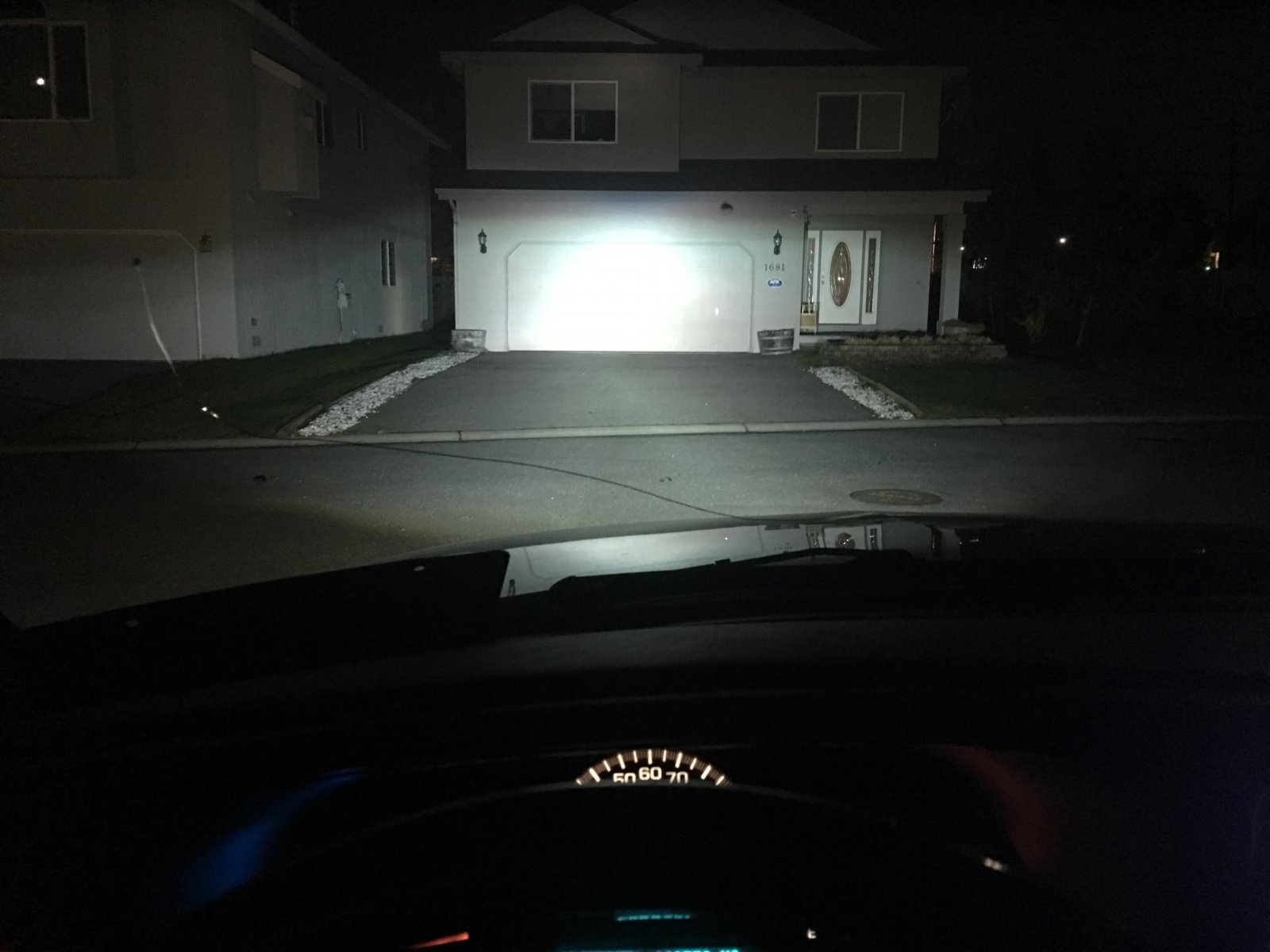

Btw I got the morimoto Motoho1ders. They helped a ton with centering the bulb. Just confuses me that why wouldn’t they have a cure for this already built into a finished H1 projector. Why sell something if it’s not going to be the best. Whatever, extra $20 ain’t much to get 100% out of your lights. Because I did mock up these lights without the holders and the alignment was visibly off.
Sitting at Starbucks with high beams plus 6HI mod :drool:
52,954
Btw I got the morimoto Motoho1ders. They helped a ton with centering the bulb. Just confuses me that why wouldn’t they have a cure for this already built into a finished H1 projector. Why sell something if it’s not going to be the best. Whatever, extra $20 ain’t much to get 100% out of your lights. Because I did mock up these lights without the holders and the alignment was visibly off. View attachment 232486 View attachment 232487
I used those on both my retrofits, seemed to work good. Just an inexpensive upgrade I guess.
