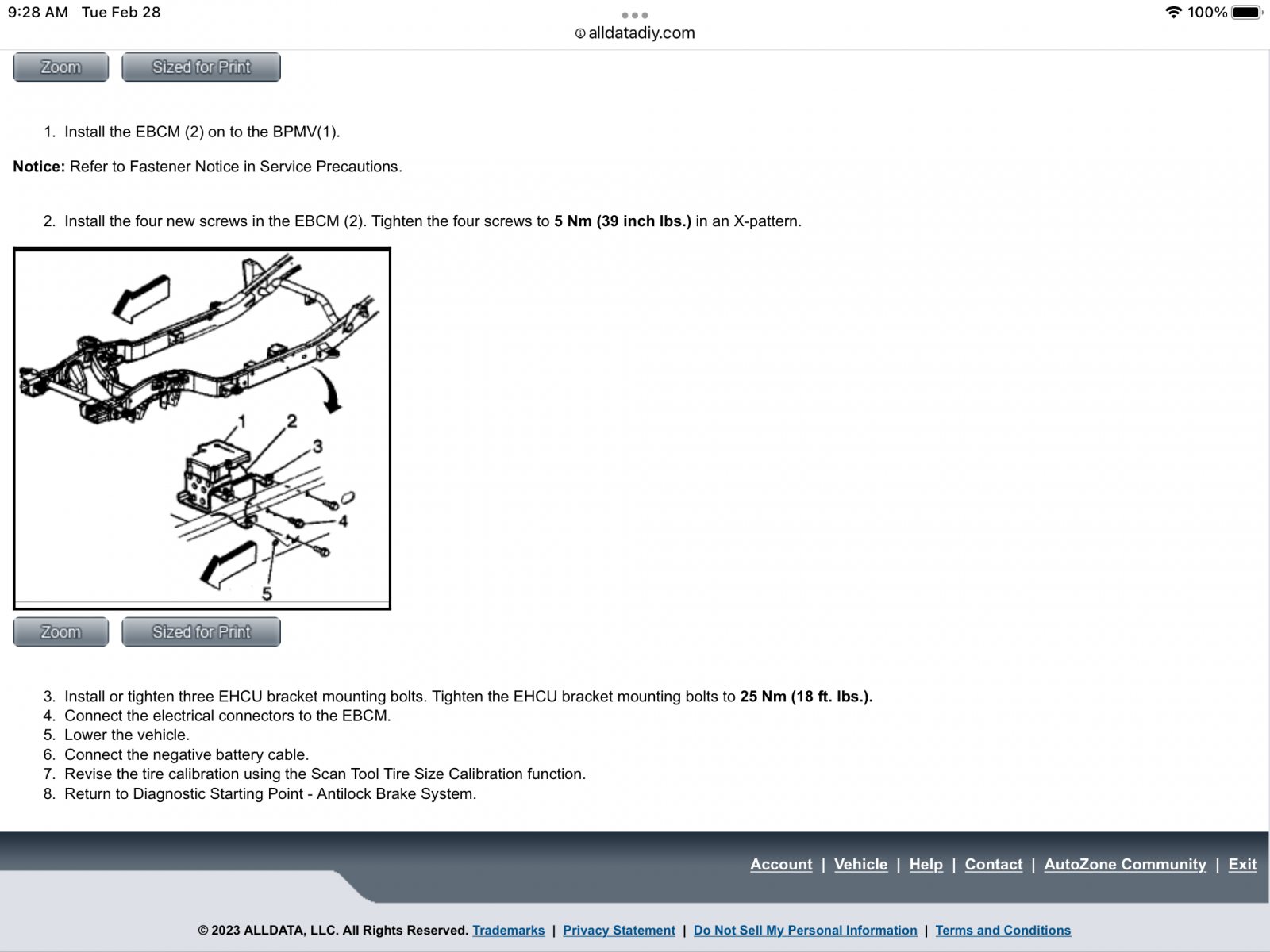

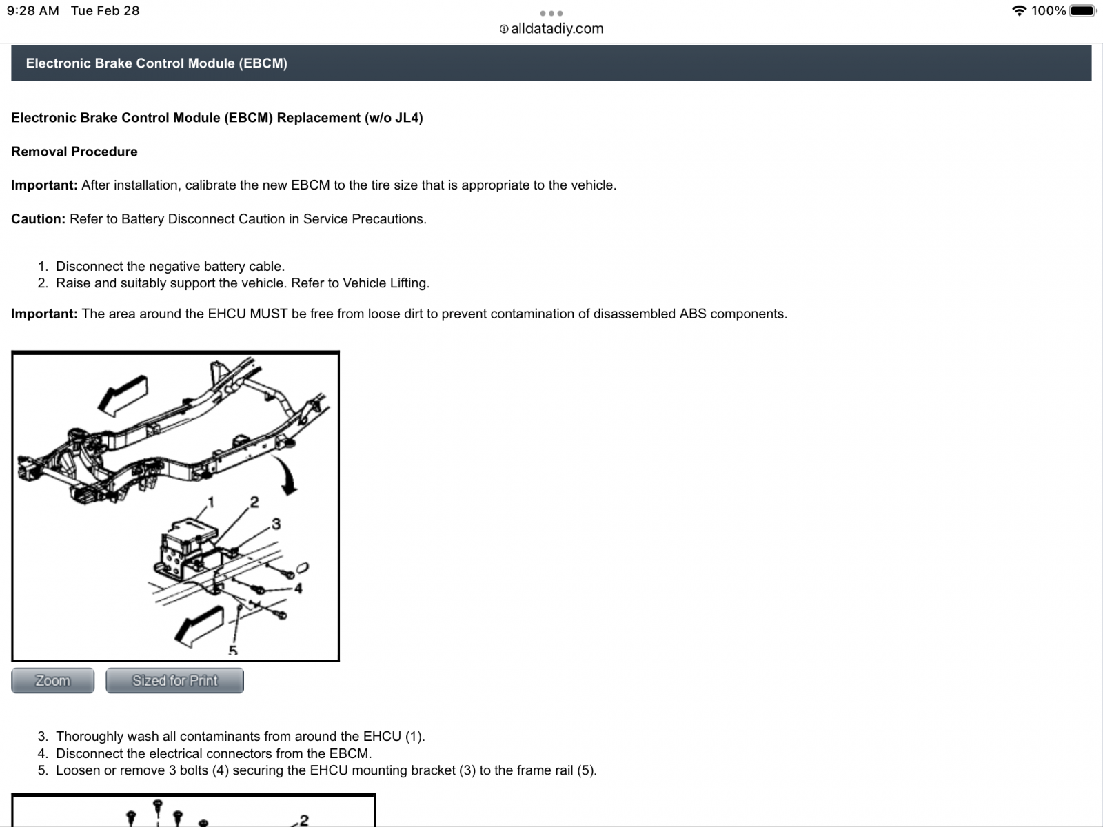

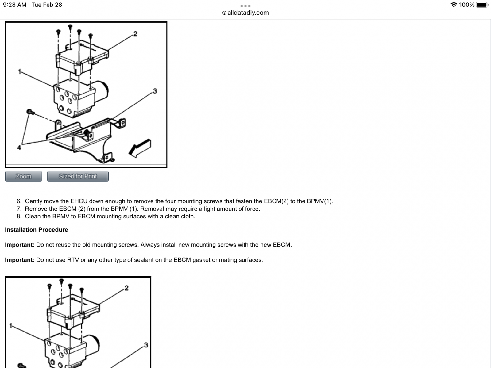

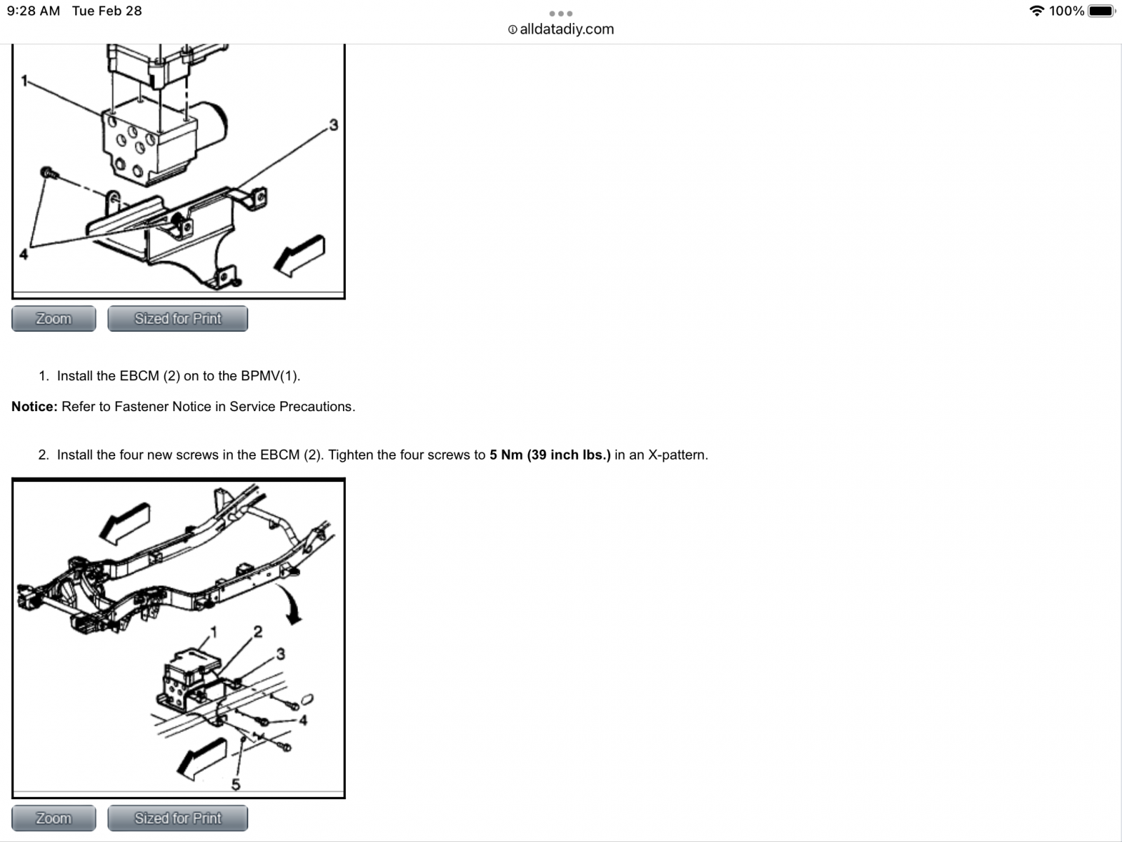

52,954
You don’t need to worry about the fluid- replacing the EBCM won’t let the brake fluid leak. Here’s 4 screenshots from my alldatadiy for my 02 which will be the same procedure. This shows “ without JL4” which is the RPO code for traction control but I looked and the instructions are the same for both types.

Why? Just follow the service manual procedure which is outlined in the steps I posted in those screenshots. You just need to lower it enough to get to the EBCM screws unless I’m missing something? There should be enough flexibility to access the screws.
