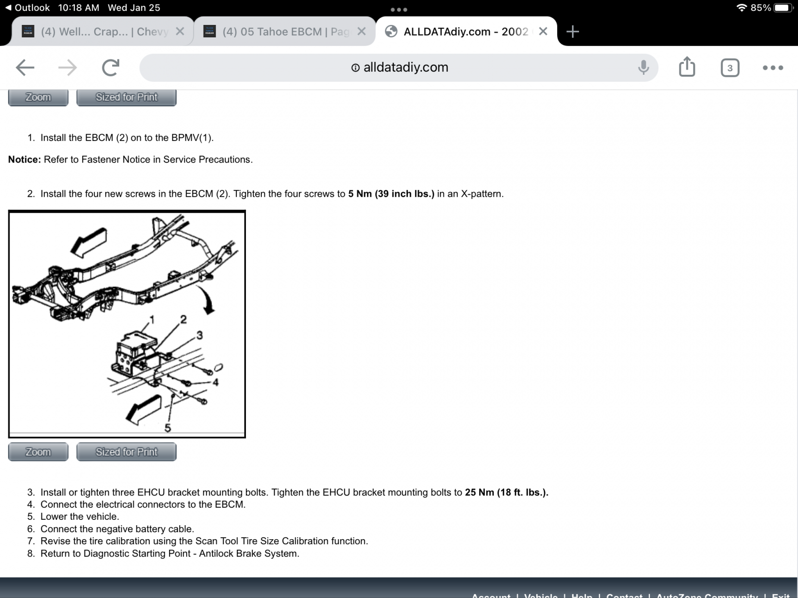

Where did you see this? Alldatadiy FSM doesn’t state this for my 02. It does say to use the scan tool tire size calibration but that’s not tied to the VIN and I’m not sure it’s needed. I haven’t replaced one of these on these trucks but I have on a couple other vehicles and no programming was needed.
Edit: is that the part where it says “return to ABS diagnostics”?
10,520
15,263
