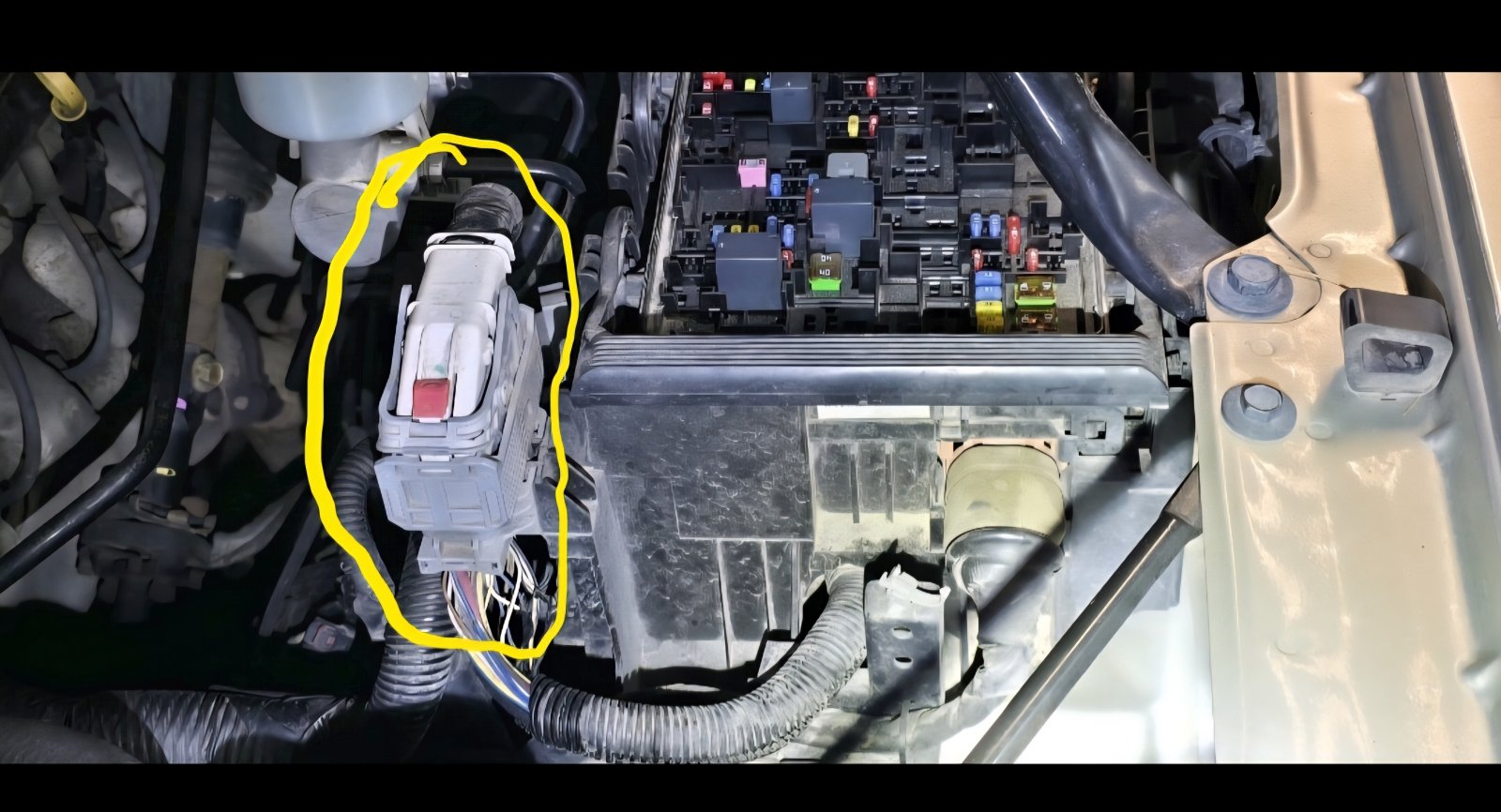

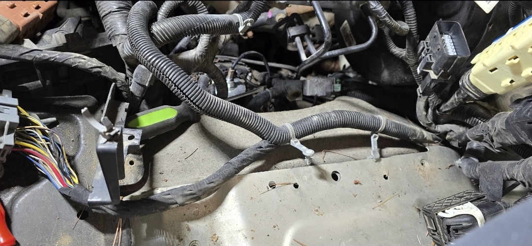

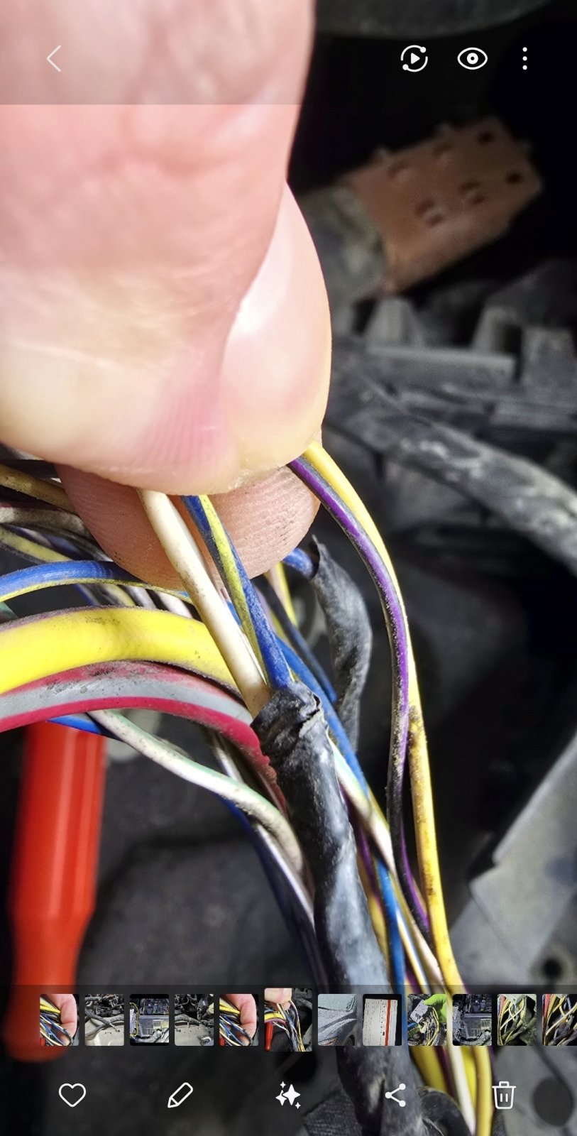

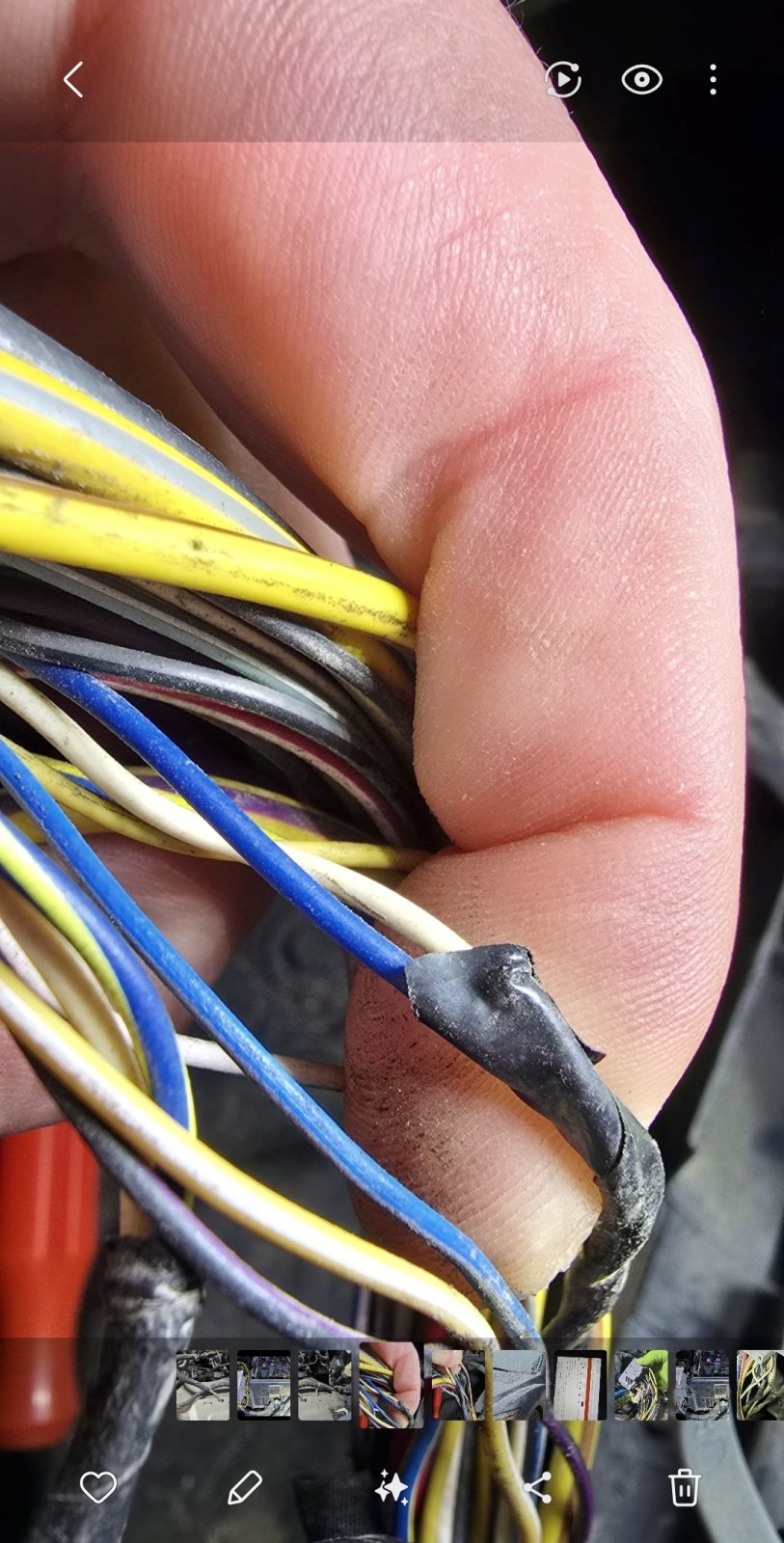

After some quick research, I found myself under the hood looking at the fuse block and associated wiring. I discovered a connector that looked "off". Upon further inspection, it looks as though 4 wires in this bundle seem to have been repaired at some point as this does not look factory. Two separate sets of wires taped together? For now i removed the fuse block and thinking at a minimum, need to trace these wires back to where the tape stops, but any other ideas? Where does this wire bundle go to? I see it goes through the firewall, and i think it goes through the driver sill plate and to the back to various systems.
Any help is appreciated!

I had some issues on my 07 that lead me to the driver sill plate where I found some wires chafing. You might also want to check the grounds. This many codes sounds a lot like grounding issues.
